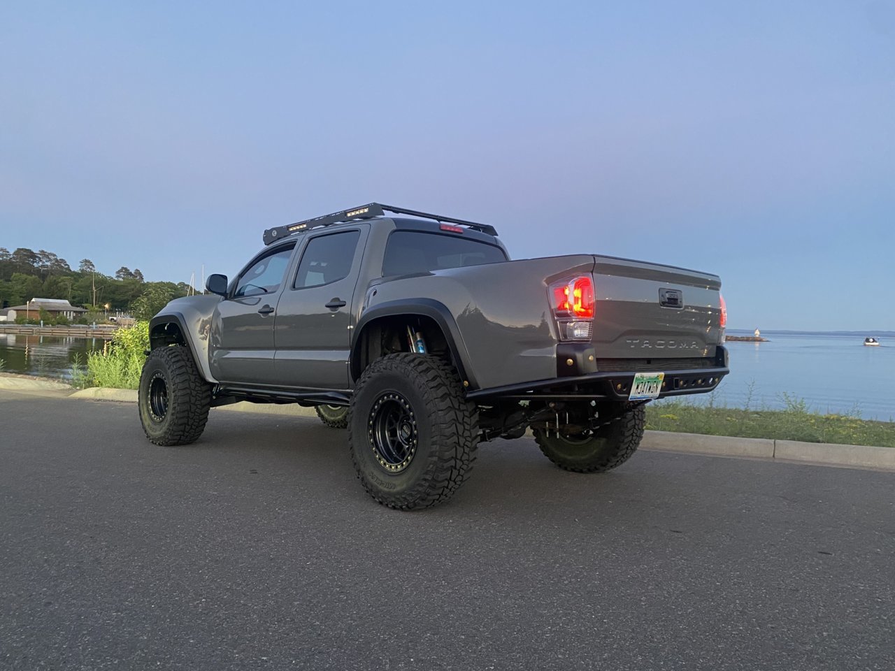

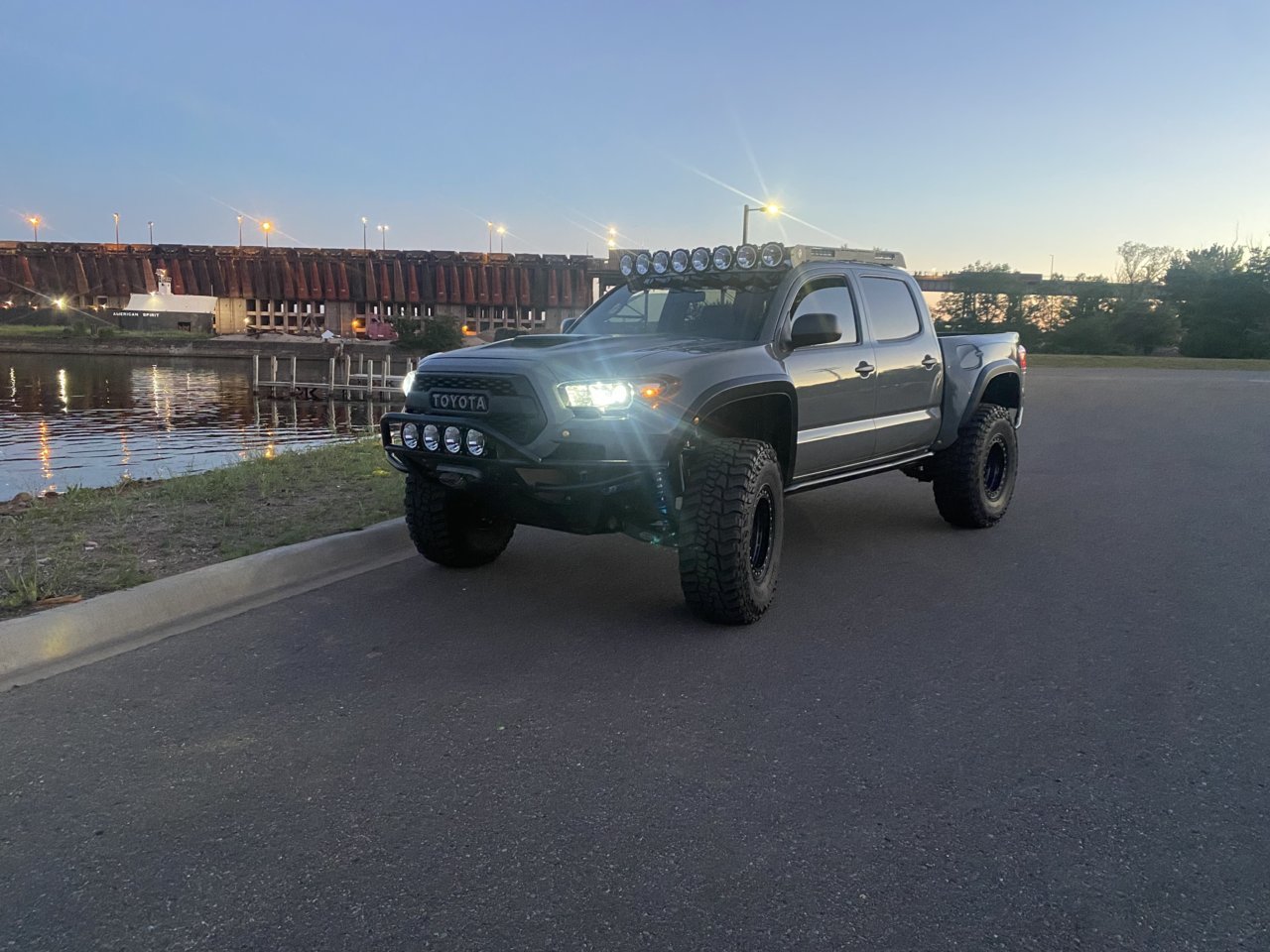

    I’m so fucking in love with this thing. I can’t get over the ride and handling. She’s officially what I will call ready for dirt.

    Time to update the profile pic! And get some proper glam shots out in the dirt
    906taco[QUOTED] likes this.

    Awesome work, found myself just staring at the pics for too long.

    It’s the only think I could pick apart on your truck because otherwise the thing is PERFECT.
    Honestly I’m kinda sad that the build is over because I loved getting the daily text updates of the project.

    Thank you! I look over my shoulder about 10 times every time I walk away from it. She’s easy to look at.
    I really appreciate that, it means lots coming from you!

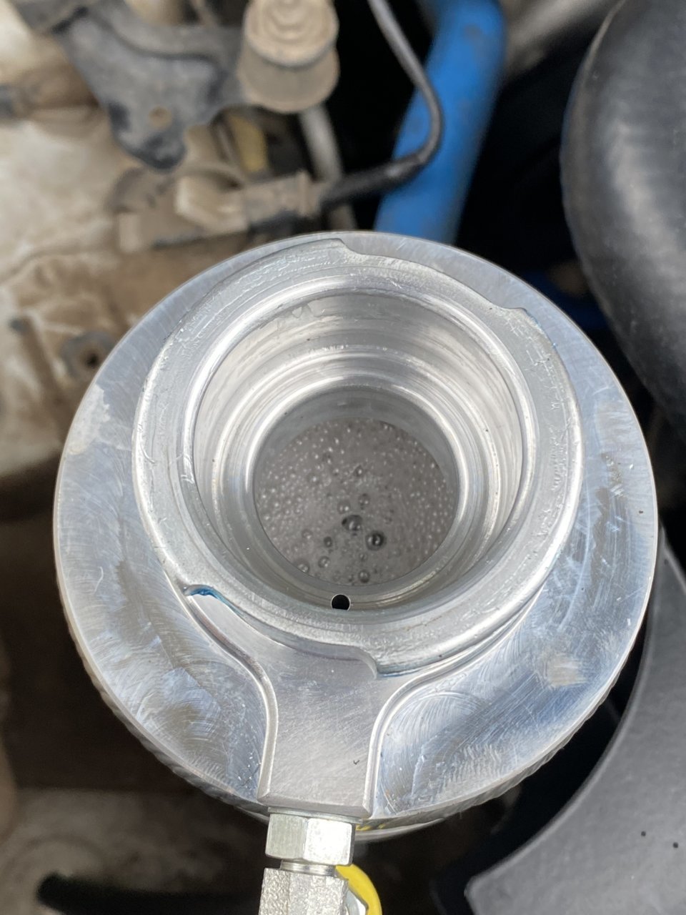

    Mmmmm, howe bubble party. I thought I had it thoroughly bled it but after a few minutes of driving the pump develops a whine and I found this in the reservoir. Gonna double check all fittings and bleed again before I fuck up this pump.
    edit: found that each end of the high pressure is seeping a little. I’ll pull the truck in the garage tomorrow and troubleshoot it more.

    That’s more than I was getting. Probably got a big bubble in there somewhere. My high pressure pump outlet seeped for a while and I finally got it to stop. Apparently most of my air bled out through there.

    I’m gonna try howes bleeding instructions and see where that gets me. I’m gonna be chasing that high of the first test drive because that was buttery smooth. I also found this old thread on pirate with some good info too.
    https://www.pirate4x4.com/threads/whining-howe-pump-help.287536/

    I stumbled on that thread too. The cranking the truck without starting it then cycling the steering a few times after got a good amount of air out. Then starting it waiting 5 minutes and cycling steering 5-15 times got whatever else I had left in it. Now I just keep thinking the weird whine of the 4.0 is the pump but it’s just the engine.
