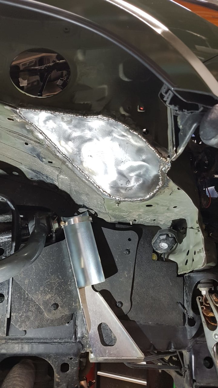

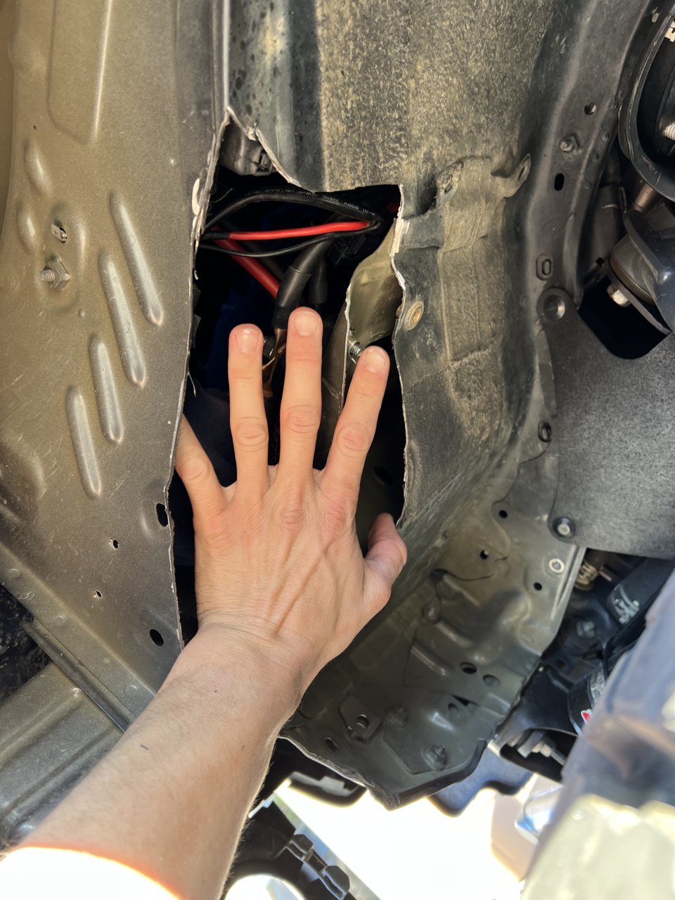

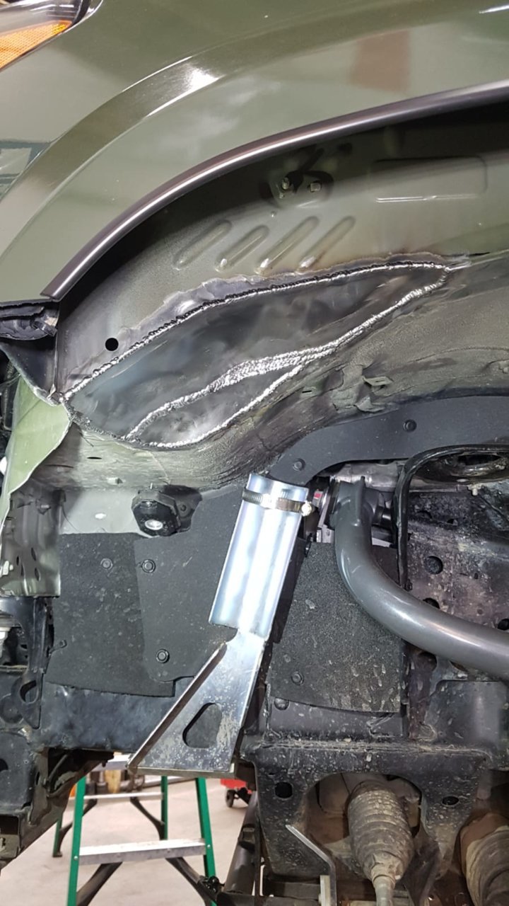

    What material thickness did you use for the patch? I have my arms pushed all the way forward which gives me just enough clearance to slightly rub the firewall at full lock and full stuff.
    Slashaar likes this.
  10. Jul 11, 2022 at 5:44 AM
    906taco
    906taco Well-Known Member
    Jun 22, 2021
    #369289
    3,954
    Cory
    08 Taco
    I personally used 20g on mine just because its so easy to form and work with and it was close to factory thickness. On my firewall I used 16g just for a little extra protection.

  11. Jul 11, 2022 at 5:47 AM
    EatSleepTacos
    Mar 24, 2015
    #151688
    59,845
    Randy
    West Valley, AZ
    2017 4Runner
    That's what I use too. It seems too thin when it's in your hand but once it's formed and welded, it's solid.

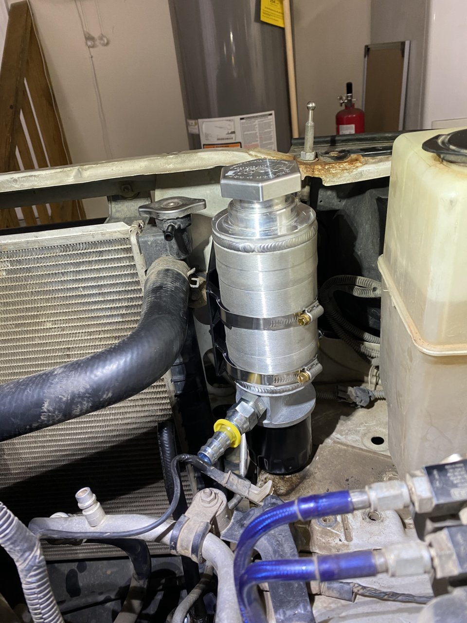

    I pulled the fuel pump relay and it worked wonderfully. Though the first time I cranked the truck started and it really threw me off. Must’ve been the residual gas in there.
  13. Jul 11, 2022 at 12:18 PM
    EatSleepTacos
    Mar 24, 2015
    #151688
    59,845
    Randy
    West Valley, AZ
    2017 4Runner
    I think I got it all fixed so I figure I'd share what was going on.
    I bled the system again this morning and got all of the air out. I jacked the front end up and cycled the steering wheel a whole bunch. Then removed the fuel pump relay and cranked the engine for a few seconds, and then cycled the steering some more. I repeated that 3-4 times. Then I started the truck and let it idle for 2 minutes, then turned the steering wheel a dozen times but stayed off of steering stops. Turned the truck off and waited 5 minutes. Good to go.
    Went for a 4 minute test drive and when I got home, more bubbles in the reservoir.
    Both fittings on the pump were seeping so I tightened them more. They were already tight, but I really cranked down on those suckers and I bled the system again.
    So far so good, so I presume it was sucking air in through those fittings. I think there may be a little air left in the system so I'm leaving the cap off of the reservoir overnight, something I read on pirate as well as recommended to me by a mechanic buddy.
    DoulosXP likes this.

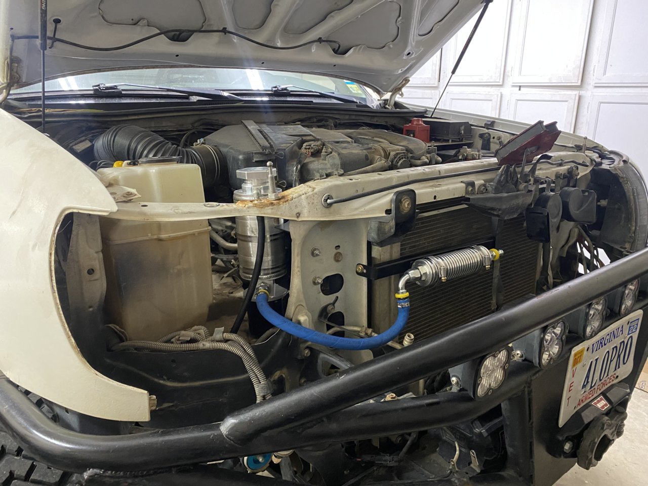

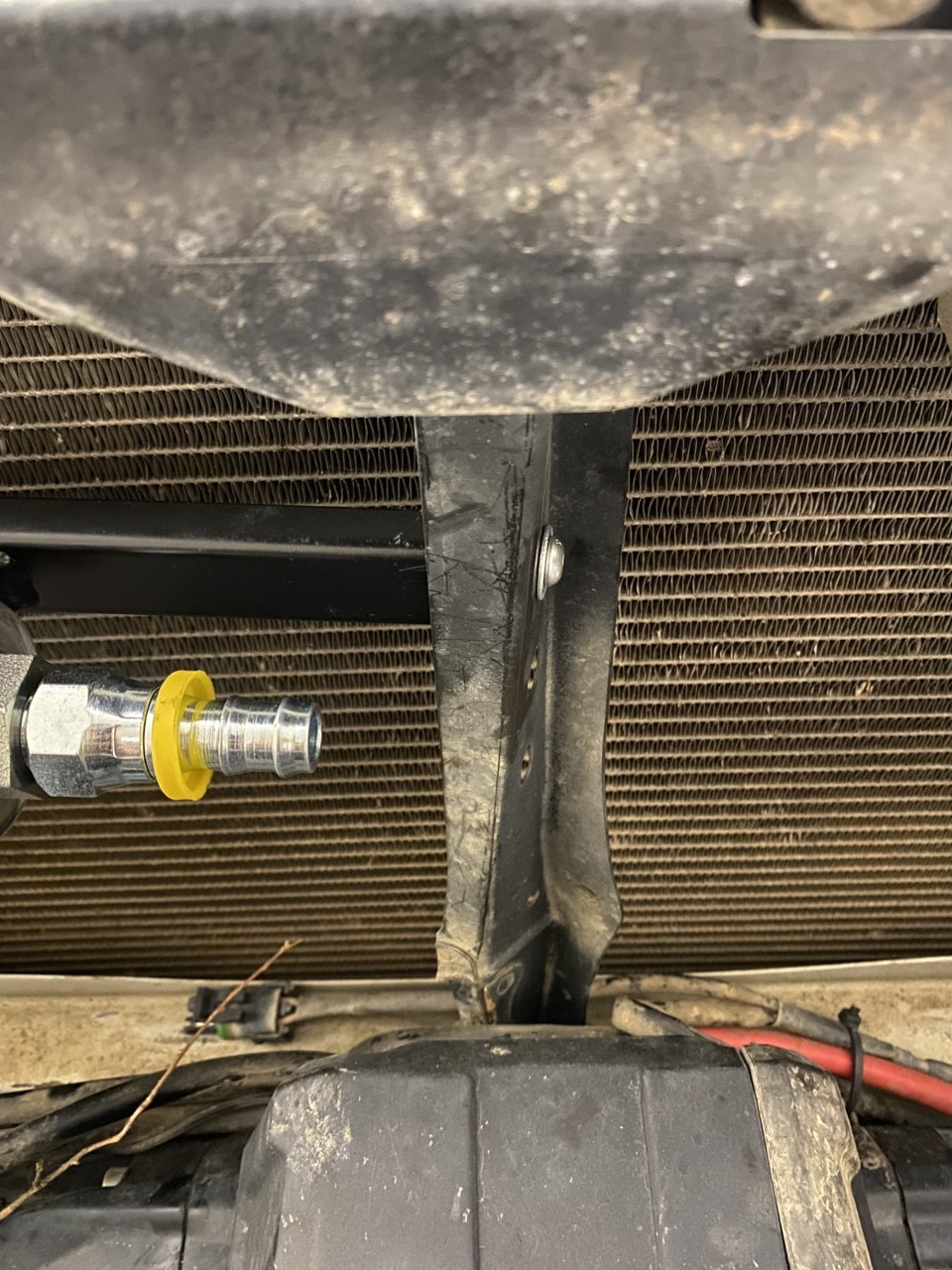

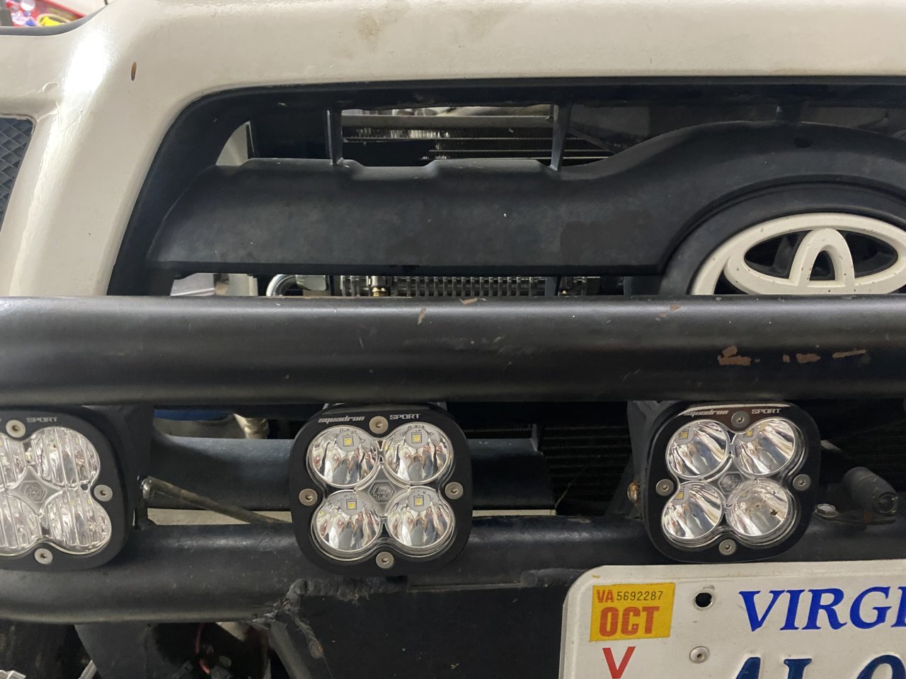

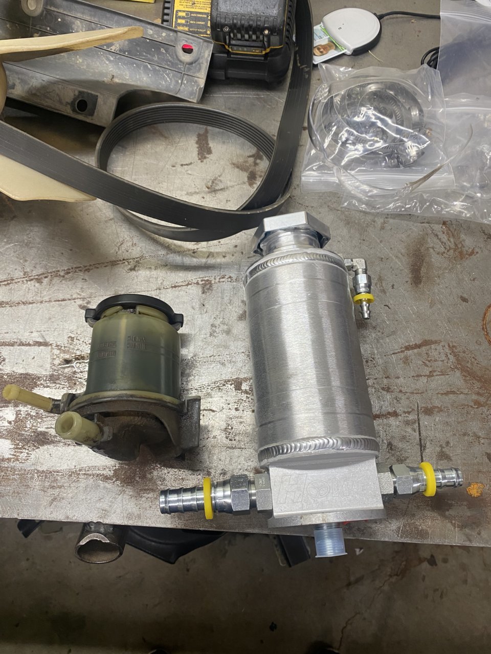

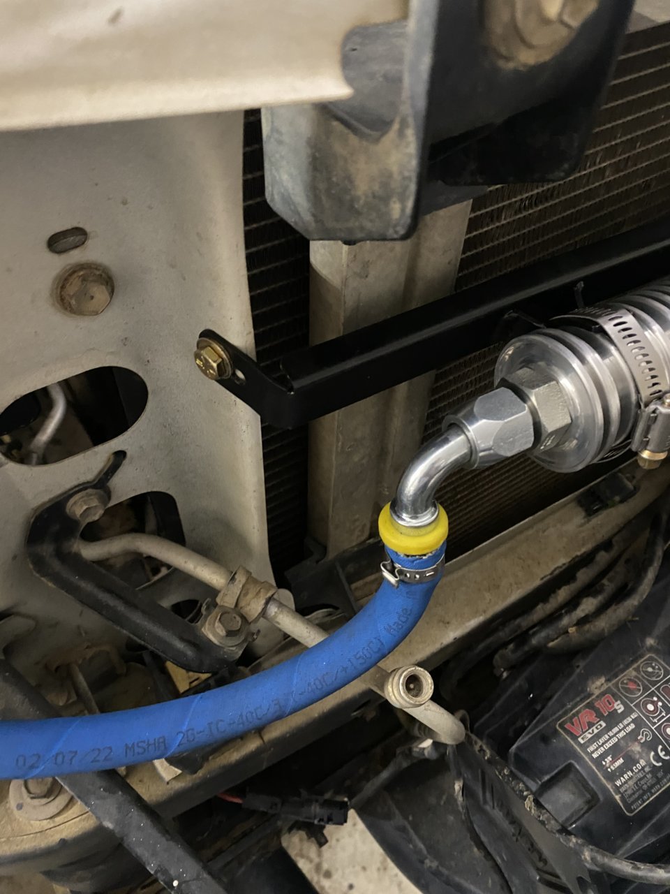

    I'm running into this issue as well so I've mounted my cooler horizontally like yours. I am picking up the straight fitting today so the hose routing isn't so funky.
  15. Jul 11, 2022 at 12:31 PM
    EatSleepTacos
    Mar 24, 2015
    #151688
    59,845
    Randy
    West Valley, AZ
    2017 4Runner
    That one guys OCD will thank you for that. I’ll be honest, I almost picked up a straight fitting when I was at the hydraulic store the other day, but decided against it.
    betterbuckleup likes this.
  16. Jul 11, 2022 at 12:33 PM
    desertjunkie760
    desertjunkie760 @DesertJunkie760 (IG)
    Apr 11, 2016
    #183963
    9,152
    Shane
    2011 MGM DCSB TRD Sport 4x4
    Check My Sig.
    Haha. I'm not OCD and it'll function as intended with the 90*. Plus, the grill will hide the routing anyway. I haven't reopened the system up yet though to re-route the hoses so might as well take the opportunity and do it "right".

    So you already had the system installed and ran into winch issues so you're remounting the cooler? Am I getting that right? But yeah, may as well get the straight fitting on there while you're already in there.
  18. Jul 11, 2022 at 12:38 PM
    desertjunkie760
    Apr 11, 2016
    #183963
    9,152
    Shane
    Check My Sig.
    That is correct. I had the PS setup installed but had the bumper off for modifications. So now I get to redo my work. :bananadead:

    Damn! That came out very good. Looks mean as hell.
  20. Jul 11, 2022 at 5:15 PM
    906taco
    Jun 22, 2021
    #369289
    3,954
    Cory
    08 Taco
    Thanks man!
