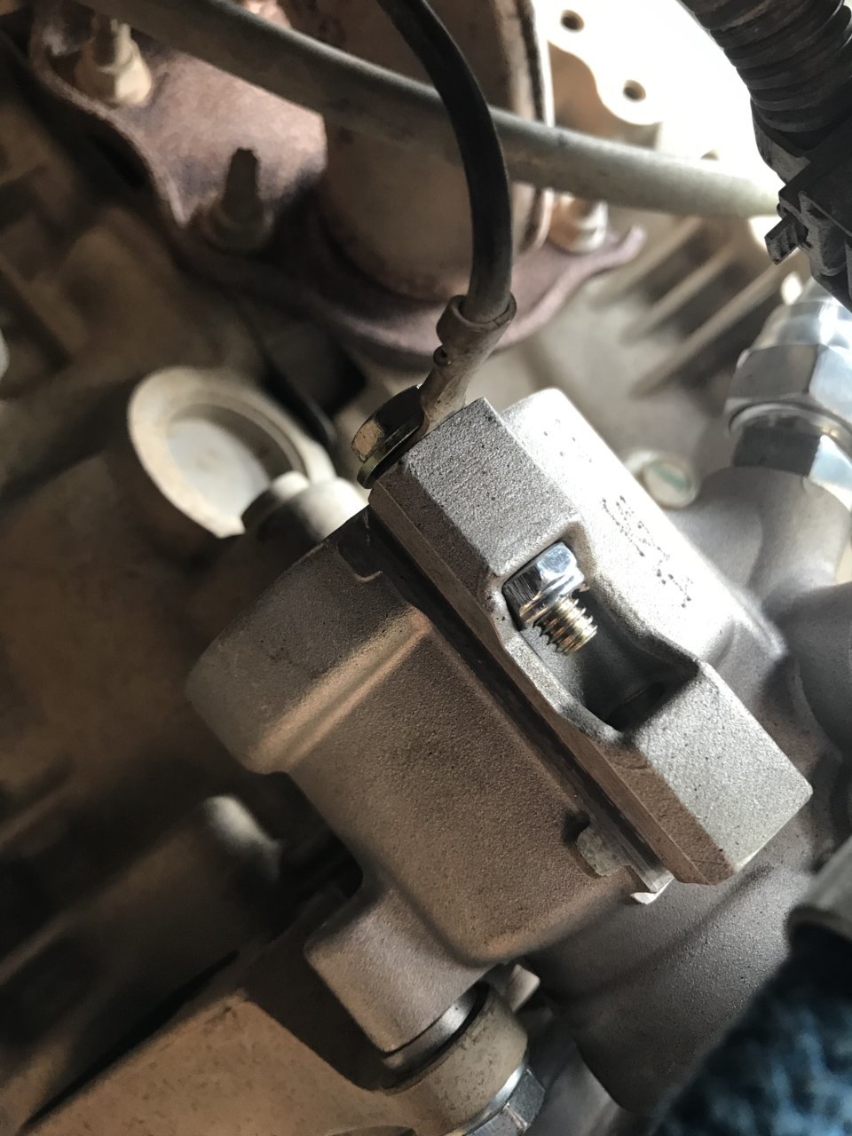

    This might be a stupid question, but for those who have done the Howe pump upgrade, where are you “grousing the factory wire? The factory eyelet isn’t large enough for the new bolts and I don’t see an easy alternative.
  4. Jul 11, 2022 at 8:48 PM
    snowsk8air2
    snowsk8air2 how hard can it be?
    Sep 16, 2011
    #63607
    10,541
    Flagstaff, AZ
    Supercharged TX Pro
    2011 S/C and basic mods
    Just zip tied mine out of the way. There’s so many freaking ground wired on these trucks.

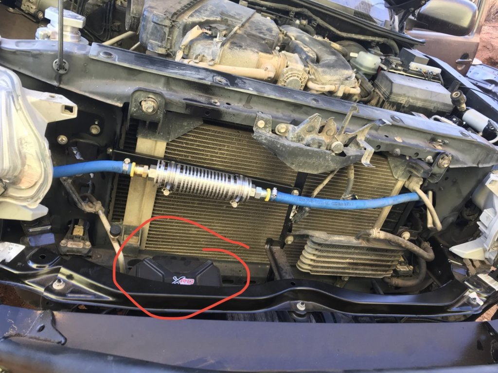

    What’s this thing?
    Don’t think this is needed when your truck is on Jack stands most of the year
  6. Jul 11, 2022 at 9:30 PM
    desertjunkie760
    desertjunkie760 @DesertJunkie760 (IG)
    Apr 11, 2016
    #183963
    9,144
    Shane
    2011 MGM DCSB TRD Sport 4x4
    Check My Sig.
    :rofl::infantry:

    I could have read those posts wrong. The switch is obviously not going anywhere. I thought the switch was just a pressure sensor but the ground helped the idle 100 RPM or so
    regardless, this was my solution for a ground. I had some spare hardware from the inner fenders kit. Used one of the long .25” bolts and lock nut. I ground the nut down on 3 sides to fit it in the tab.

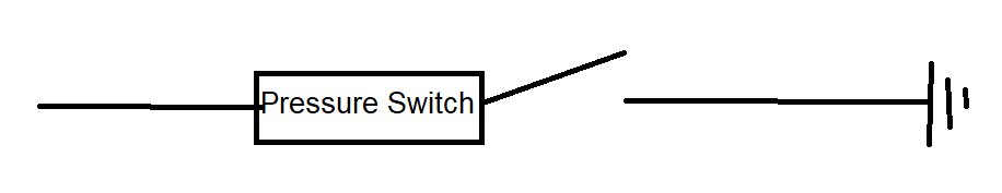

    This is how I understand it. The ground that's bolted to the back of the pump is grounded all the time. When the pressure switch hits a certain pressure, it closes the switch and grounds out, thus jumping idle. So regrounding the ground doesn't actually do anything, grounding the pressure switch does.
    *this is all my interpretation and I could be mistaken*

  16. Jul 12, 2022 at 9:21 AM
    906taco
    906taco Well-Known Member
    Jun 22, 2021
    #369289
    3,906
    Cory
    08 Taco
    You have it right.
    EatSleepTacos[QUOTED] likes this.
