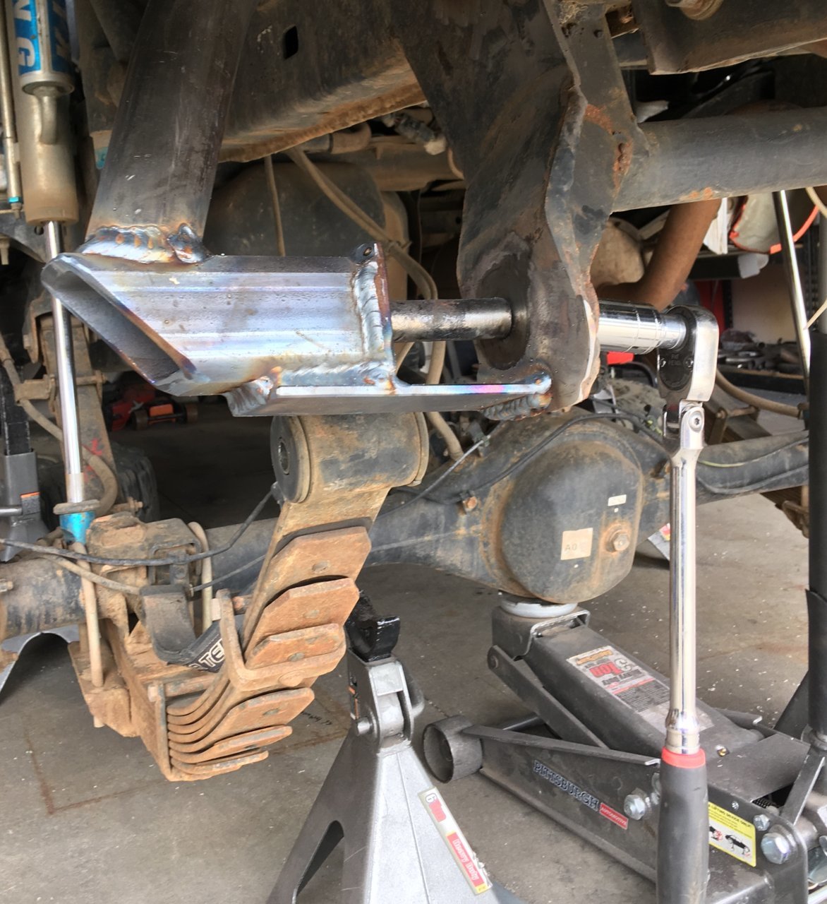

    You mean this low hanging crap that I just “fixed” for a 3rd time?
    Round tube goes back up to the frame and it’s all 1/4”.
    Hawk373, Taco-Obsessed and Dalandser like this.

    No offense taken. Nothing against DMZ or any other sua kits, but none of them were meant for rock crawling. I’ve probably spent as much time on the rear shackle hangers as sliders. Hopefully this “fix” will keep things straight until I decide to do links in a few years.
