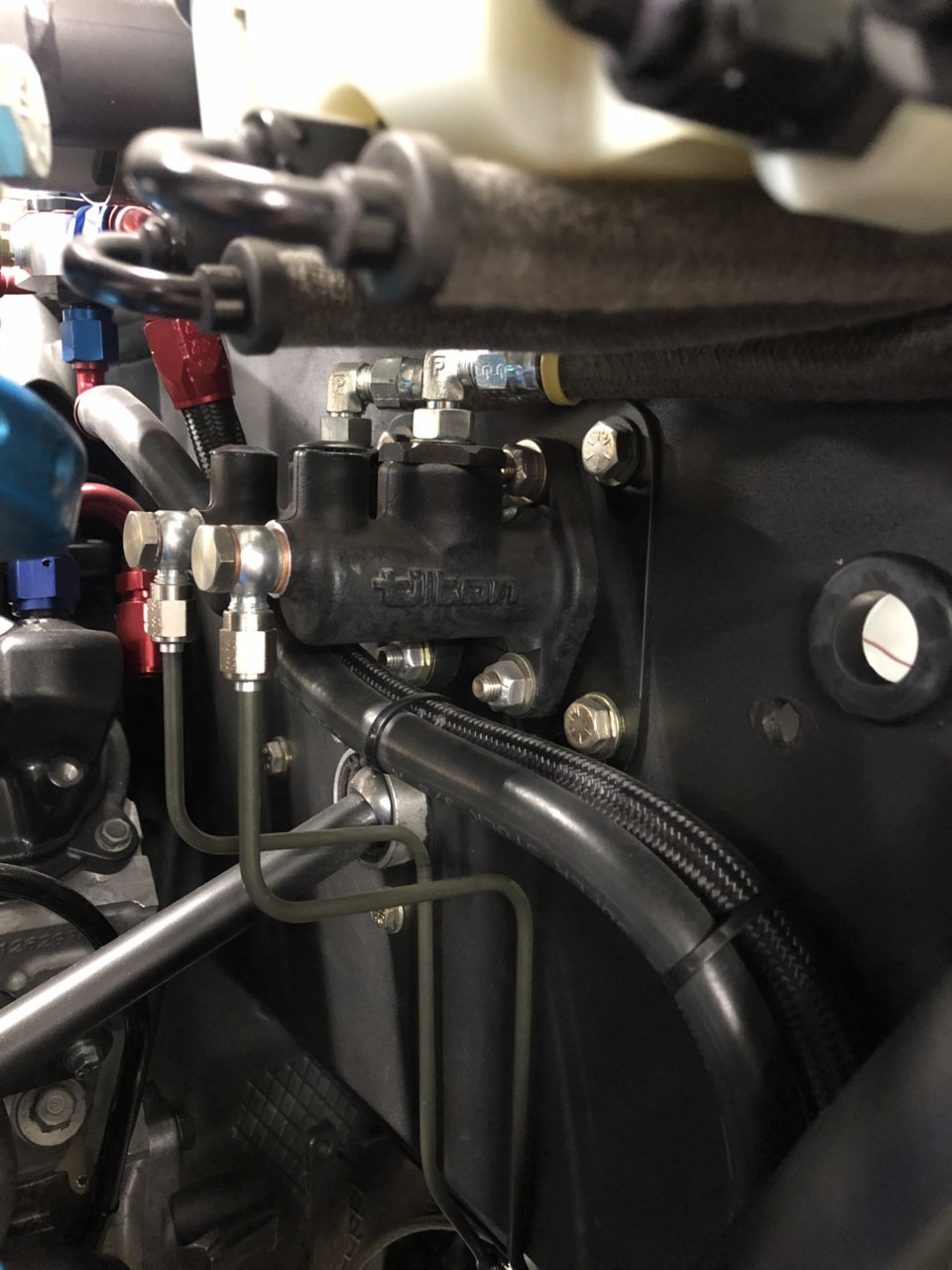

    One thing I've been tossing around for a while, and not entirely sure why it hasn't been a discussion in here yet. But why has nobody considered ditching the booster all together and going with manual masters? We have done quite a few manual setups and with the right master cylinder choice I actually prefer it over power brakes. It also makes it somewhat of a redundant system if you run dual masters/reservoirs. Lose one and you still have the other.
    Brakes are pretty important, especially for the go fast guys. It really wouldn't take much to make it happen.

    You would be amazed what a properly setup manual system will do. Don't think about the old school stuff, because that all sucked. My dads nearly 1,000 hp boat of a blower car stops amazingly well with manual brakes. Its all about choosing the proper bore sizes, which isn't hard to figure out.

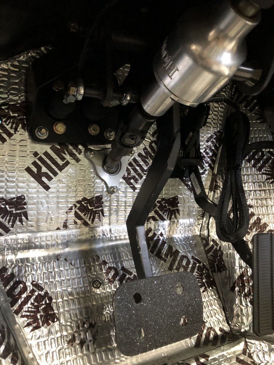

    you mean like this? :)

    I haven't dove in quite that far yet. But even if it wouldn't work with the factory pedal I don't think it would take much to add a Wilwood pedal. Best part is, all of this stuff is relatively cheap to do. You can get some nice pedal/master assemblies for under 300$

    What we have done on lots of cars is the wilwood pedal and masters under the dash then run bulkhead fittings through the firewall for brake lines and to keep reservoirs under the hood. Lots of different ways of doing this. But I don't think anybody would be upset with the performance.

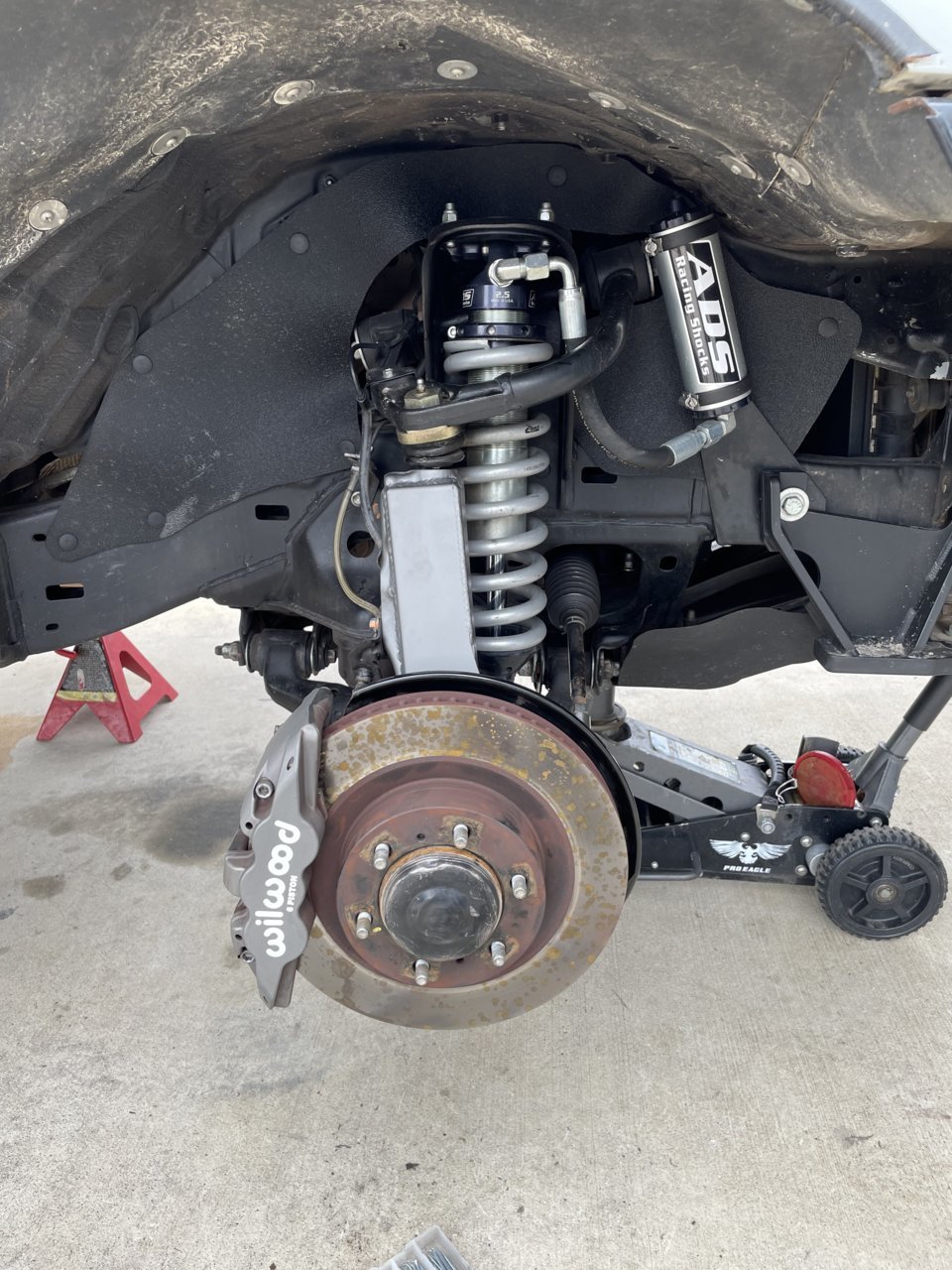

    I think you might be onto something with that. I didn't realize there were new axle assemblies out there for so cheap. It doesn't look like there is anyone jumping forward with the stubs available separately to sell... so might go down that path, can use it as is to plug the holes and make the truck roll with my RCV's out, and either sell the cheapo unit to someone for a trail spare, or cut/press it apart for the stubs for myself. Either way that is the range of money I was looking to spend on something, which is much less than even a crusty OEM part. Thanks!

    If you have an angle grinder, that's all you need to disassemble it enough to use that outer stub in the wheel bearing. Remove the boot and cut the shaft as close as you can to the cage. Then you just rotate the cage around and pop out the balls. You only need to get that stub pressed out if you want to reassemble it for long travel axles.

    Ahhh... thanks for this! I was mistaken, confused actually. Thought it had to be pressed apart cause that is what I saw people doing that converted to 934. Now I'm more clear.
