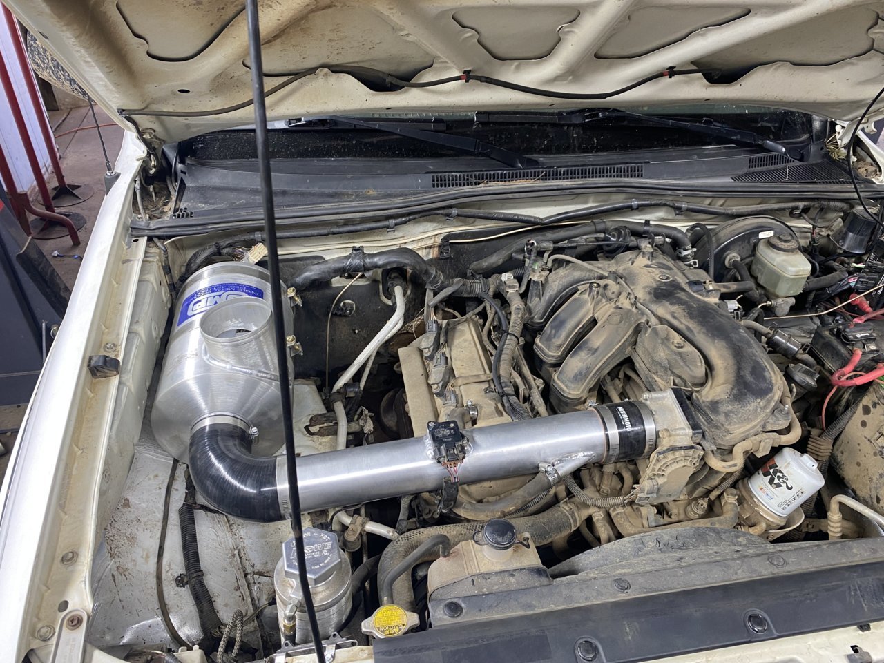

    So I have the inner fenders. But getting them installed probably won’t be until winter. Do any of ya guys know if there’s room to fit the UMP air filter with stock inners?
    With the long trip in Sept and open fenders worried about air filter clogging up daily.
    Would rather have the UMP

    I had my UMP on stock inners after deleting ABS. Made a plate that bolted on the old ABS mount for the UMP mount.

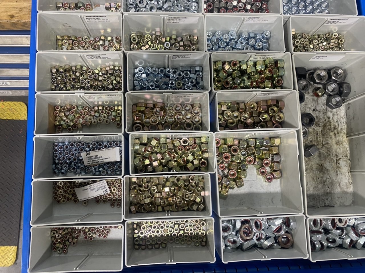

    My guess is the issue you guys are having is because you are reusing the nylock nuts. I’ve never had a problem with any of the ones I’ve installed because I mock everything up with standard nuts. Then everything is taken apart, painted and final assembly is done with brand new nylocs. The 1/4” 20 nylocks only have a thin amount of locking surface and when used multiple times they loose some of the locking capabilities. Moving forward we will start including a set of mock up nuts to prevent having to use the nylocks for mock up.
  14. Jul 18, 2022 at 8:24 AM
    Airdog
    Airdog did your Mom
    Dec 26, 2012
    #93790
    4,877
    Tom
    SoCal
    https://www.tacomaworld.com/threads/airdogs-2012-prerunner-access-cab-slow-build.264263/
    Shit…. Don’t we all have a drawer like this???

    Out of curiosity, where is the UMP drawing air from in that picture? Just ambient engine bay?

    Yes. According to data logs though, IAT's are pretty reasonable.

    I can confirm they stay about 10 degrees above ambient
