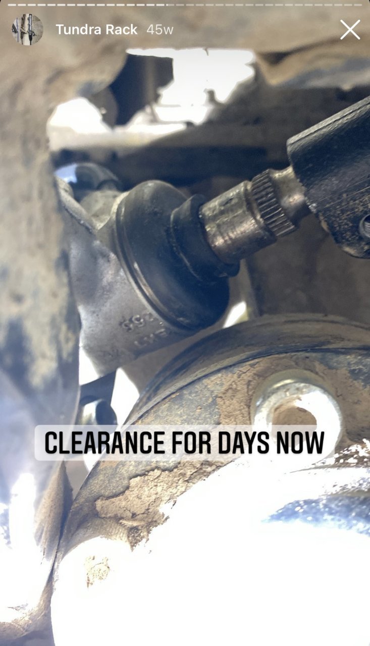

    No issues? How close is it?
  6. Aug 20, 2022 at 4:58 PM
    EatSleepTacos
    Mar 24, 2015
    #151688
    59,845
    Randy
    West Valley, AZ
    2017 4Runner
    Extraordinarily close and took some fucking around with shims to get the clearances I needed. No issues though now that it’s all said and done.

    What did you shim, the mounting points?
  8. Aug 20, 2022 at 5:04 PM
    EatSleepTacos
    Mar 24, 2015
    #151688
    59,845
    Randy
    West Valley, AZ
    2017 4Runner
    The mounting points to rotate the rack forward a smidge as well as the poly motor mounts to lift it up a bit. I think I also put shims under the rack itself, in between it and the frame. I don’t recall. I just know it took a lot of fine tuning to get it to where it needed to be.

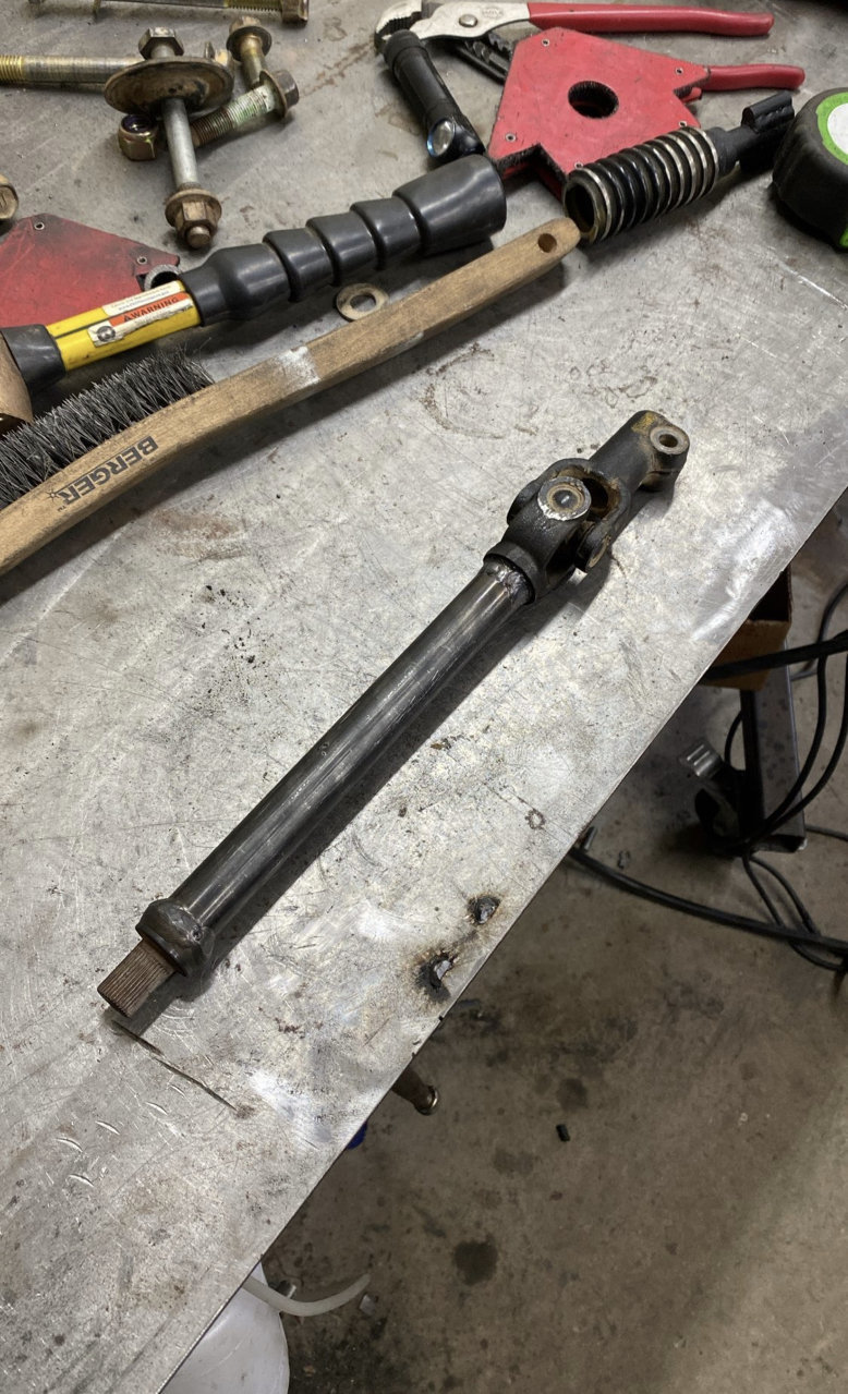

    Did you have to shorten the steering shaft?
  10. Aug 20, 2022 at 5:10 PM
    EatSleepTacos
    Mar 24, 2015
    #151688
    59,845
    Randy
    West Valley, AZ
    2017 4Runner
    Yes, I cut out the entire part and welded in some dom tubing.
