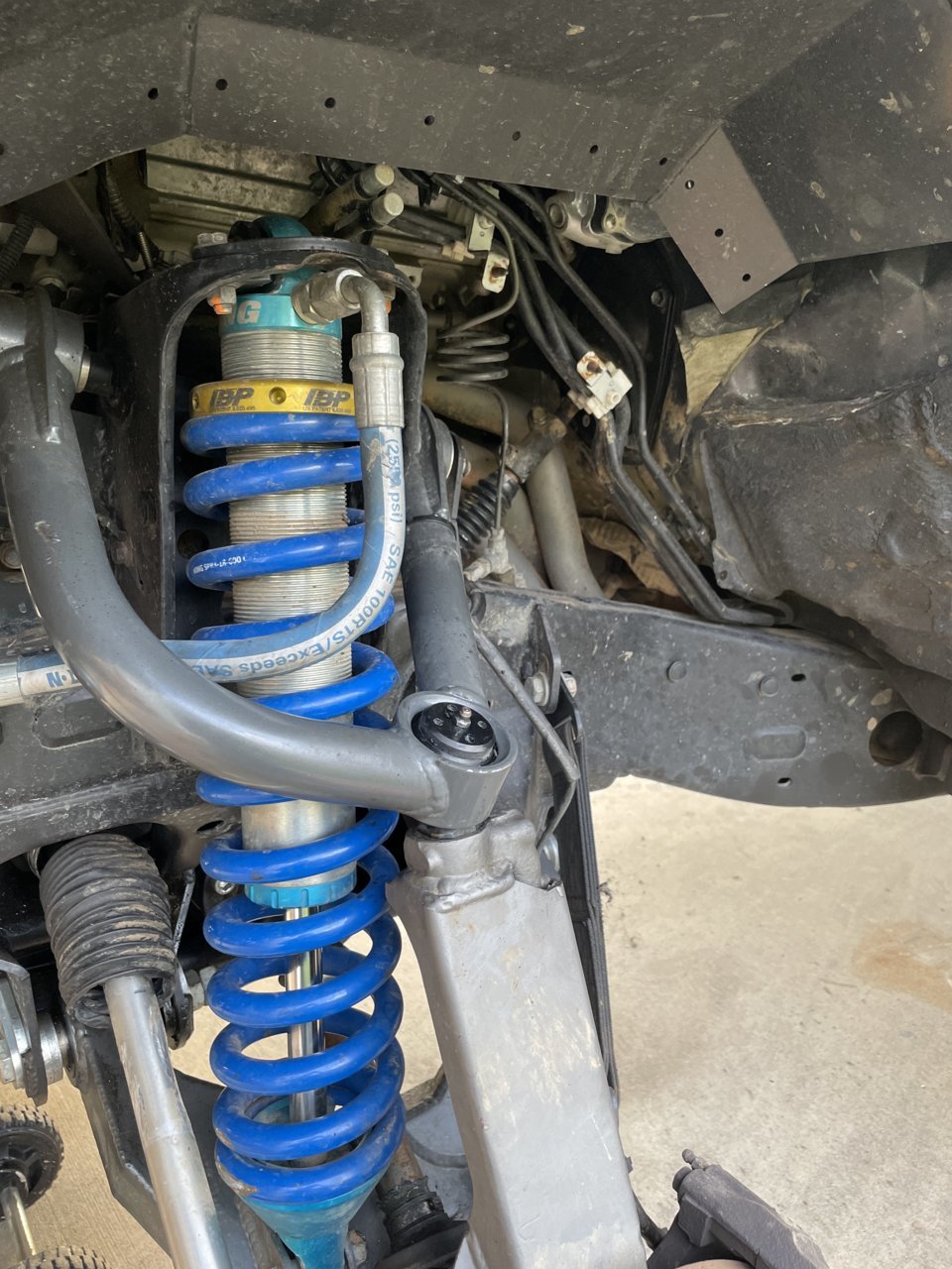

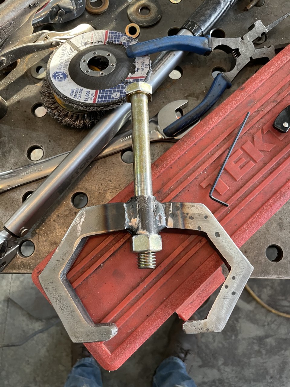

    092FB167-99B6-46C6-8BE0-0FAB729CAC7E.jpgimage.jpg Rebuilt my EMF uniballs, I just made my own tool to press them out after taking the snap ring off. Then I cleaned the uniball cup and uniball body with brake cleaner and scotch brite on a die grinder bit. Then took the Allen head set screw out. Took the cap off cleaned out all the old grease and dirt from in there. Then reassembled all and re greased. Getting uniball back in was a dick.

    Do you mean the uniball has a 1/4” of free play like “slop “ ? IE: it is moving in the cup ?

    Yes, I'll try and get a video I only did one side yesterday. It was up and down play which is better than side to side because it Was fixed by adjusting the cap

    I wonder how feasible it would be to drill a hole in the uniball cup for accessing the set screw. At that point you’d be able to rebuild and adjust them right on the truck. Unless I’m missing something.

    That is actually suggested to do on the EMF website You can see the hole in the second pic high on the cup
