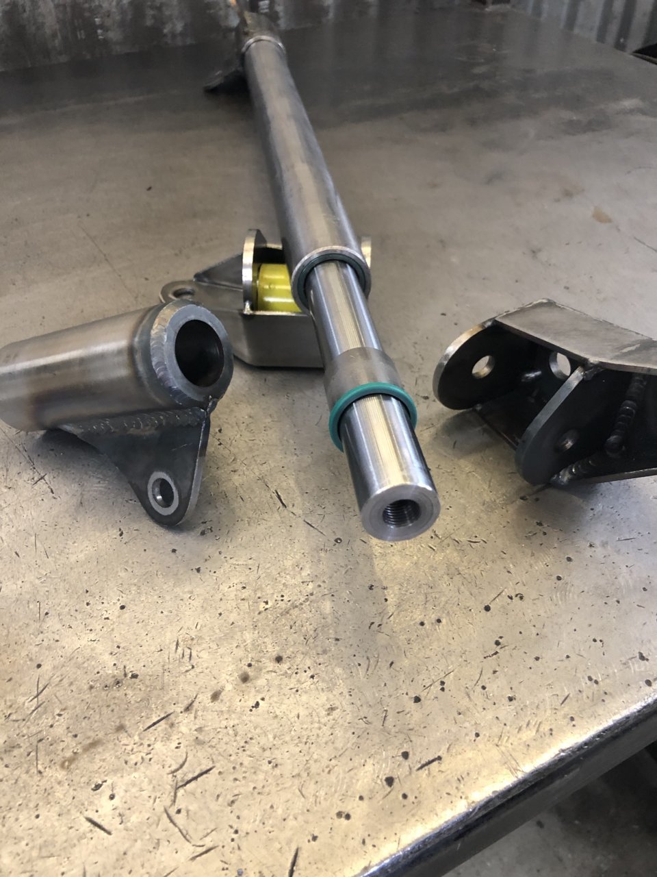

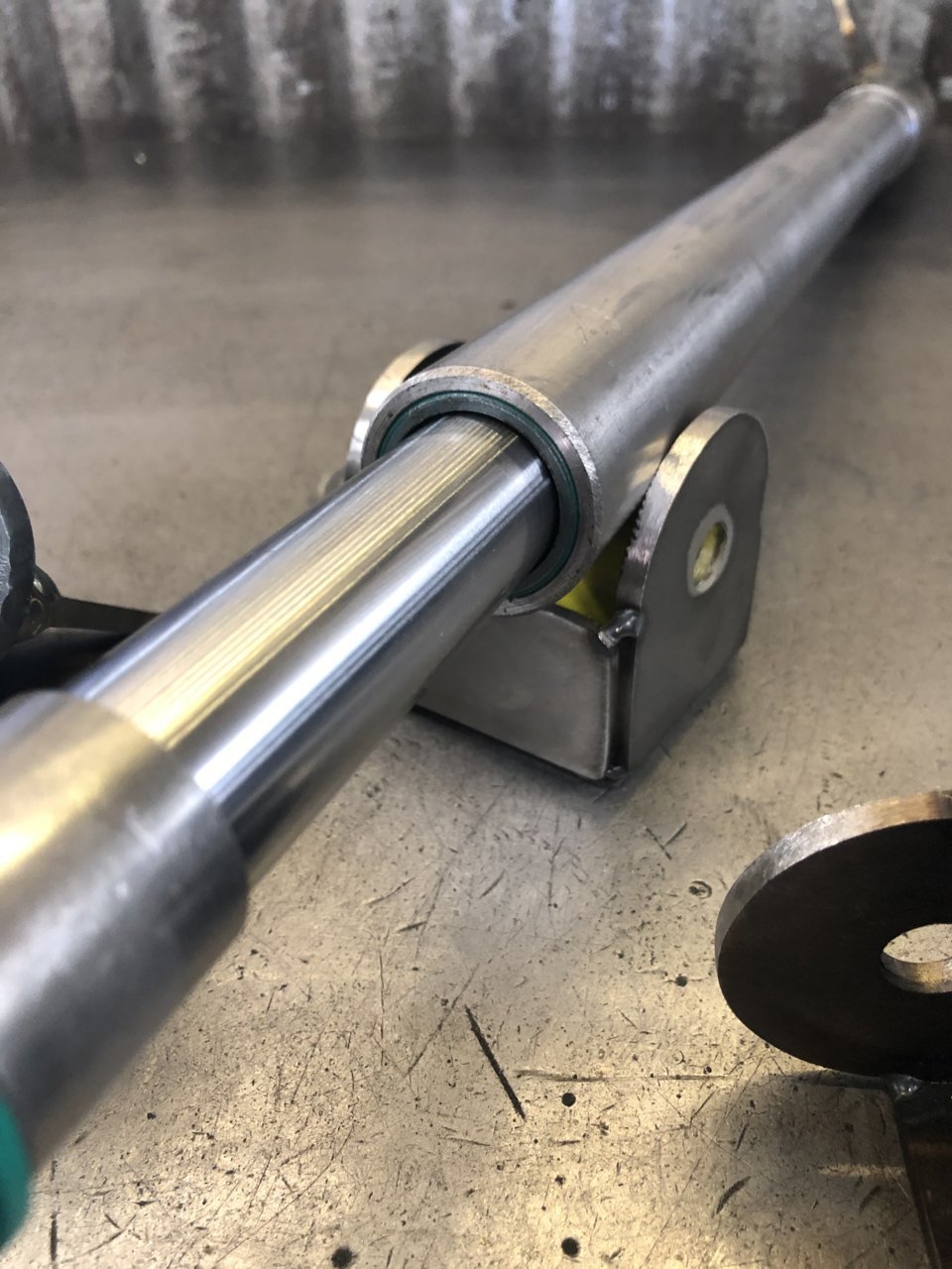

    For those wondering how the slider is sealed here is a pic of the setup

    I'm interested to see this axle set up and how/where the slide is interfaced. A solid set of axles competitive with RCV would be awesome.

    So this is what you’re selling, right? The slider that gets bolted/welded on but not the actual steering rack that it reinforces?

    You use the factory rack, this setup bolts to it

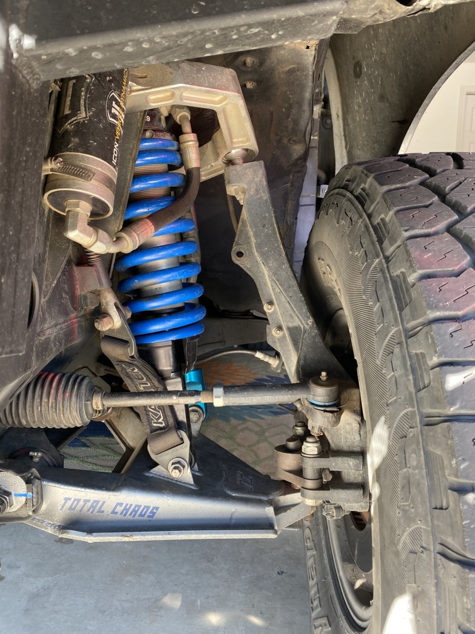

    Here is the completed rack assembly out of the truck. The bar across the bottom is the jig used to make it and is not part of the kit

    If you are 2WD the Maxtrac spindles flip the tie rod to the top.
    Arcticelf likes this.

    That is awesome! BEEEEEF! I’ve been nursing my ailing stock rack along, will need to snag one of these when I replace it finally.

    Thank you for posting this pic. Ever since @81Trekker spoke of the slam that the KINGs provided, and a limit strap was the fix, I've been trying to figure how to attach to my new TC lowers.
    I love this thread!
