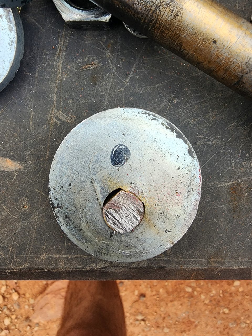

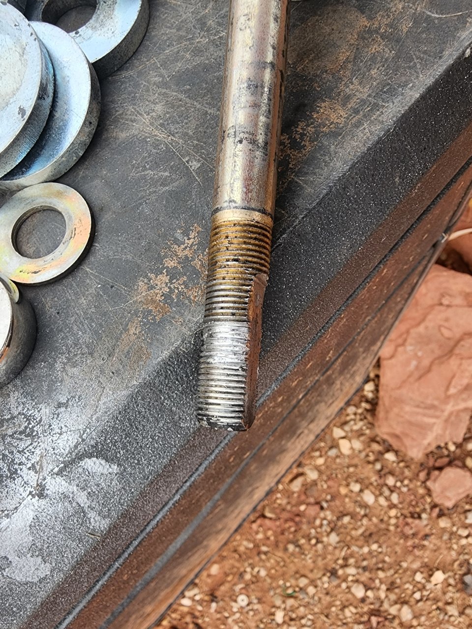

    I've installed a lot of these kits and had this happen a couple times. Cone lock nuts are super hard on the threads, and with part of the threads machined out, they do get stripped once in a while. Usually it happens after they've been on and off a few times.
    I don't know if the alignment shop is good or bad, but I wouldn't completely blame them. I've also seen this happen a lot with SPC cam bolts which are the same design with a cone lock nut. You really have to use never-seize when you install them, and that will help a lot to prevent damage.

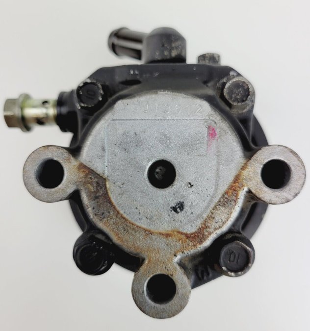

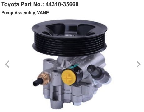

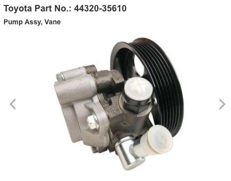

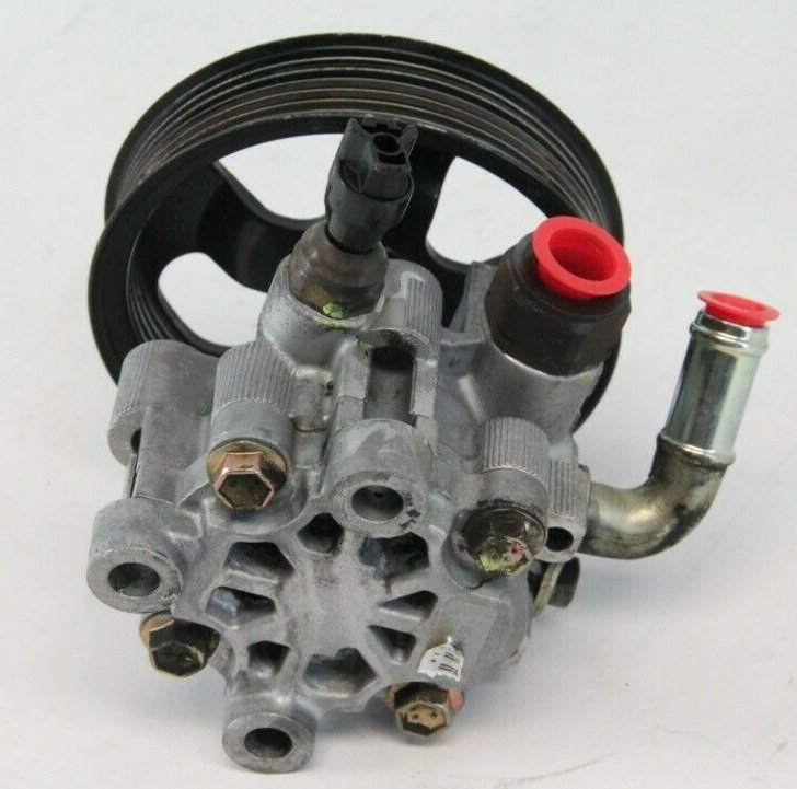

    Looks like the V6 and V8 power steering pumps are pretty similar. V6 has an idle up connector on it though.
    V6-
    V8-
    V6-
    V8-
    Slashaar likes this.

    Mounting points look to be identical. If the dimensions all match up I see no reason you couldn’t make it work. Though you will likely have to measure for a belt yourself and make some tweaks along the way and mounting for the reservoir and cooler may be different. Another option is porting a new OEM pump. There are some threads over on pirate about that.

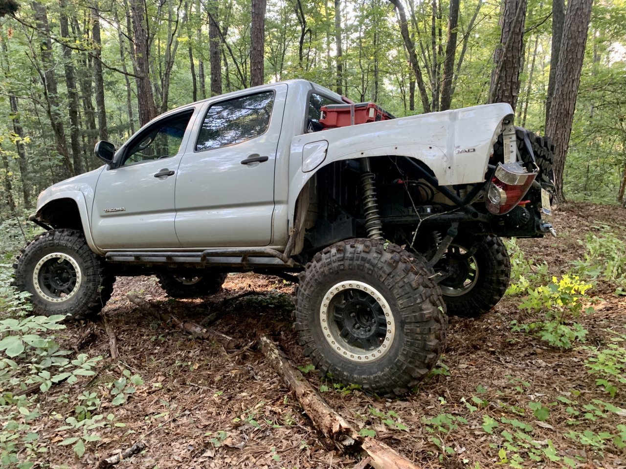

    Didn’t get far before the main leaf snapped. I guess 5.5 years of abuse is the limit for leafs before needing to replace them.

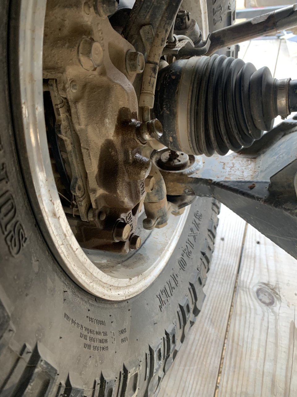

    Are the copper seals for the banjo bolts easy to find at a parts store? I just tightened mine down a bit, so maybe that’ll work.
  17. Sep 11, 2022 at 2:57 PM
    EatSleepTacos
    Mar 24, 2015
    #151688
    59,835
    Randy
    West Valley, AZ
    2017 4Runner
    I don’t see why not, Napa probably has them. They’re M10. Was this after wheeling? Do you have any gouges in the head of the banjo bolt? I’m wondering if you had the same issue I had where it came in contact with the secondary bypass shock tab.

    I looked around and didn’t see any dents or dings. Only noticed after wheeling for a bit. I haven’t lost any considerable amount of fluid just eyeballing the reservoir. Maybe the fluid warms up and thins out just enough to escape a bit. I tightened about a quarter turn so I’ll ride a bit and check in a bit.
    EatSleepTacos[QUOTED] likes this.

    Doesn’t looked damaged like @EatSleepTacos did either. Replace the seal if needed. If it wasn’t tightened up enough, remember there’s half a ton worth of PSI in those lines, so it could just be a leak.

    Tightened it up and took it for a gingerly stroll through my trails. Kinda broke another taillight, but no leaky brakes. Guess it was just a bit loose.
