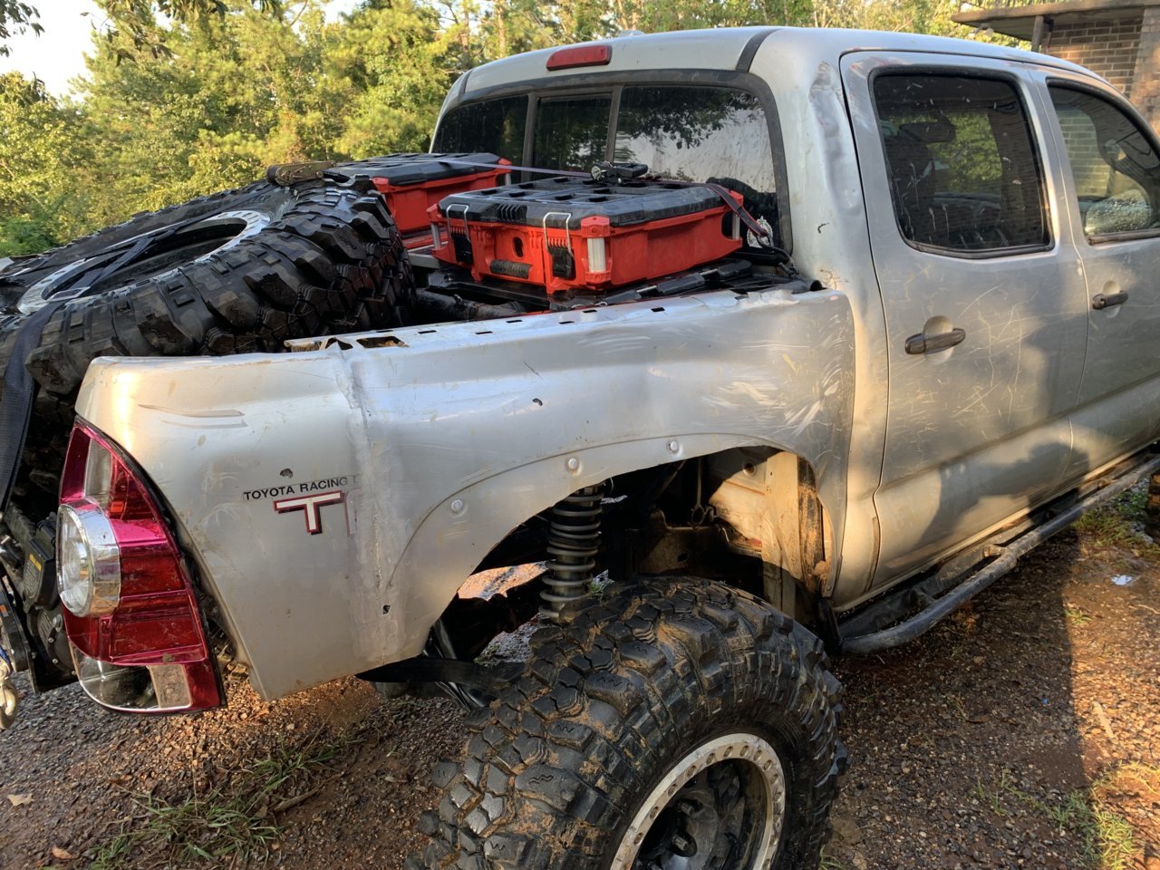

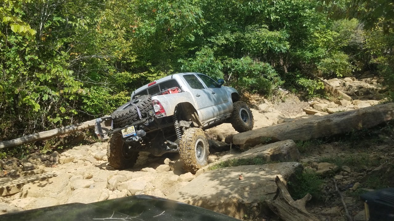

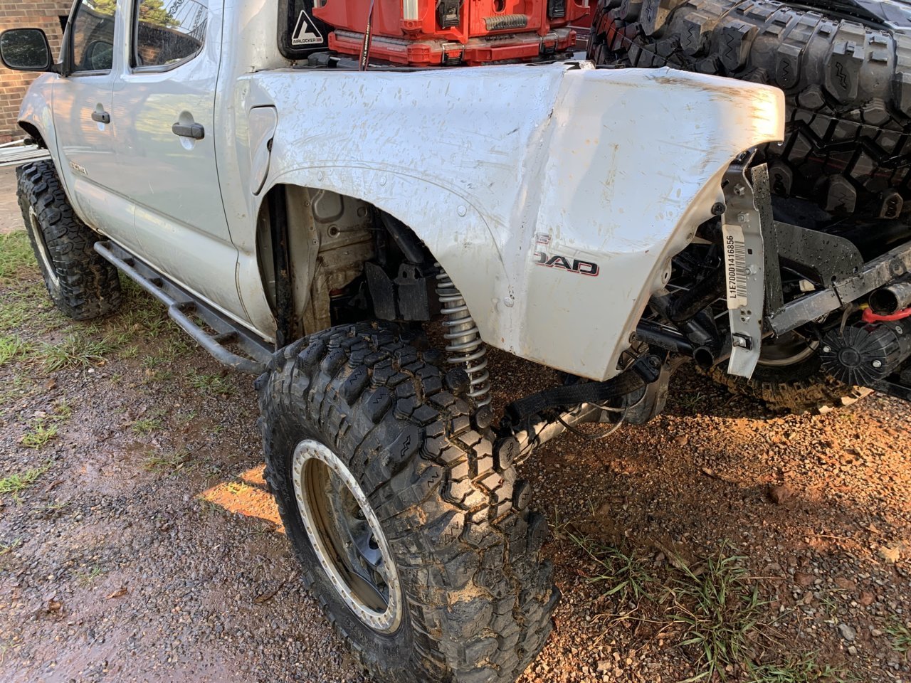

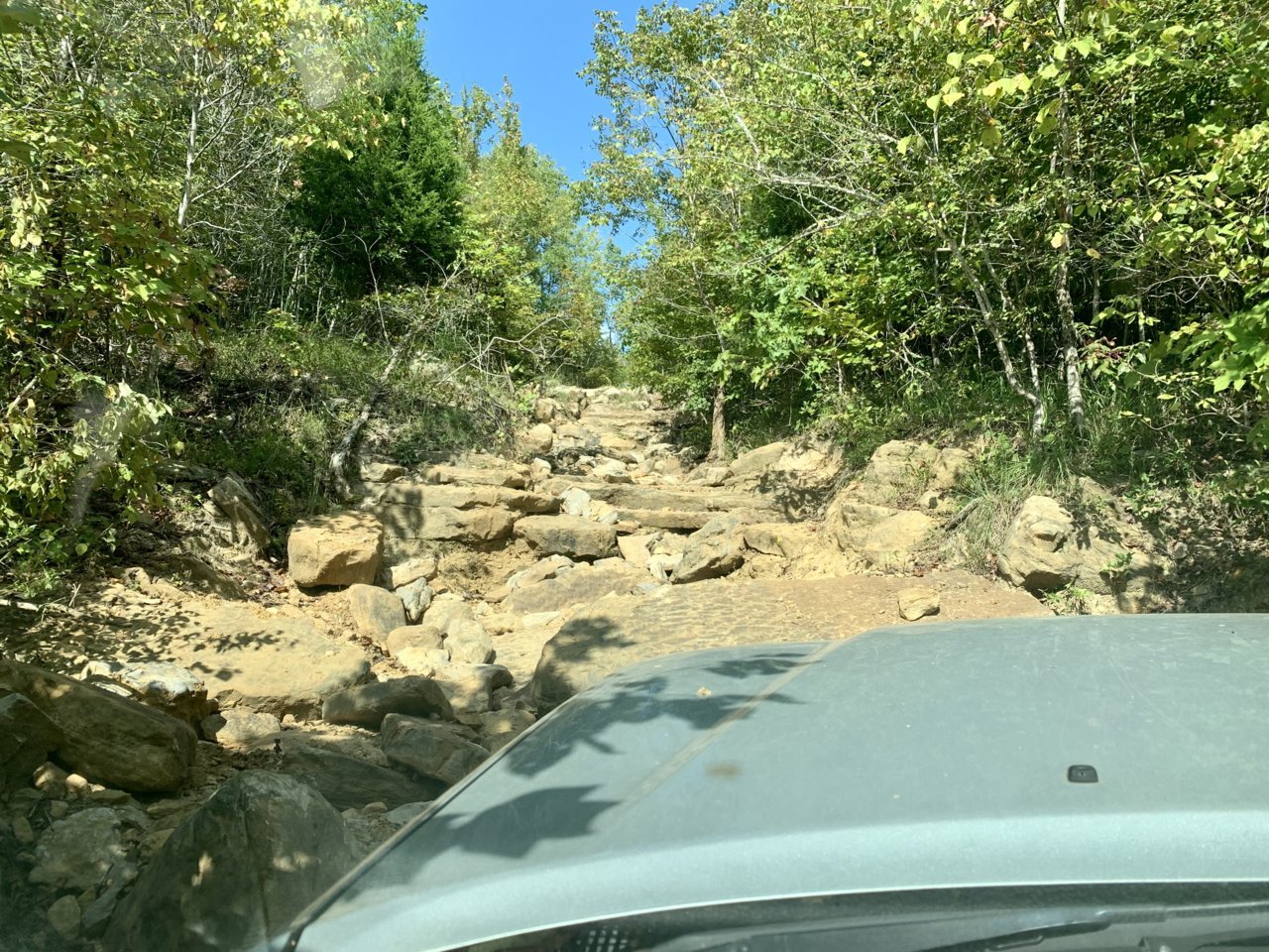

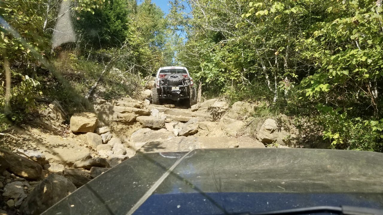

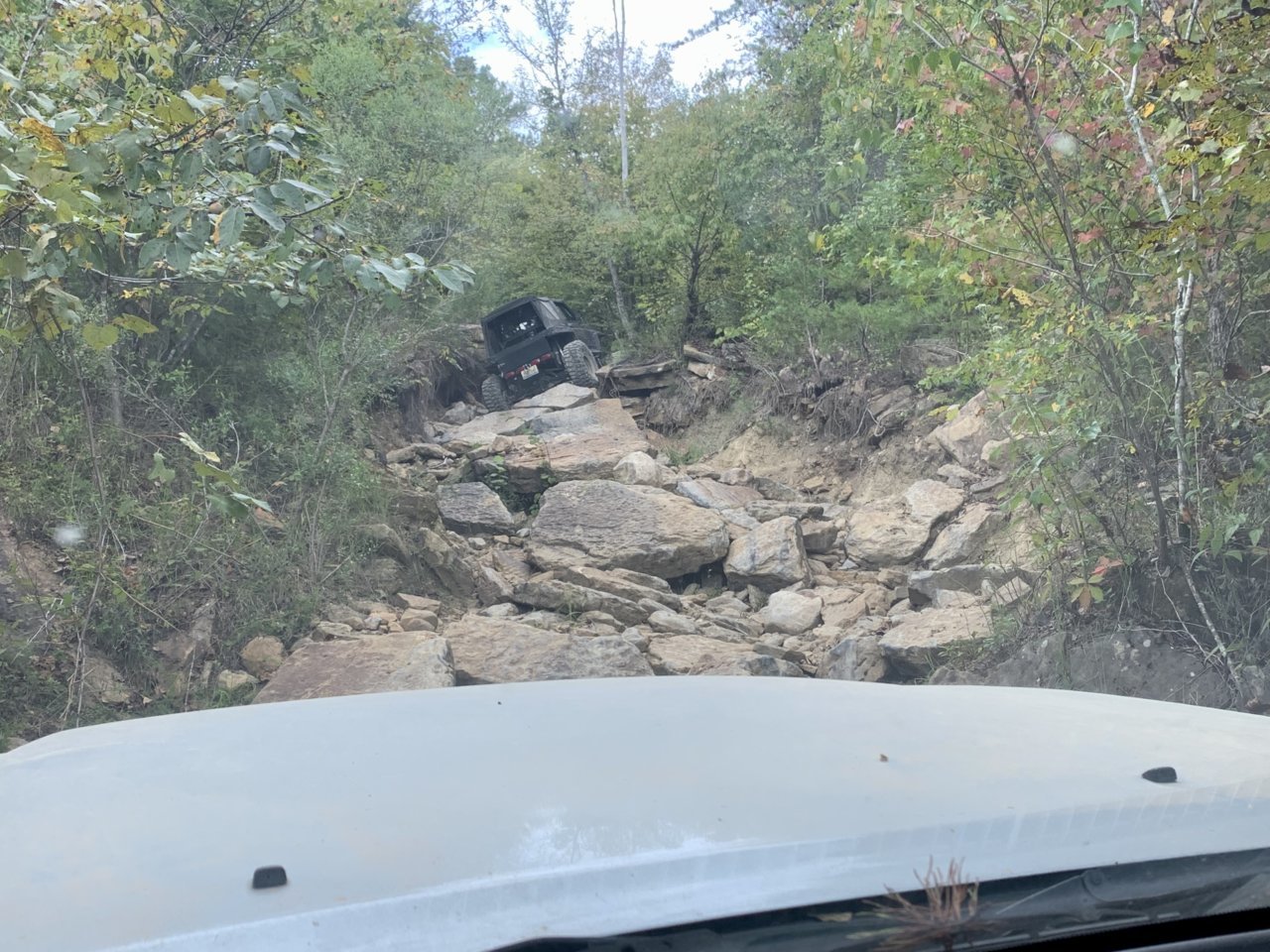

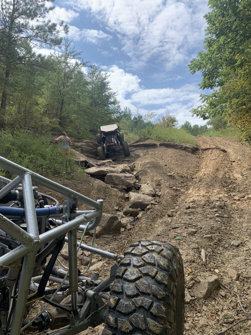

    I found a few rocks at Hawk Pride this weekend with some Zuks on 40’s. Had to put my “light duty” kit to work. I still don’t know why I even bothered with the bedsides and tail lights.

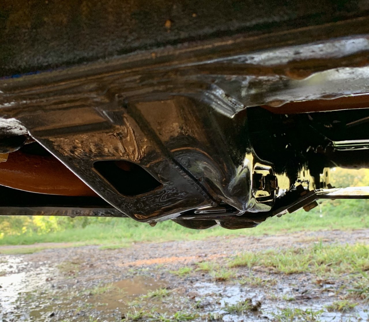

    I’ve got the 2.25 kit, so no adjustable arms. I didn’t realize how weak the crossmembers are until I crushed that one in a bit. Granted it shattered my butthole when it happened, but still…the front could use some extra beef. Steering is the biggest thing holding me back. Can’t tell you how many times I said “I can’t” to spotters haha

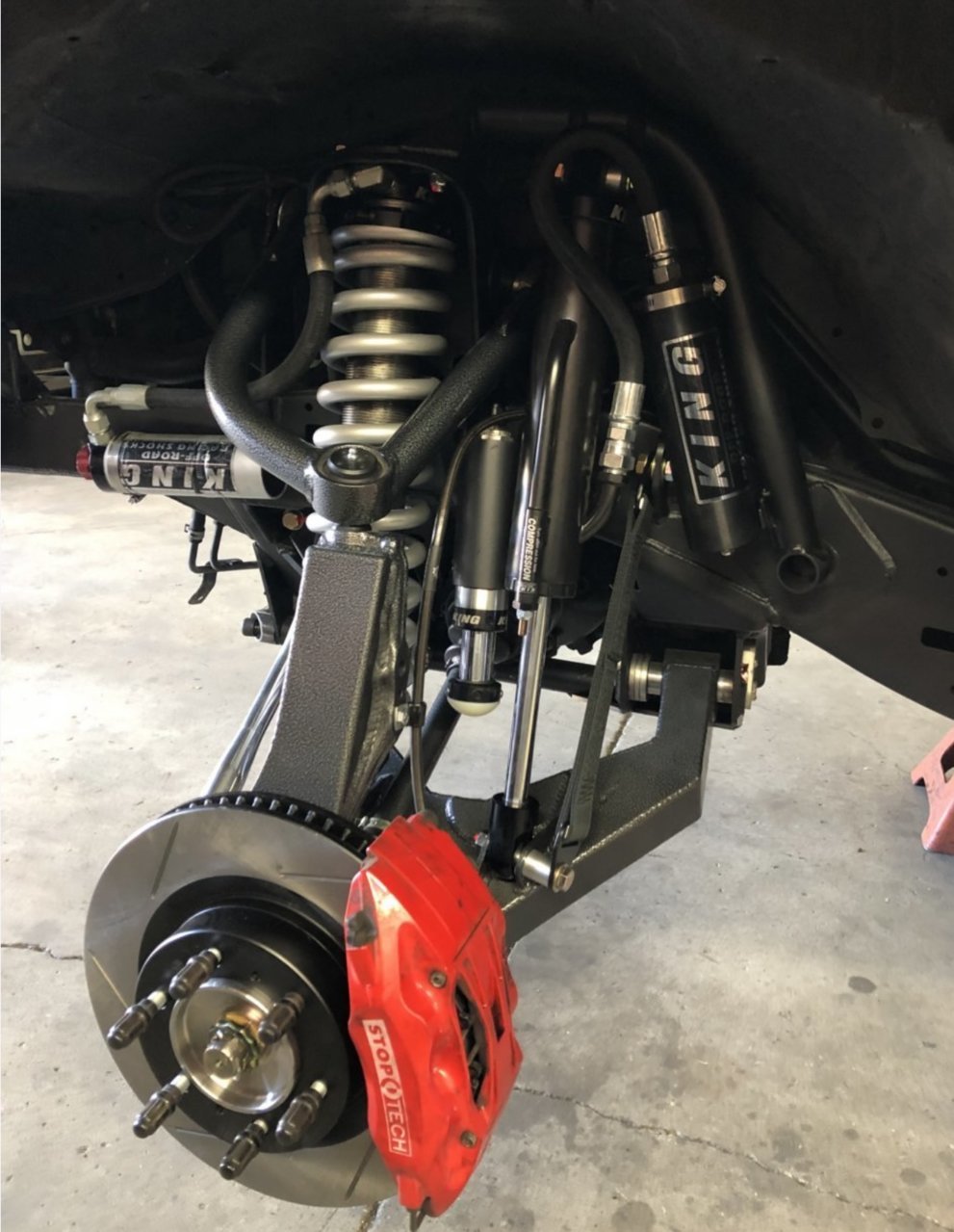

    Is that a freebleed secondary? Might be some hidden tubes but ive noticed some have the bypass tube above on the compression side like this. My rears have it below with the reservoir. I guess either way its just bypassing the main piston. Just trying to get a better understanding
  17. Sep 22, 2022 at 7:58 AM
    906taco
    906taco Well-Known Member
    Jun 22, 2021
    #369289
    3,907
    Cory
    08 Taco
    I think JD just oriented them up for ease of adjustment after learning downwards wasn't ideal. I can Adjust mine right through the wheel openings nice and easy facing up. Down would suck.
    Suicyco[QUOTED] likes this.

    They are free bleeds = stealthy quiet bypasses
