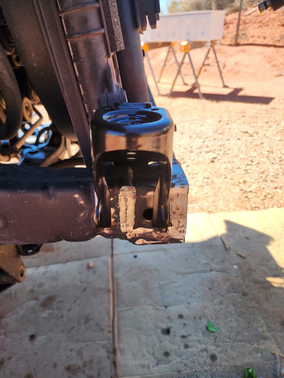

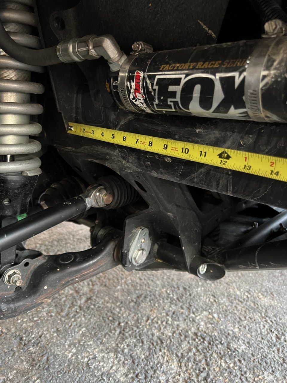

    Can someone take a measurement of where this mount is placed in relation to the hole on the frame? Mine were damaged and want to double check with others to make sure I weld them back on in the correct spot.

    EatSleepTacos
    Mar 24, 2015
    #151688
    59,841
    Randy
    West Valley, AZ
    2017 4Runner

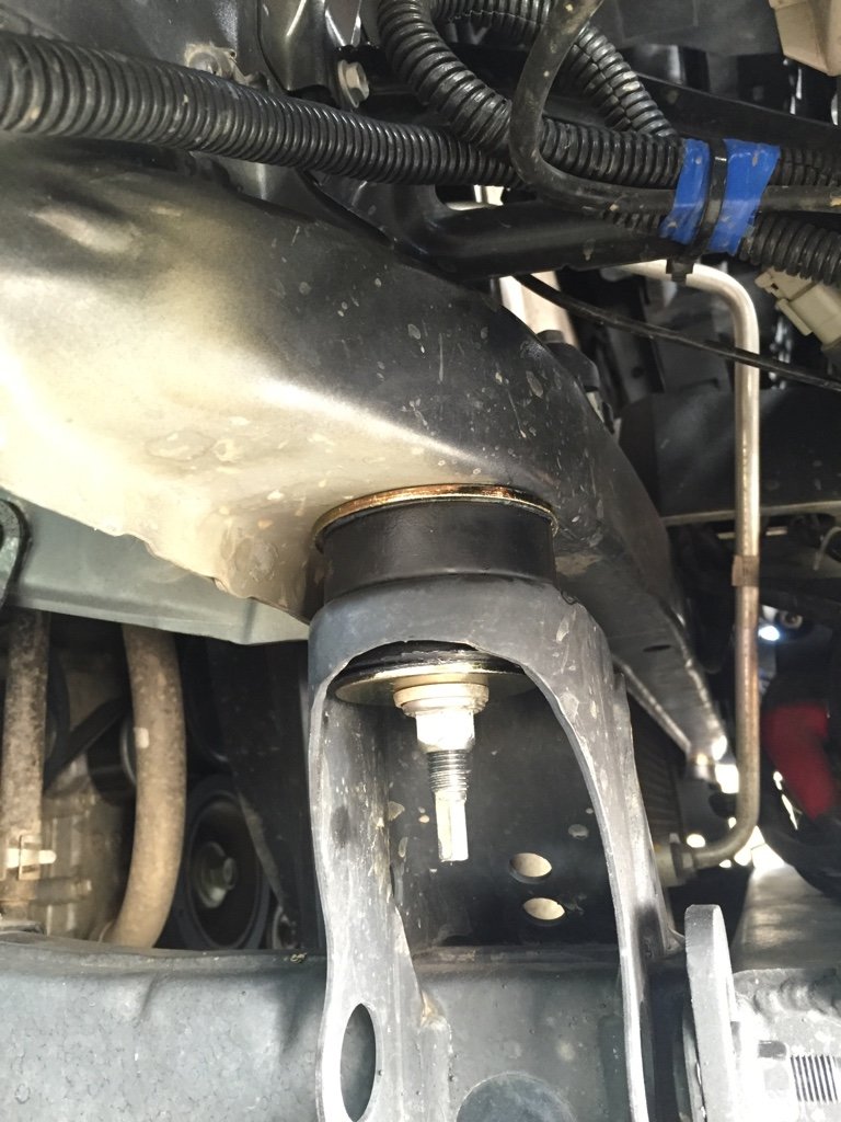

    Not my pic, found it in the radiator support bushing thread. It looks like you'll need to move it forward.
  7. Sep 25, 2022 at 6:03 PM
    01 dhrracer
    01 dhrracer Well-Known Member
    Aug 27, 2013
    #111316
    1,921
    Palm Desert/Bermuda Dunes
    Still Shopping
    Couldn't you put the core support back on align with hood and fender then locate bracket?
  8. Sep 25, 2022 at 6:40 PM
    lferrara
    lferrara Well-Known Member
    Oct 7, 2021
    #379081
    369
    Luke
    Saint George, UT
    2014 DC TRD OR
    JD Fab Lower Pivots, JD Fab Slide Rack, JD Fab Inner Fenders, JD Fab UCA, DIrt King LCA, King Coilovers, 4.88 gears, 91 octane tune, etc...
    Yeah I just set there temporarily for the pic. Still have more grinding to do for fitment. Thanks for the pic for reference though. I figured it would be almost all the way forward.
  9. Sep 25, 2022 at 6:42 PM
    lferrara
    Oct 7, 2021
    #379081
    369
    Luke
    Saint George, UT
    2014 DC TRD OR
    Yeah that's what I was planning on doing. Just wanted some measurements for double checking to have something to compare it to.

  10. Sep 25, 2022 at 6:42 PM
    Anderson5290
    Anderson5290 Well-Known Member
    May 30, 2018
    #254979
    758
    Brandon
    Corona, Ca
    2018 Tacoma TRD OR 4x4
    Tuned Fox 2.5 resi with dsc, JBA HD UCA, total chaos knuckle gussets, rear trd pro fox shocks, Deaver U402 stage 1 rear leafs, archive garage u bolt flip with fox 2.0 air bumps, White knuckle off road rock sliders, BAMF 1/4” steel skids, Magnaflow exhaust, Archive Garage Hammer Hangers, Cbi high clearance rear bumper, 285/75/16 tires.

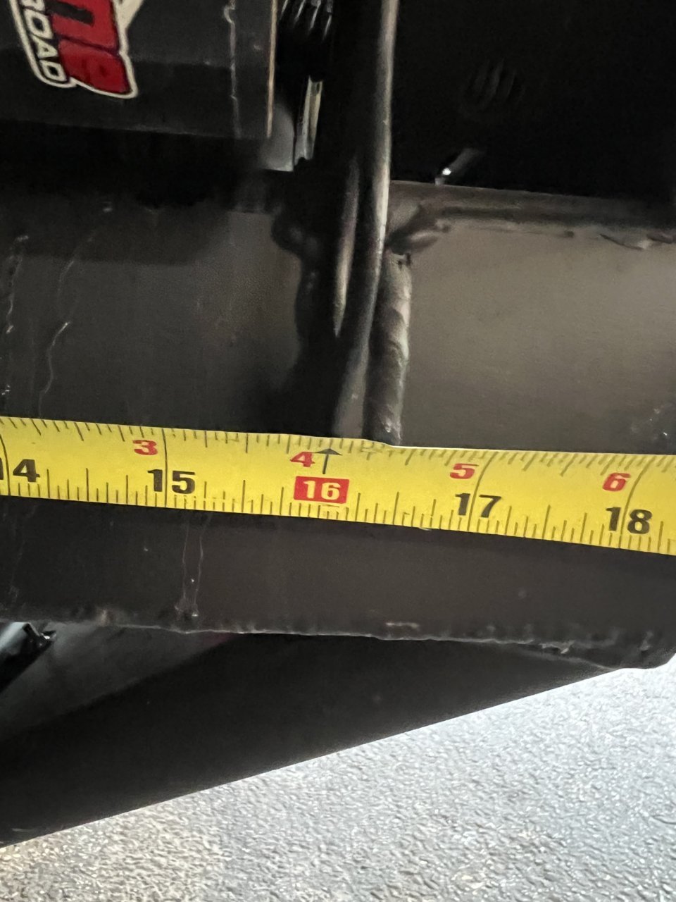

    From the front edge of the coil bucket mine is measuring 16” on the passenger side and 16 1/8” driver side. I have a 3rd gen, not sure if it’s the same. That’s to the back side of the body mount.

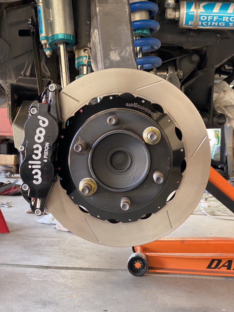

    Added these up front to compliment the wilwood disc brakes on the rear
