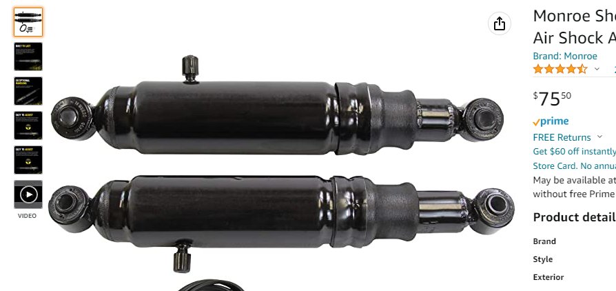

    would be better to just add a second set of mounts to add the air shocks when needed without removing your other shocks….you don’t need a bunch of travel when you’re towing so they dont have to be big long air shocks just some short supplemental add ons

    nah i think a simple air shock would be much easier, get one that has eyelets top and bottom and it's just two bolts, small light super easy. Just add a tab to your shock plate and one to the frame and thru bolt it. Don't need any air lines or on board air just fill right at the shock. If you really just need something to firm up the ass end only when towing or say when you've got a 1000 kg's of Columbia's finest in the bed then just keep it stupid simple... $75 & fill em' with your compressor at home...pop em' off when your done and go braaap

    That would work as well. Personally I’d just make spacers and bolt them in between the hydros and housings. Adjust pressure if needed and go. Lots of ways to make it work

    I am too lazy for all that. I like hitting a button on my phone and having the air magically flow into the bags :angrygirl:

    oh im strictly talking about a DD Taco that you need to tow with a few times a year and then go braaap the rest of the time. i’m not talking about you rich fuggers with two trucks
