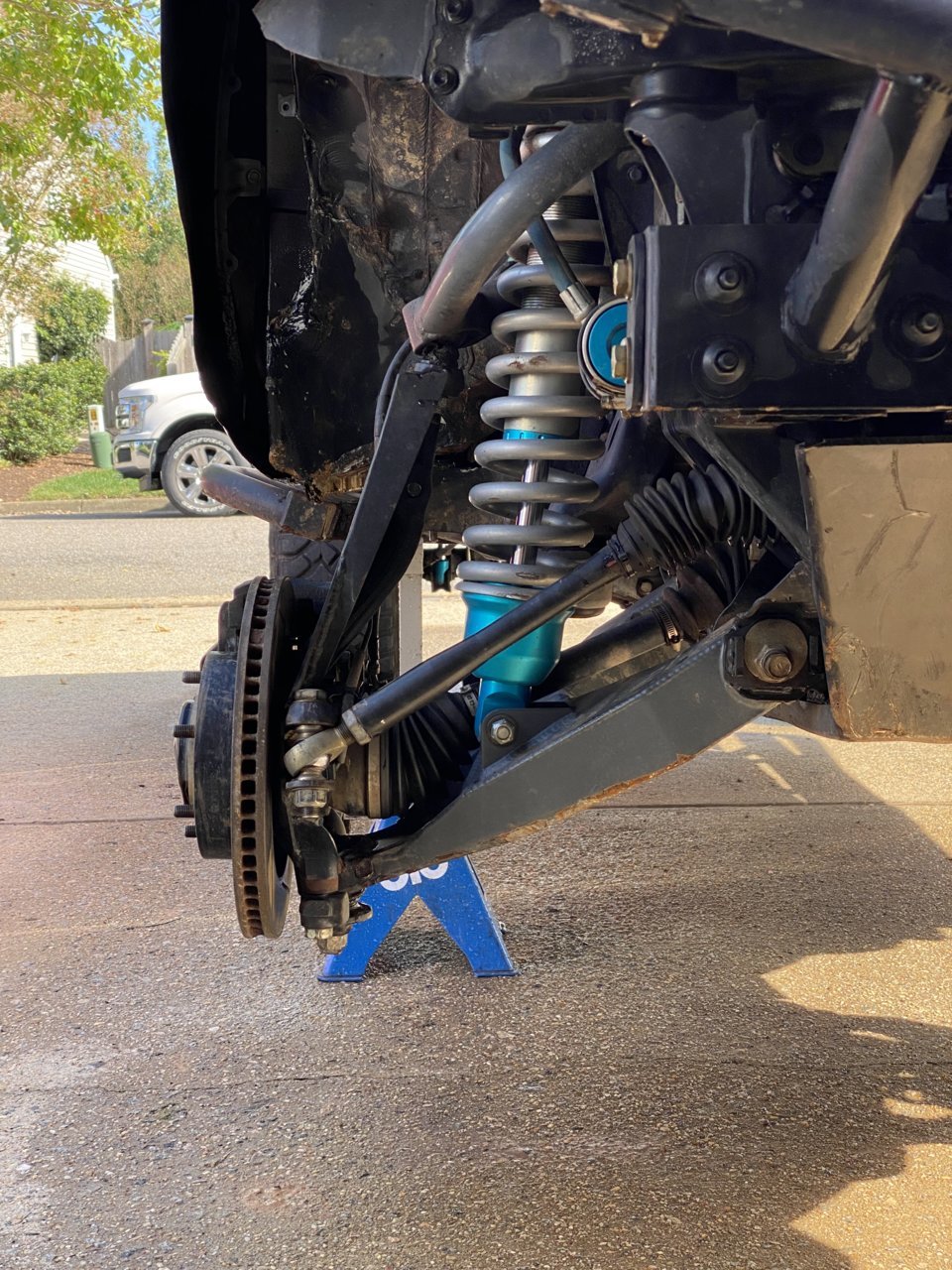

    I thoroughly appreciate the front lip on the LCA seeing as I drag these all over the place. And on the same note, how tucked up the LCA’s are compared to other kits on the market. If you look at some others, you notice a huge gap between the LCA and outer CV joint.

    I love seeing these pics!

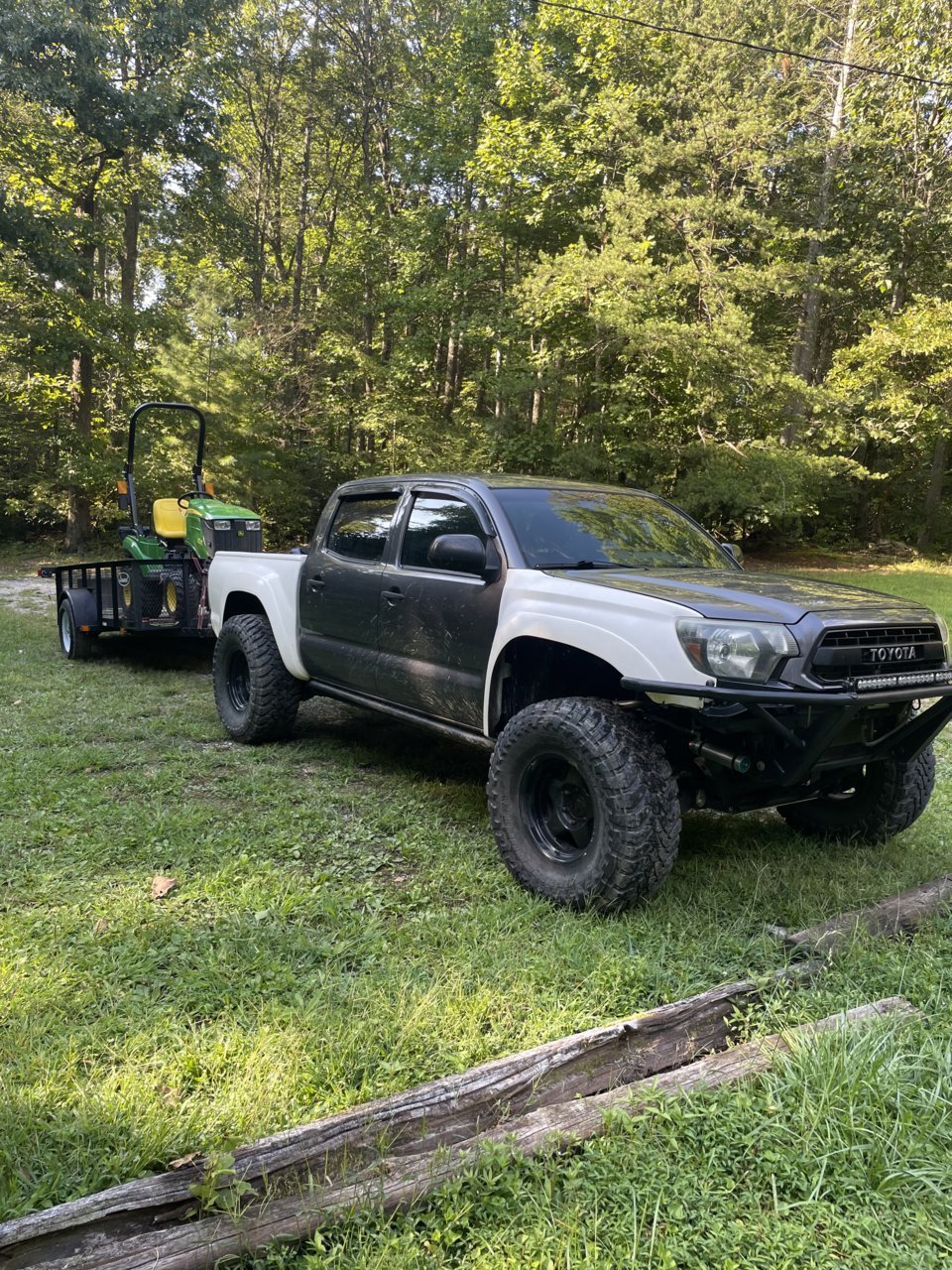

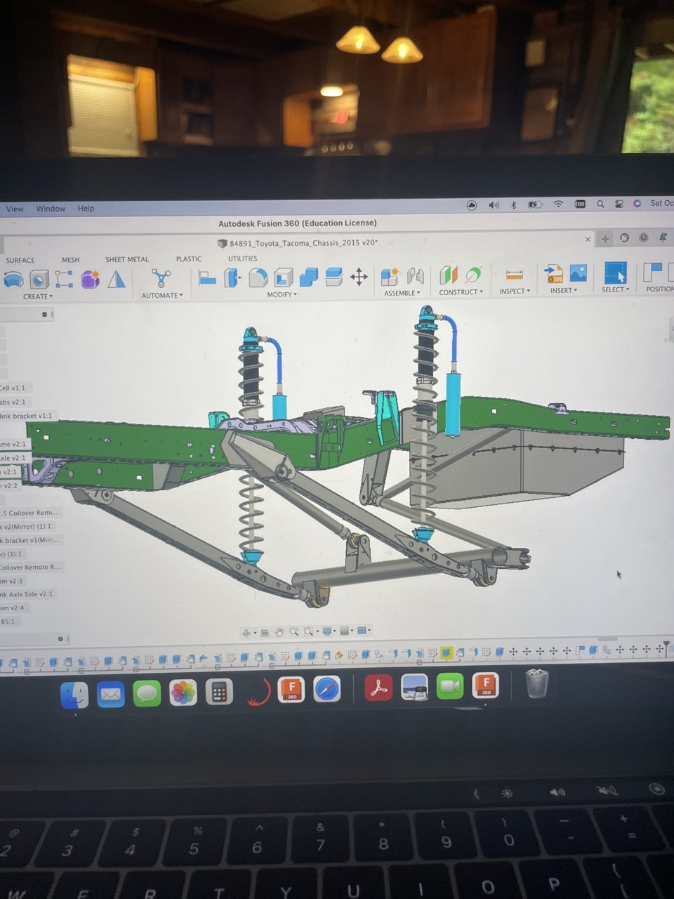

    Just a reference for a basic trailing arm link setup, I have $700 in steel cutting my own brackets out, $500 in joints and tubing, and shocks are $2200. I feel that’s comparable especially when you can buy all these brackets from ruffstuff including trailing arms. But iv got a small plasma table and welder so I’m doing all the work myself. I get the rabbit hole you guys are talking about but it doesn’t have to get that crazy. Tons of budget link options out there, especially a short corse link set up or just a single shock trailing arm in general. I learned a lot going to just one ultra 4 race on how un necessary alot of these things are that you guys are saying is included in a “rabbit hole”. I get a high speed luxury pre runner could be a rabbit hole but most of the people in this thread just ride forest roads and feel the need for a trophy truck level suspension lol. Not hating just throwing some truth. For most people they are not gonna notice a difference between a setup like this and a full back half with bypasses and 32” of travel.
