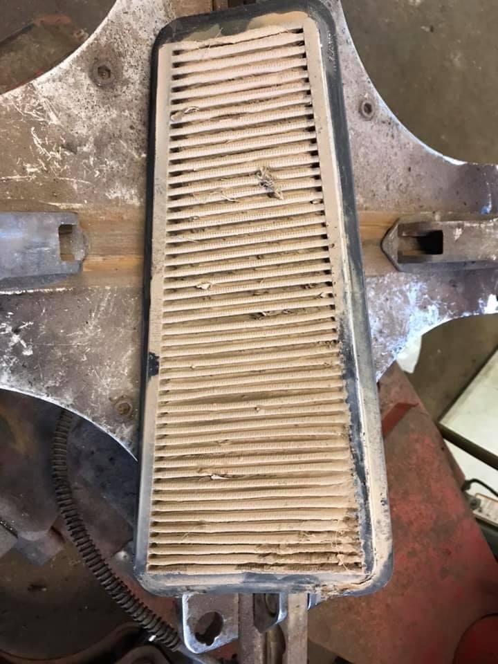

    Lol mine used to throw MAF codes after a day out playing. This is how my filter would look each time. The UMP dumps the majority of silt in the bottom of the can which is really nice. I usually just blow it out every few weeks now.
