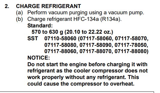

    After figuring out what the sticker looks like (yellow) I don’t see one on my truck anywhere. I can look in the FSM for you though.
    Edit: Looks like 20.10 oz to 22.22 oz

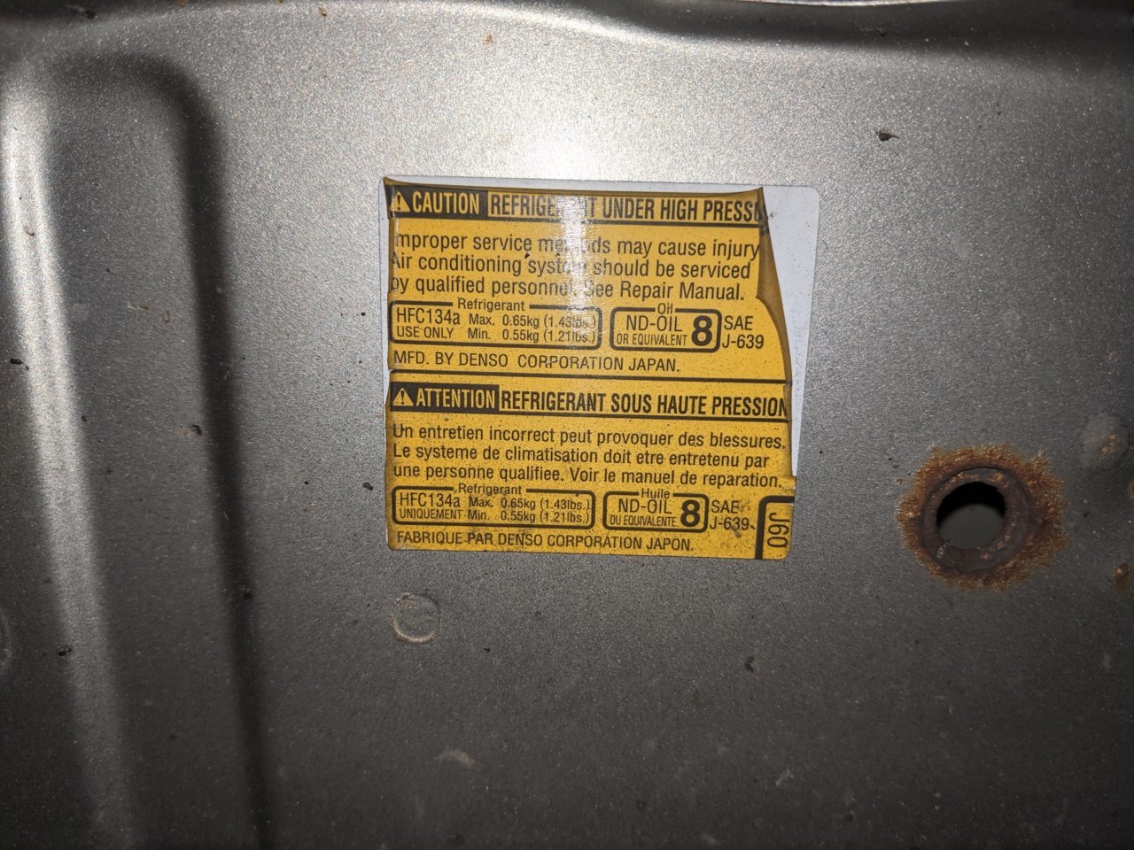

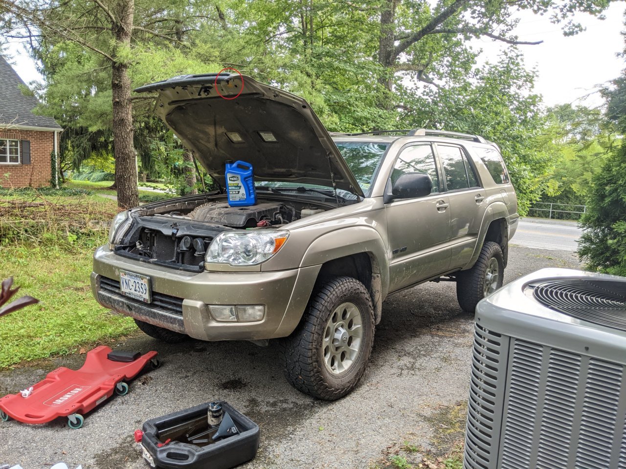

    should be under the hood (edit: nvm I see you already looked).
    Heres mine for 4th gen 4runner with the v6, but hopefully someone chimes in with the tacoma one so you get one thats same-same
