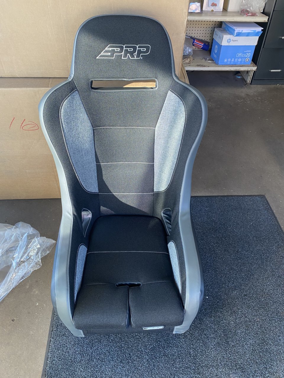

  20. Oct 31, 2022 at 7:46 AM
    906taco
    906taco Well-Known Member
    Jun 22, 2021
    #369289
    3,948
    Cory
    08 Taco
    Podium elites showed up today! Can’t wait to start on the cage and not worry about trees killing me so much, along with eliminating that last bit of chassis flex!
