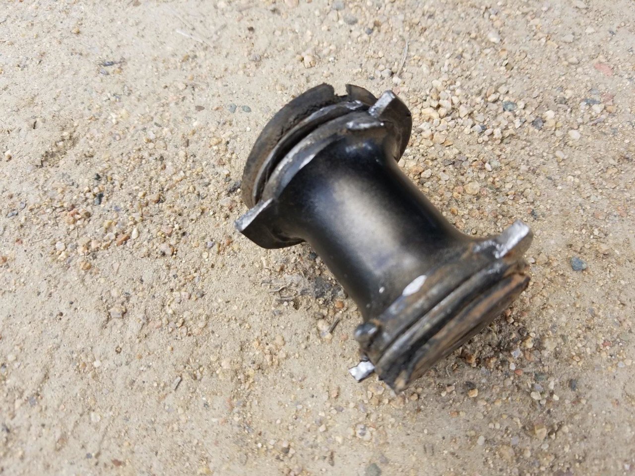

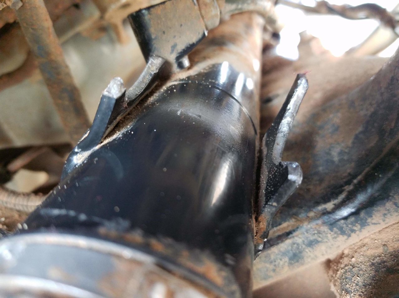

    Anyone seen a rack break like this before? The slide discussed here may have prevented this, or maybe there is a way to beef up the passenger side rack mount/strap additionally?
    Thanks

    I've seen a similar picture, the slide rack should help.

    This is why the slide rack double shears the stock rack. The slide also take a ton of force off the stock rack too

    Is there any purpose in having the rack mounted with bushings, if the slide is mounted solid? Even poly bushing upgrade would flex tons compared to solid. Would it make any sense to also solid mount the rack, or have some sort of solid assembly that holds the rack tight(er), so that the rack and the slide take the deflection load the same? Perhaps I'm overthinking - and the slide is substantial enough to take the majority of the deflection load without tearing the mounts off the frame, as it will take almost all the load if it is solid and the rack is still bushing mounted?
    Feedback welcome, correct my train of thought if it needs correcting. Also, for the record, I'm not trying to bash at all, I'm interested in the kit for myself, but hoping to flush out any potential long term issues or gremlins or questions ahead of time.
