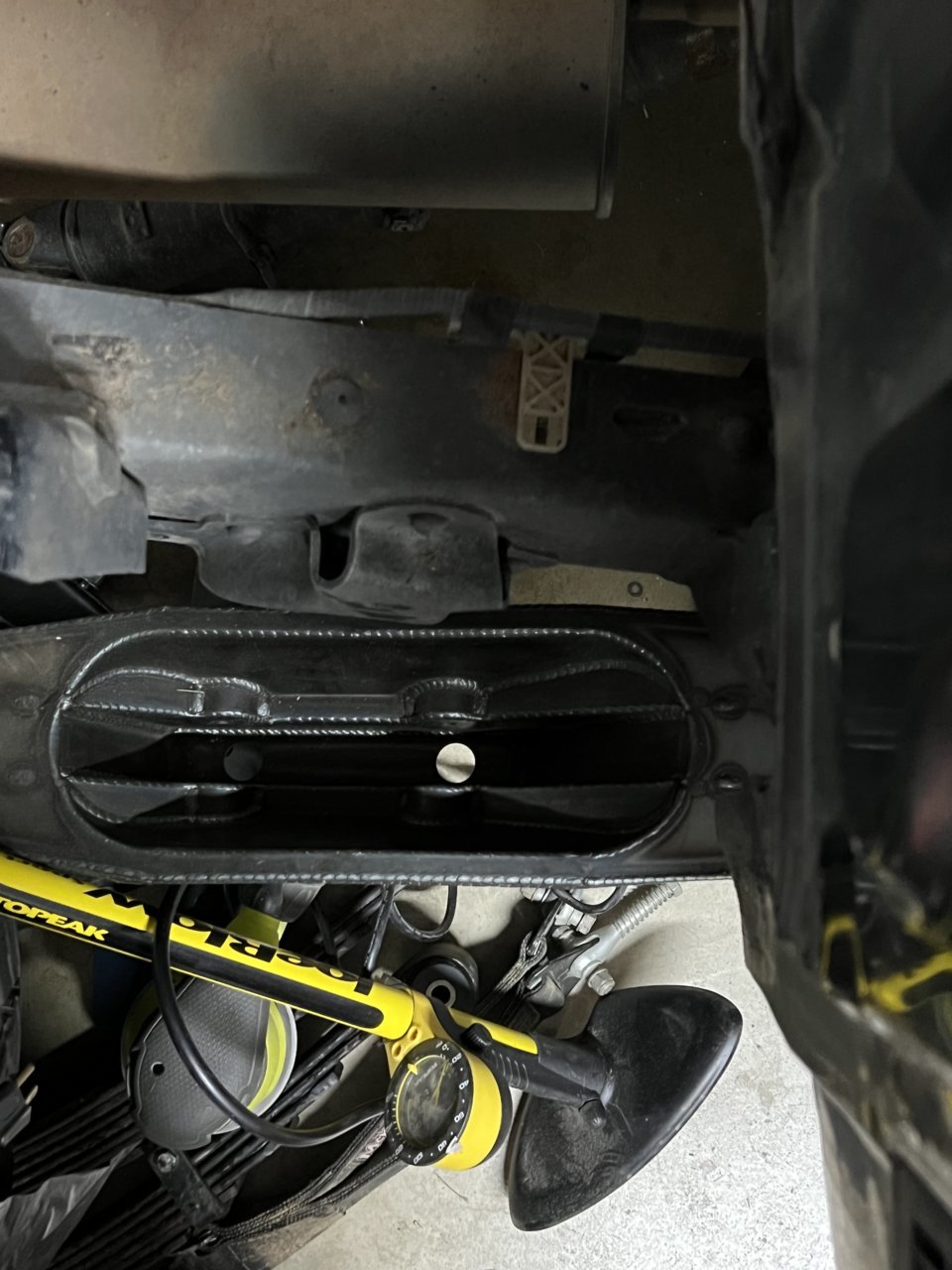

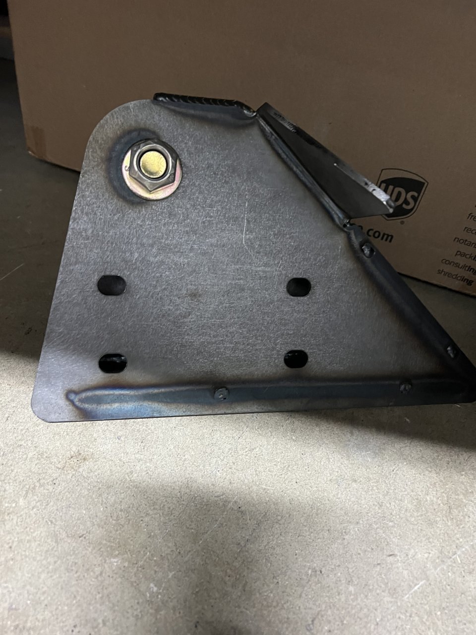

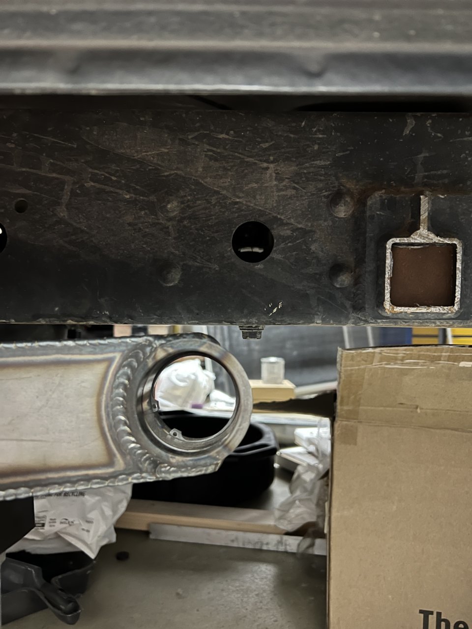

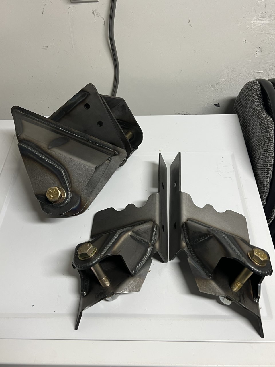

    Picked these up from Harry today. Just got to hold them up to the frame a little while ago. They really have thought this all out. It self locating and seems pretty nearly bolt on.
    They’re really making this 4 link stuff plug and play. Lower link pockets bolt through right where the carrier bearing cross member rivets are. The upper link locates from the underside of the frame.14E83E11-8099-4155-910A-D3130A5AF9EF.jpg B419E4E1-BC09-477E-BFC5-F49BA9B0BEB3.jpg 7D412DA7-2A19-4774-8CE0-8A1C24EDCA6B.jpg
    Hopefully this Friday I can work on mocking it up. I’m shortening my wheelbase from last measured 142” to 132-135” and I’m using their higher motio ratio links, so coilovers are pretty much going into the cab. Just from looking at it right now, I’ll have to do some frame and cab notching, cutting the frame farther back than the end of the cab and the rear cab mounts will have to be completely redone. I haven’t chopped flush with the cab yet, I was lazy to drop the tank so I left it for now and will be cut at least flush with the cab 369A2C76-0777-4D3C-8F8B-D503EE5130A9.jpg
    Using the Tacoma specific links don’t seem to share the same list of hurdles I’ll be facing.
