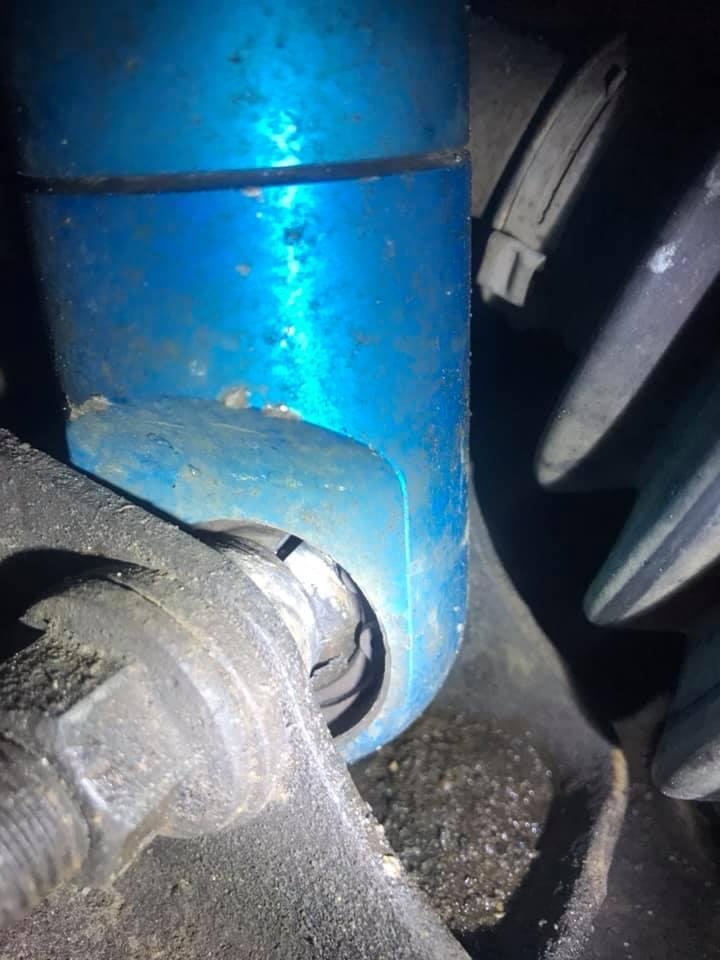

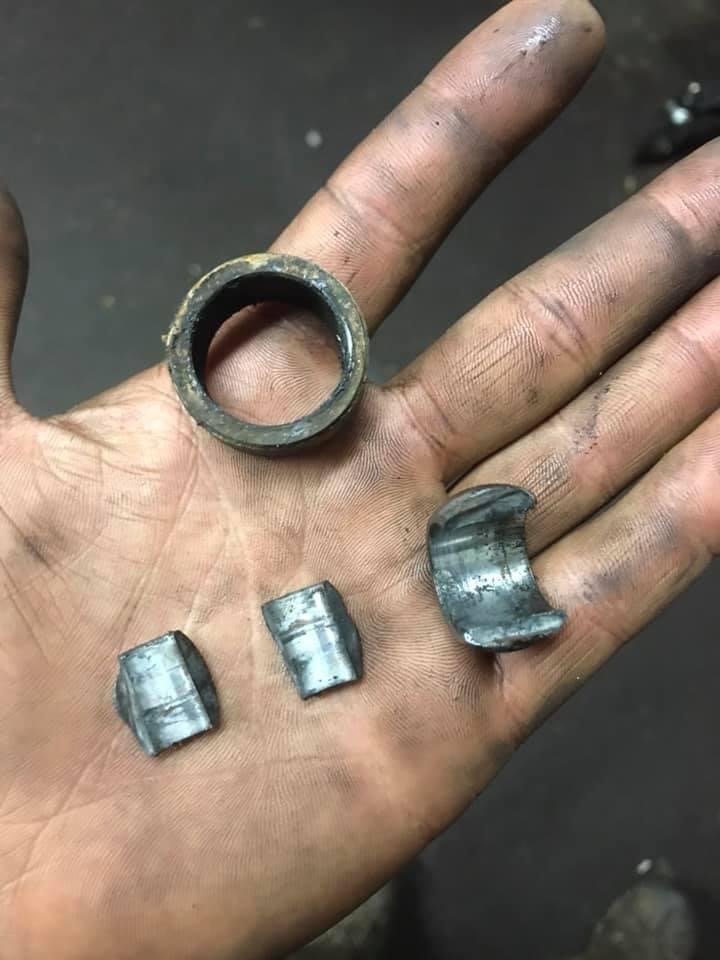

    Besides. WTF are you doing jumping the damn thing with super bumps up front? They aren't even enough for a mid travel setup, I've broken several shock uniballs because of this. They compress WAY too much for aggressive driving.

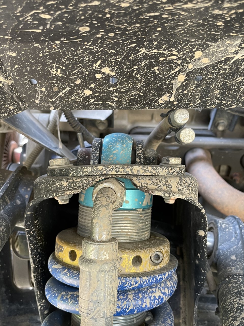

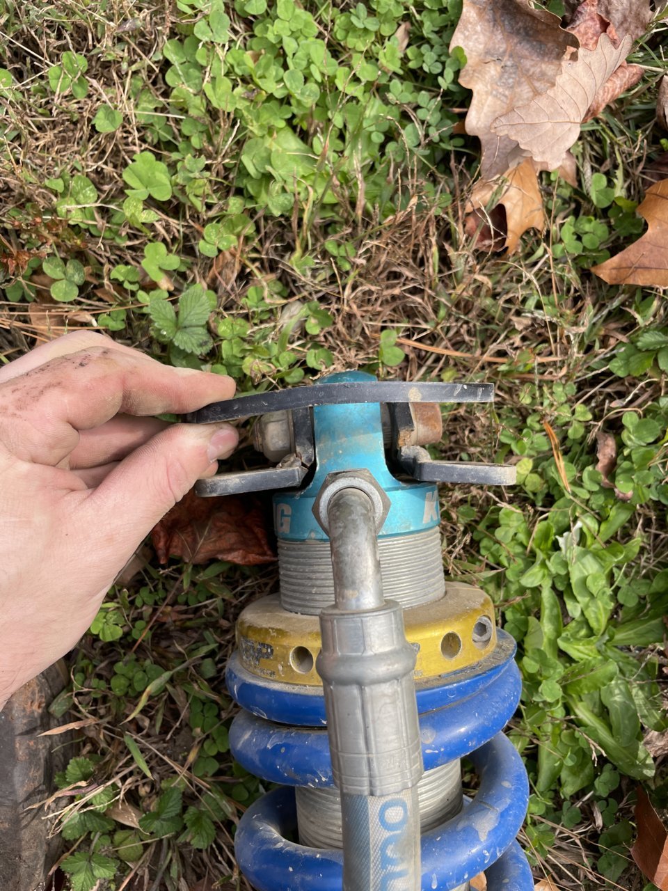

    Damn, what are you doing with these things!? I'm assuming the pic with the Fox is from a different truck? Have you cycled the suspension with shock in place and no spring to check clearance? Very interested in knowing the root cause.

    It’s probably a difference in LCA’s. With a basic mid travel this was happening to me regularly with super bumps. Couldn’t figure it out. Then one day king questioned my bumps. I spaced them down. Problem gone. Super bumps are great if it’s right. Have them on the wife’s truck. But they are spaced down because of previous experience breaking uniballs and ends.

    One thing I would like to add to this convo is with the 2.25 and jd spec coilovers there’s still over an inch of shaft remaining at upper uniball metal on metal.
    I had to add a 1/2” spacer to my super bump to keep the upper uniball from maxing out.
    IDK what kits are on these trucks or if they cycled suspension but just wanted to throw that info out there.

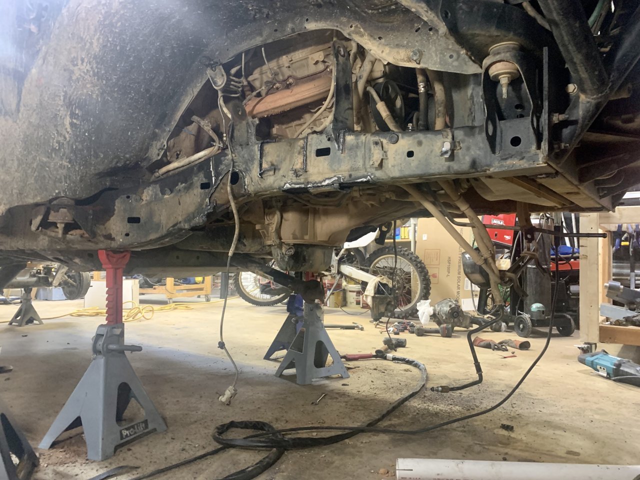

    My whole front end blew off!
    but seriously, after cutting the towers off it’s shocking how thin they are.
