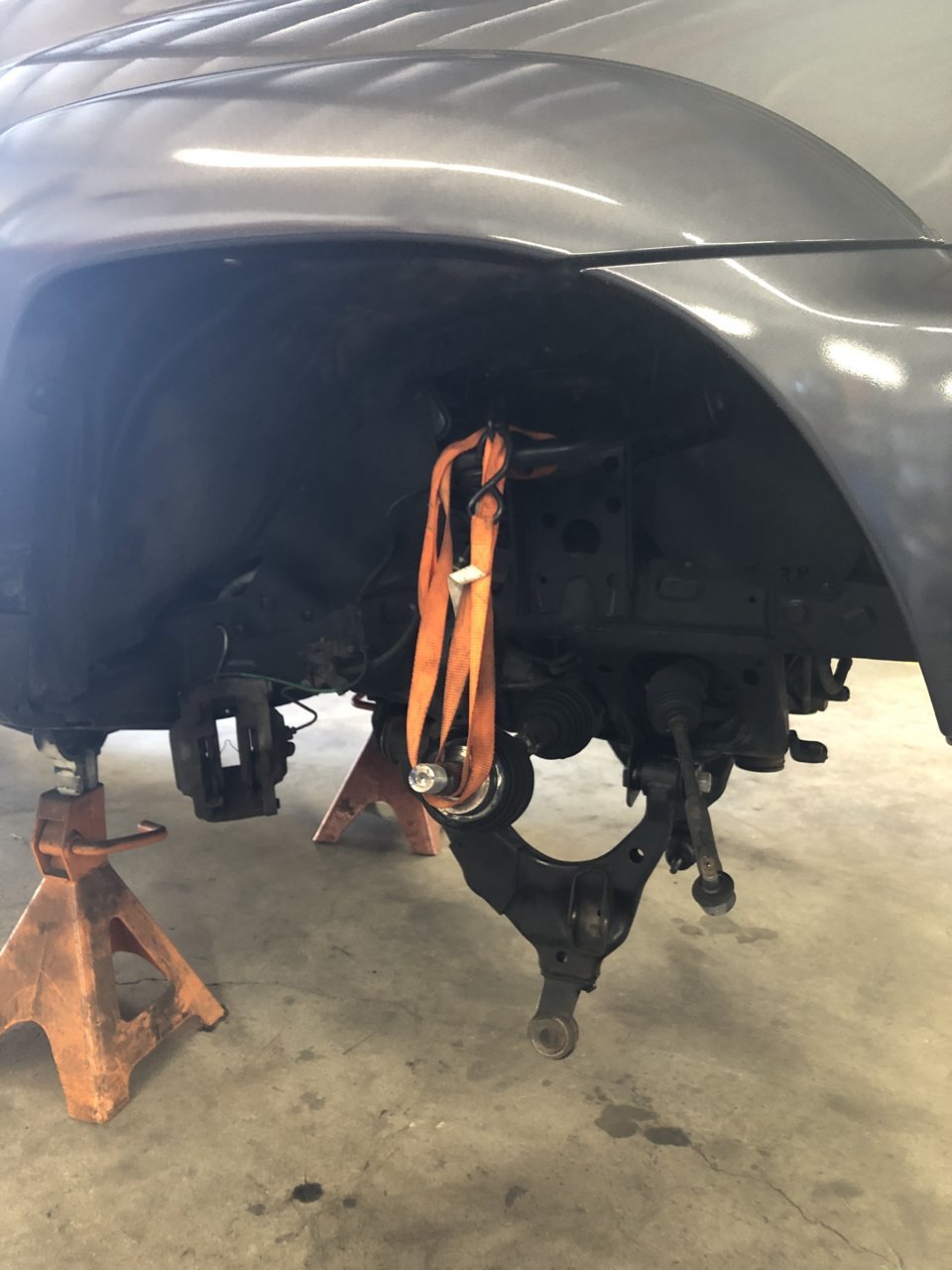

    Just a little improvement :)

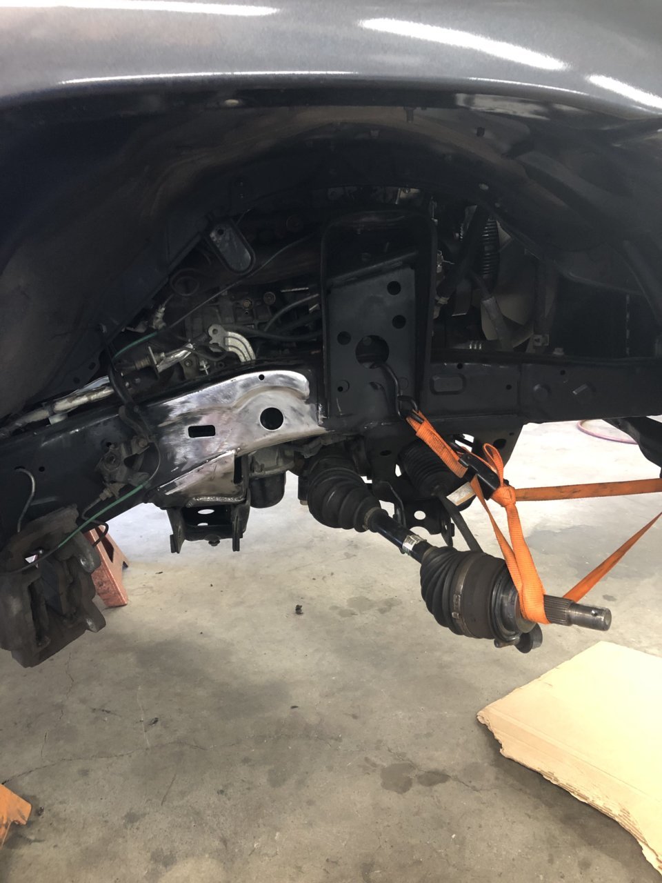

    Started to hack up the front frame rails

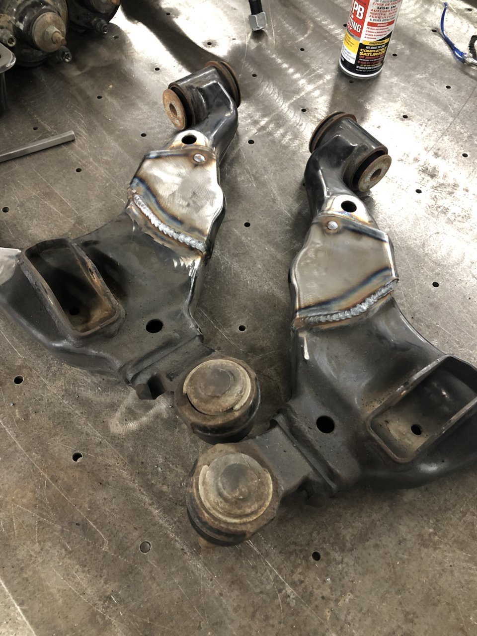

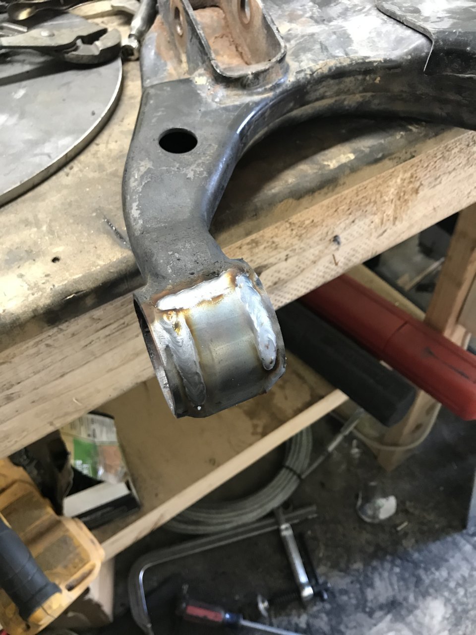

    Started beefing up the lowers

    Where the bushing is, I’ve seen it fail there a couple times. On my lcas I wrapped some 2x0.125 around the bushing eye and tied it into the arm.

    Lol, I’m cutting out plates as we speak for the bushing pockets!

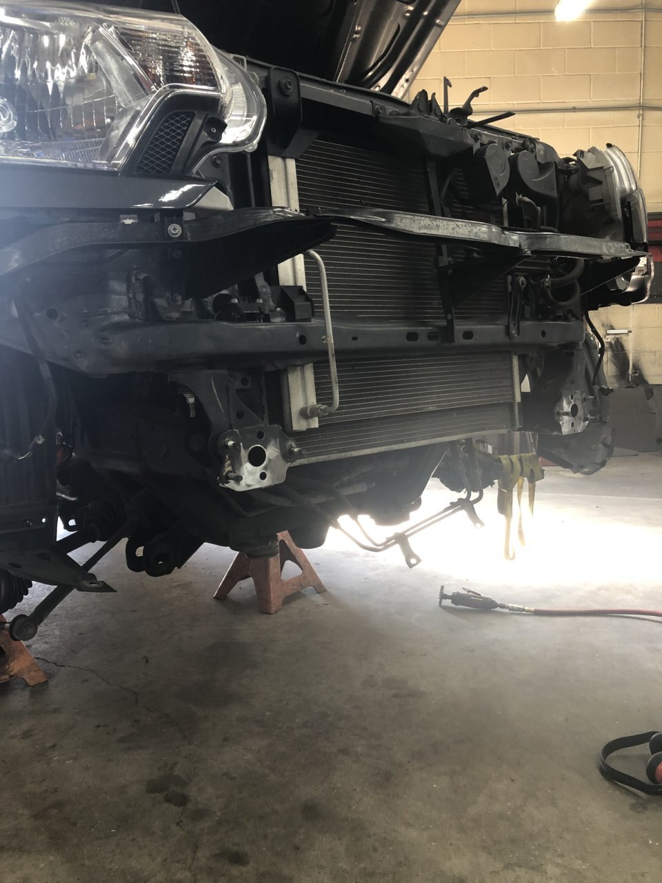

    I am replacing the aluminum crash bar with a fabricated steel one and tying the skid plate into it and then going to run a single tube coming out through the stock bumper cover... “push bar” as the trophy truck guys call it

    Spent some time on the new front bumper/crossmember...

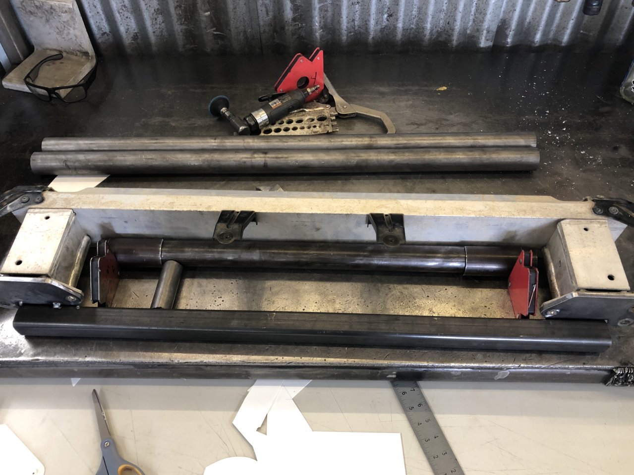

    OEM bumper cover mount jig’ed up
