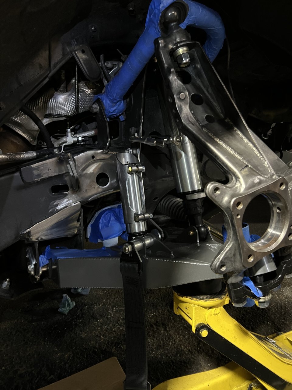

    How much shock shaft should I have showing at hard bump? I’m setting it up with 1” left showing on the shock, upper uniball is not in bind and still has a little room to allow for frame flex. Same with the straps, setting them up with the shock stopping 1” before full droop. Sound right? So these bumped and strapped net something like 10” of wheel travel ish?

    The rubber bumper on the shock shaft is not included when measuring shock travel. Personally, I would set bump based on off the ball joint. If you bought the shocks from JD you shouldn’t have to worry about the shock bottoming out.
    You have the right idea of leaving enough travel for frame flex.

    Shocks do not bottom out but the uniball is the limiting factor on full compression and extension. At hard bump the shock would need to move 5/8” in before the uniball binds. Just trying to get a reference as to how far away those numbers should be. Thanks

    Watch your outer steering rod end also. It may max out before the upper ball joint does.

    Good call, it’s close but not maxed out at full droop. Might need to move the strap from the bottom hole to the centered hole on the tab as a precaution.
