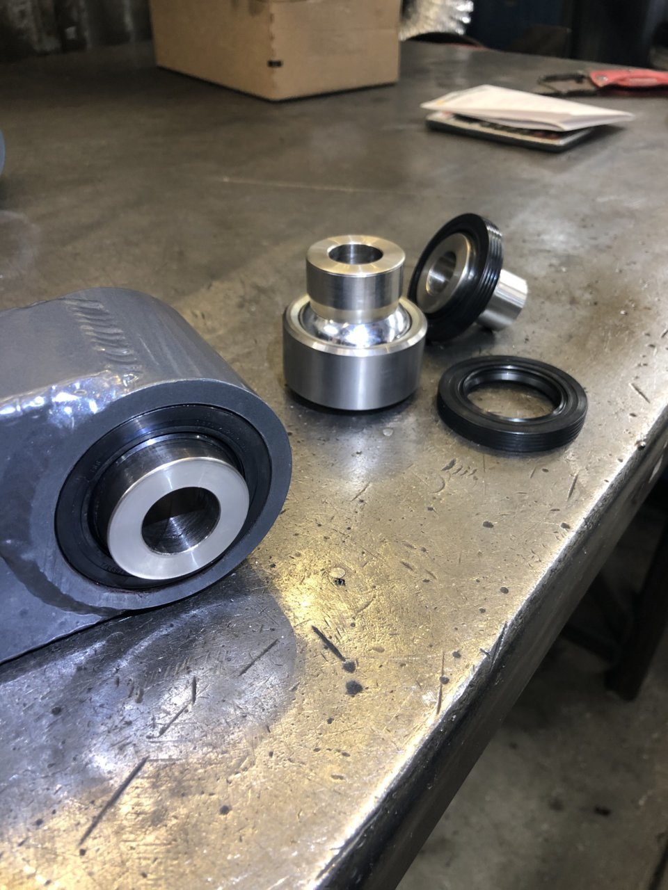

    So here is the solution to keeping the uniballs free of mud, road salt, grit etc.
    We had custom misalignment spacers made that allow axle seals to be pressed on so nothing can get to the uniballs

  16. Apr 30, 2020 at 8:05 AM
    #1616
    Nimble9
    Nimble9 visit squareonecreations.com Vendor
    Oct 20, 2015
    #167184
    11,153
    Lebanon, PA
    2006 4x4 DCSB
    enough to have fun
    now THAT is an idea!!!

  19. Apr 30, 2020 at 9:08 AM
    #1619
    81Trekker
    81Trekker [OP] Well-Known Member
    Aug 25, 2019
    #303299
    3,750
    La Jolla SD
    81 Trekker and 2015 CCSB Tacoma
    Too many to remember
    Did it specifically for @ovrlndkull because I know how much he like the mud!
