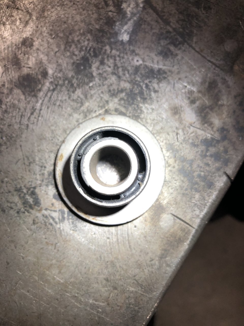

    Post the video, show us the problem please! I already had rack movement with aftermarket bushings, had success with whiteline bushings and reaming the frame and bushing sleeve to fit 1/2" bolts instead of the 12mm stock bolts that had a 11mm shank, allowing the whole bushing sleeve to float side to side on the bolt - causing the steering wheel to change angles for what is straight driving.

    Isn’t part of the problem also the stock bolt shank diameter? Iirc it’s thinner than the threaded part, thus relying on torque of the bushings/sleeves to keep the rack in place?

    Yes this is what I experienced.

    Yes, our kit comes with different hardware that’s shanked correctly

    I had the same thing on my old rack. Only noticed when driving on the freeway when the wheel was centered. After putting the slide rack in with a new rack and pinion it went away. So not sure if it was the bushing being worn out or the gears. My money would be on the bushings though.

    I changed mine out to poly a while back. Would it be worth it to change mine to these nylon?

    It is hard for me to see the physical way that the bushings would cause play in the center of the steering only, unless the bolts holding the rack to the frame were loose, or the rubber in the bushings was completely dissolved and non existent - but still, that would have impacts everywhere not just center I would think. If the rack shifts on the frame due to the bolt shank issue, the only thing that happens is the steering wheel becomes crooked for a straight drive, wrestling the steering wheel all the way to lock could sometimes bring it back some until it got knocked one way or the other again. I also had a lot of clunking in the steering system, like the steering wheel would shake and clunk on cracks and manhole covers and small bumps and such... it gave a lot of feedback that I could hear and feel in the steering wheel.
    But no matter what, the mesh of the rack teeth was tight, tiny steering input was exactly felt in the steering of the truck.

    You don’t feel the play when the wheel is turned because the bushing has already been squished / loaded. My oe bushings were horrible like that too so i switched to the energy bushings years ago but they get soft after a few years too so these nylon ones are the way to go imo

    Ahh... OK I can see that situation now. My stock bushings never had that problem, but when I put in Energy black poly bushings I had nothing but problems from day 1 with the rack shifting side to side. And it wasn't a lose or play sort of thing, it would get knocked off center one way or the other even when the bolts were tight, either from a turn to lock with pressure, or from a general impact from bump or offroading. Result would be a 11 or 1 o'clock steering wheel when the truck was straight. Solved my problem with a whiteline bushing kit (one piece sleeve instead of two like energy), and 1/2" through bolts that fit snug in the frame and in the bushing sleeve. Perfect ever since for me, but I'm not doing the stuff you all are, and not wearing out or breaking the actual bushing itself.
