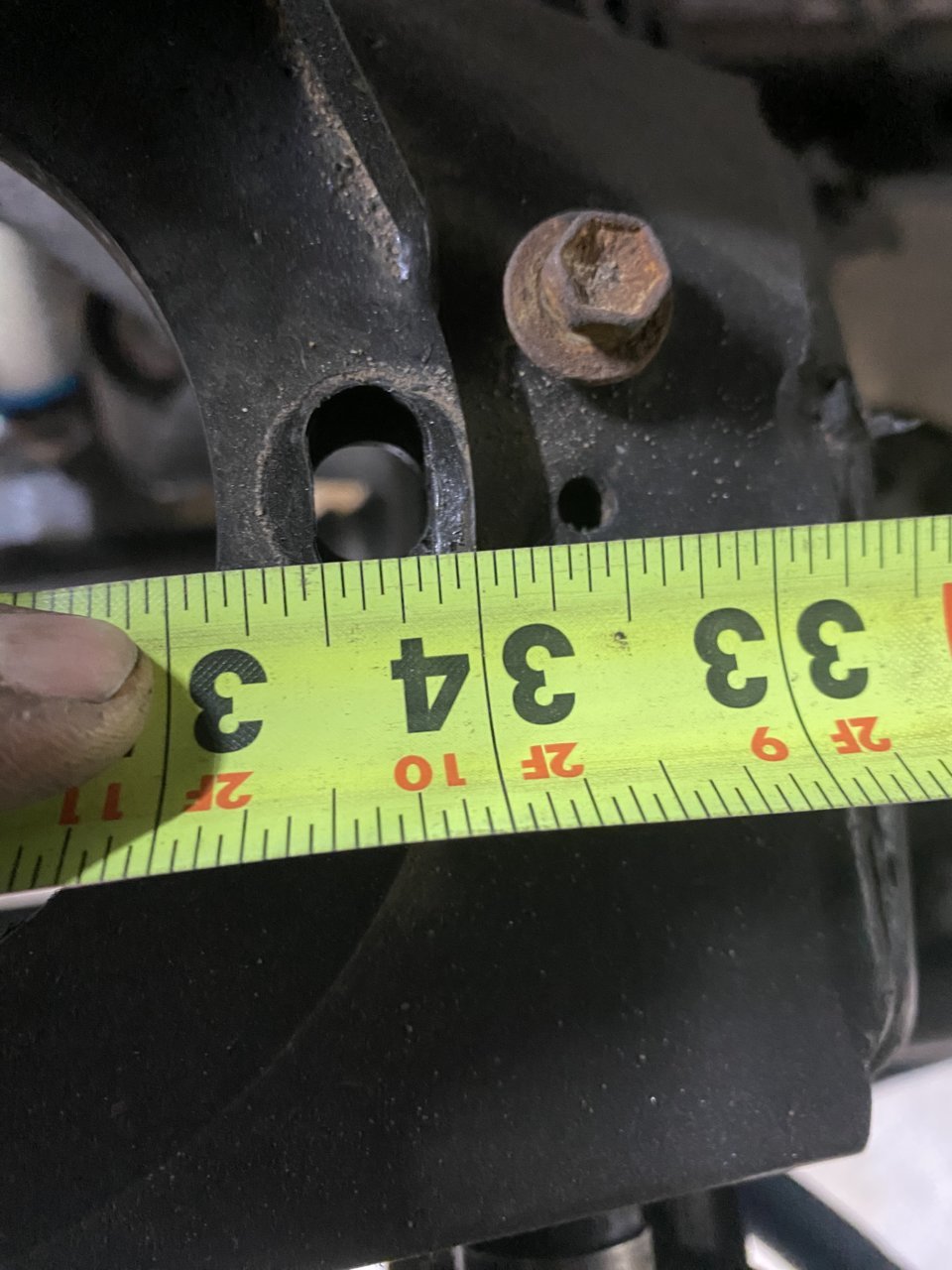

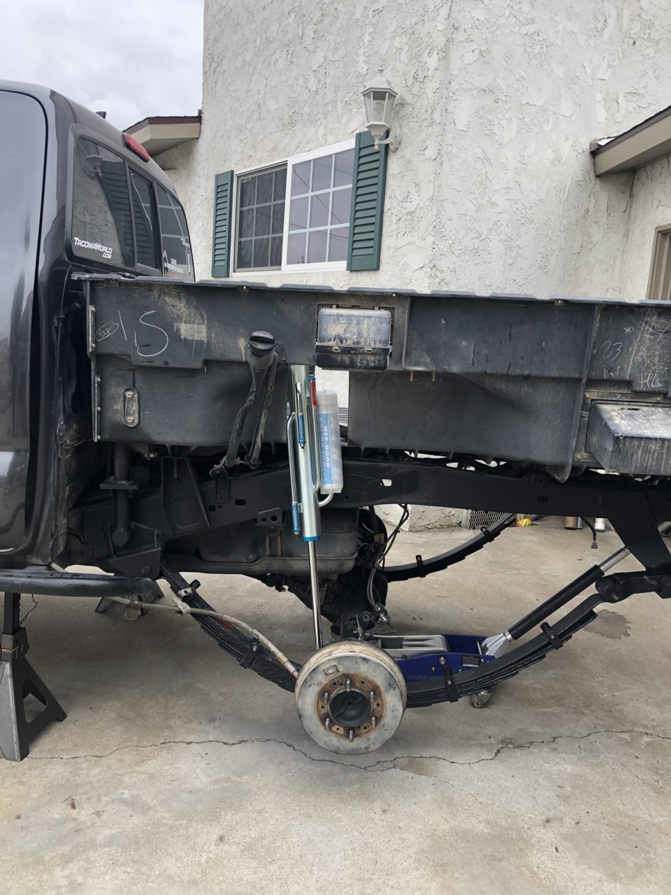

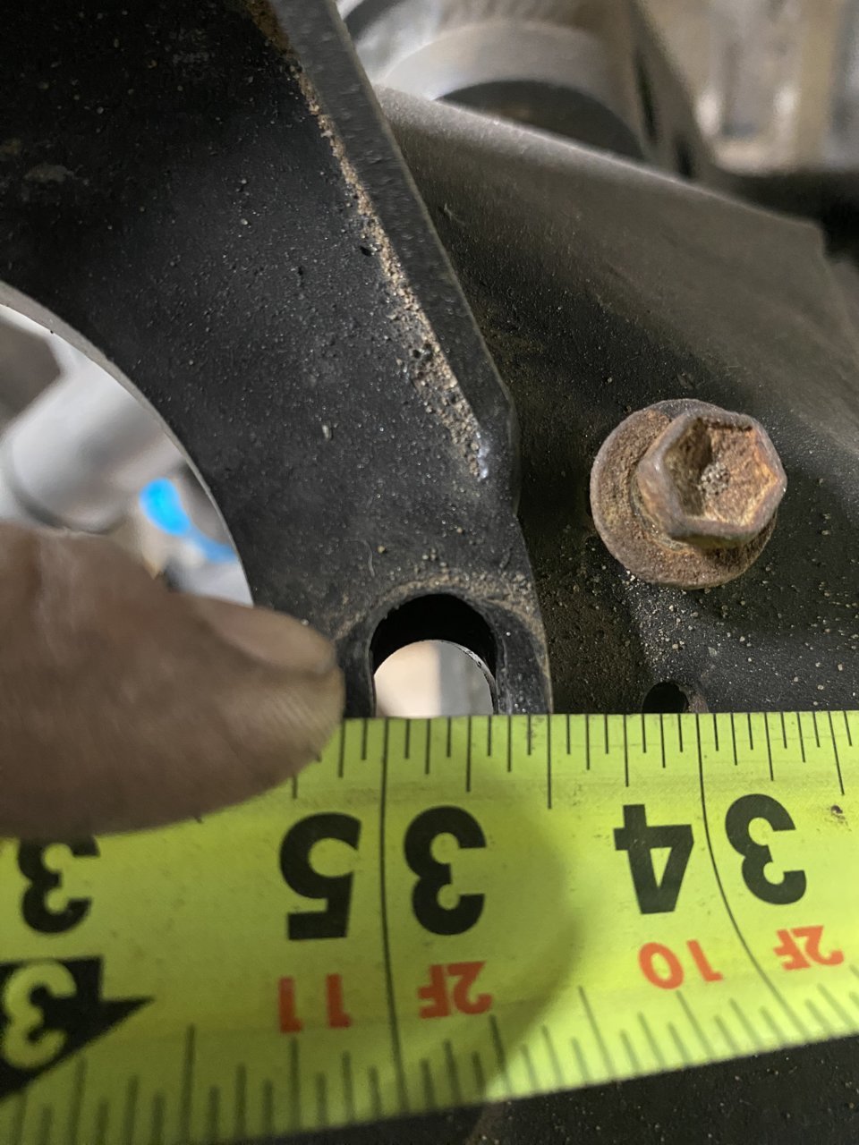

  14. Dec 21, 2022 at 4:11 PM
    906taco
    906taco Well-Known Member
    Jun 22, 2021
    #369289
    3,950
    Cory
    08 Taco
    Check this out gents. Picture 1 is almost all of the weight set on the ground. Bumps fully engaged but the lift wouldn’t go low enough to put all weight on the bumps. Picture two is full droop. This is WITHOUT an engine, trans, interior, inner fenders yada yada.

  15. Dec 21, 2022 at 4:41 PM
    EatSleepTacos
    Mar 24, 2015
    #151688
    59,844
    Randy
    West Valley, AZ
    2017 4Runner
    To clarify for anyone else I think Cory is showing the deflection between the two coilover towers. Took me a minute to figure out wtf I was looking at.
    Torspd and Supra4x4 like this.
  16. Dec 21, 2022 at 4:44 PM
    906taco
    Jun 22, 2021
    #369289
    3,950
    Cory
    08 Taco
    You’re correct. I should have been more specific.

  18. Dec 21, 2022 at 4:59 PM
    906taco
    Jun 22, 2021
    #369289
    3,950
    Cory
    08 Taco
    Oh I’m well aware of it and have been. Just wanted to take some time tonight to play around since it’s easy with no engine in the way. It’s probably pretty ridiculous when you factor a nasty crack off-road.

  19. Dec 21, 2022 at 5:07 PM
    WormSquirts
    WormSquirts Armageddon
    Dec 18, 2015
    #172583
    2,924
    Braeden
    BC
    That's crazy, I bet they get another inch closer when actually wheeling
  20. Dec 21, 2022 at 5:08 PM
    906taco
    Jun 22, 2021
    #369289
    3,950
    Cory
    08 Taco
    Easily an inch more. Like I said, this still wasn’t full weight on the ground. And missing like 1,000lbs up front lol
