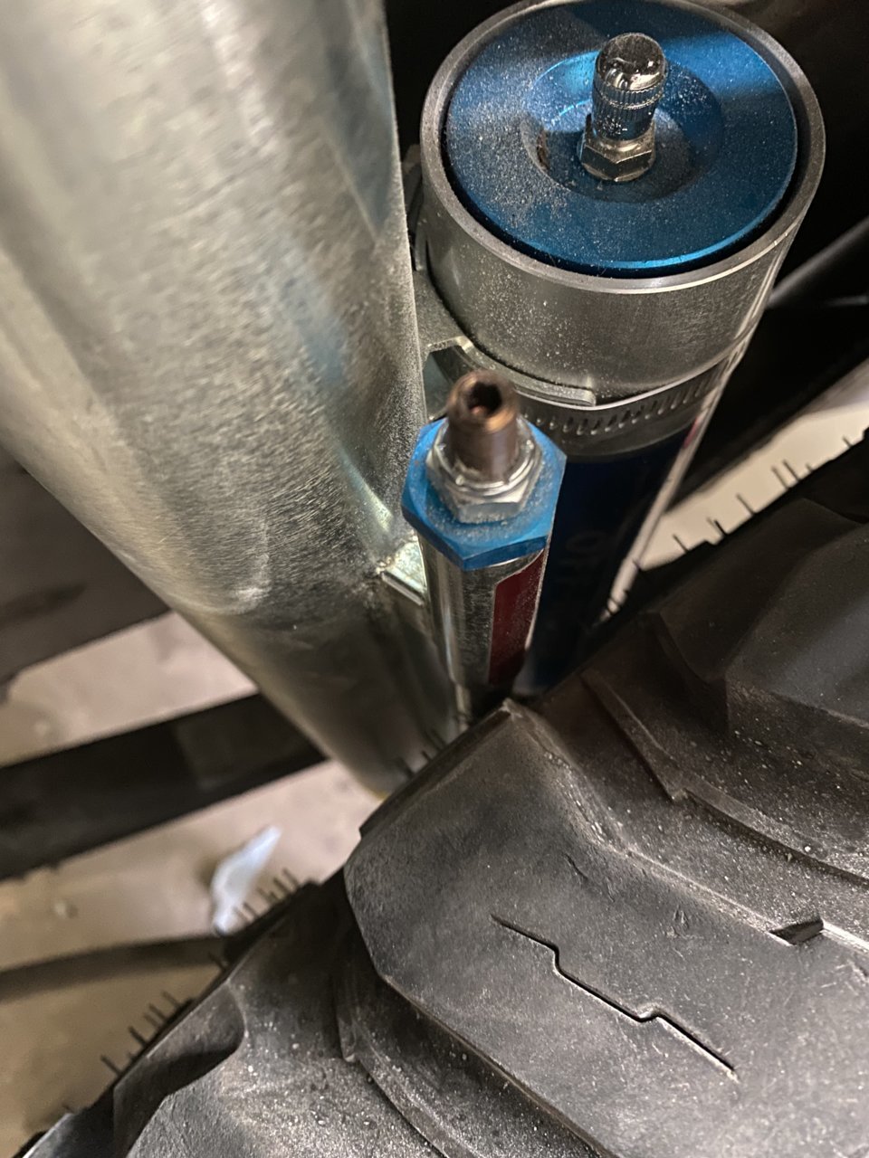

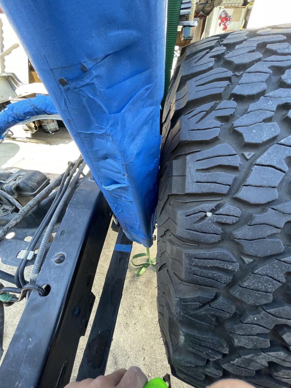

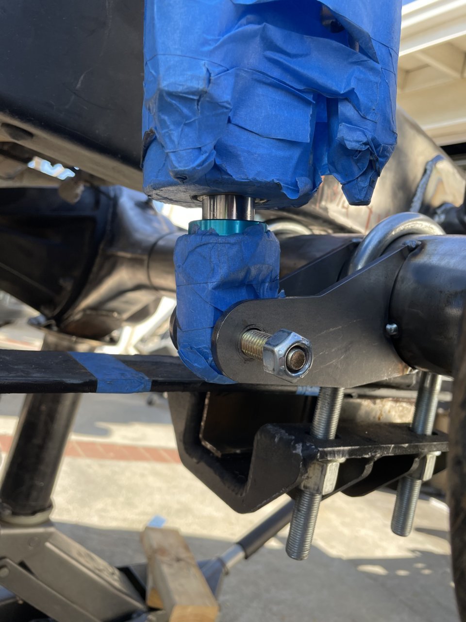

    I’m setting up my sua with 3.0's currently my 315/75/16 are touching with a little articulation but I think it’s due to where I placed my shock mount so I’m just going to move it over a bit and check clearance.
