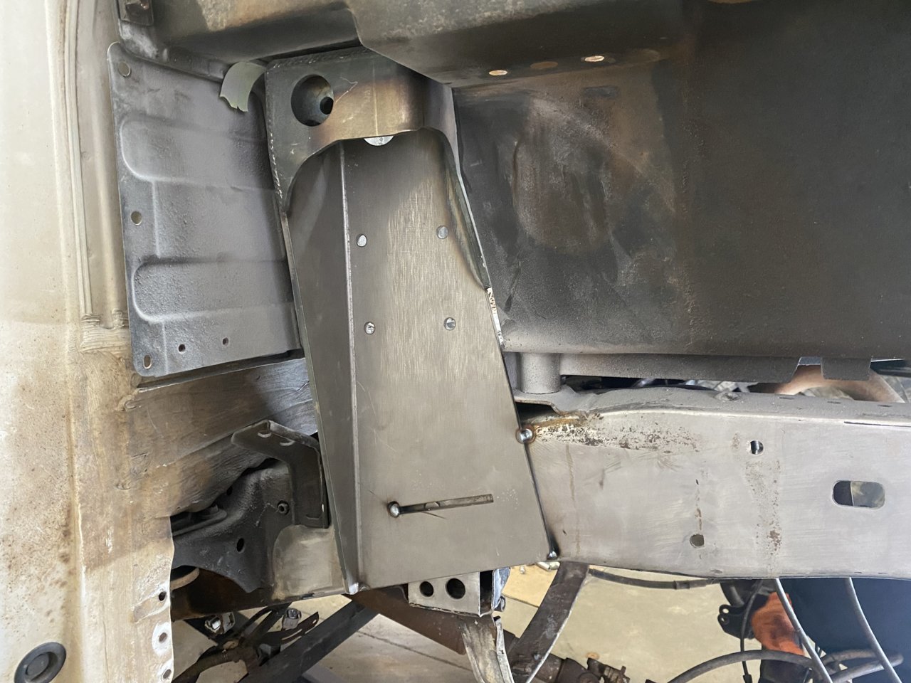

    Been working on installing a set of the frame braces. Thought it would be a simple project that would take two or so days. Turns out I was wrong, per the usual and the project has taken much longer. More so due to time constraints and unforeseen hurdles than the design itself.
    Regardless, I've been making progress. The brace is fairly well designed and is a "bolt on" product. That said, you may have to finesse the braces onto the frame on a truck that has been used as there is obviously a lot of movement in the frame. The brace bolts to the factory bump stop mount holes so you do have to figure out a new bump stop configuration. I already had hydros in custom mounts so I simply got new cans and made new gussets, welding the new can directly to the brace. Pretty happy with how it's turned out so far but only time will tell how well I cycled.
    [​IMG][​IMG]
    I did find that I had to notch the brace to fit around the body mount bracket. The brace was designed on a AC and although the contours of the frames are the same between DC & AC, there are mounts that vary in location. It was either I notch into the body mount bracket OR cut the brace.
    Lastly, the brace will create a hurdle for guys running sliders. The brace bolts to the frame underneath the cab, which is great for integrity but I am going to have to figure out a solution to run my sliders in conjunction. I personally run the Pelfrey bolt on sliders so removing them was easy but I will have to modify them to get them back into place. As of right now, I'm thinking I'll just weld the last leg directly to the frame brace but I'm open to other solutions.

    Just to clarify for everyone we have never used an access cab frame for any of the design. We only have a frame scan of a DCSB which we use for all desings. We notch the cab mount slightly rather than the brace to maximize the cross sectional area of the brace.
    Thank you for being one of our test dummies :) and we will have detailed, install instructions to make the install easy for everyone else.
    For those watching along when we come out with a new product we typically give them to certain members to install (with no real instructions) in order to get some real world feed back on what we can do to make the installs easier.

    My mistake. I thought I read a few pages back that the brace was designed on an AC. Maybe I'm confused over the conversation of when you installed in on the shop truck. Regardless, I contemplated notching the body mount instead but chose to go this route. Hopefully my decision doesn't have too many negative effects. haha.

    I found the limited amount of room between the gas tank and frame to be an issue to get the nuts on the inside of the frame and ended up dropping the gas tank. You could have likely had success with removing the bed but I didn’t have the man power or space to do so.
    It also doesn’t help that I already have my frame boxed with the DMZ kit so access was very difficult. I made it work though.
