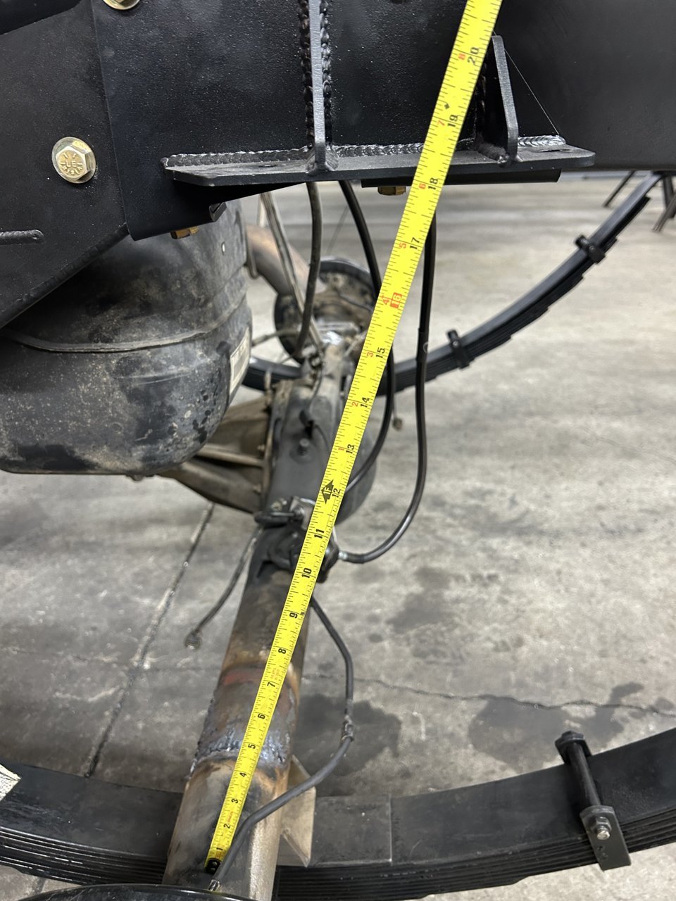

    18” metal to metal… will easily go 19” with a frame notch

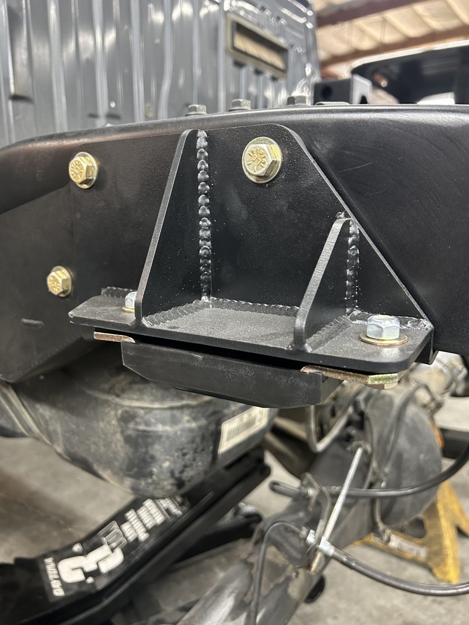

    how do you set the bumps up? They attach to the frame brace or mount to the axle?

    like dis

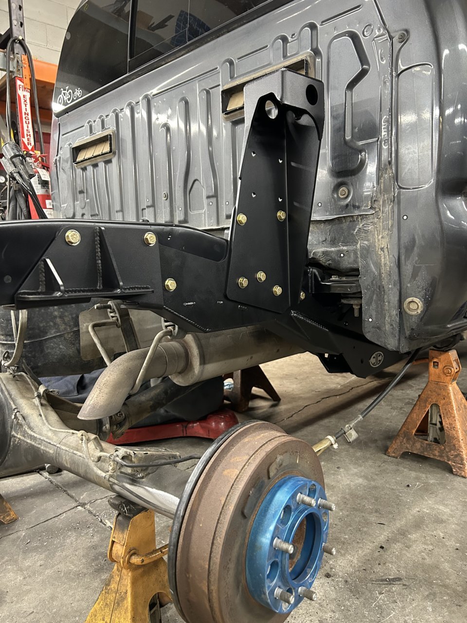

    Are these bolted through existing holes? Could you run them without the frame brace on a DCLB?

    Yes they bolt into the factory holes and yes the can be run without the brace and yes they will eventually be for sale as a stand alone item

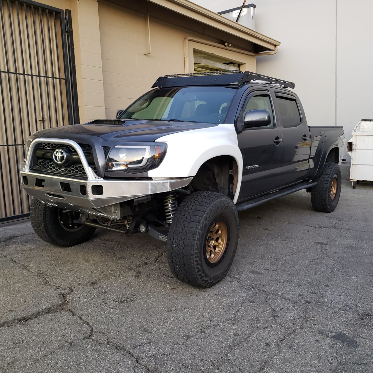

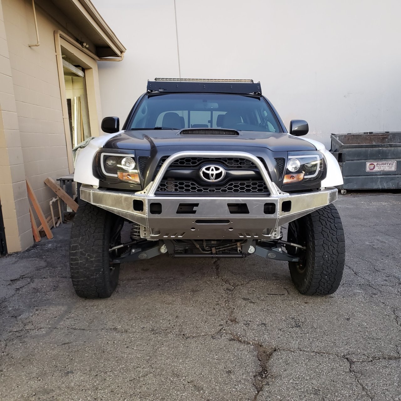

    Needs a few tweaks but finally got the aluminum bumper installed on the truck! Thanks @81Trekker and @desertjunkie760 for the help and advice! Looks pretty sexy with that JD fab goodness underneath! :headbang:

    Are you going to add anything to the sides to match up with the fiberglass fendies?

    Yes, that’s the tweak I wanna do to it. Add a bit of material to flare it match the glass a little more, and then the edges need to be trimmed, it pokes into the wheel well because it was meant for stock fenders. Other than that, the aluminum feels like driving without a bumper still!
    Edit: Only big con is the cost. Little less strenuous if you are talented to weld it yourself. But assembly almost cost as much as the bumper itself.
