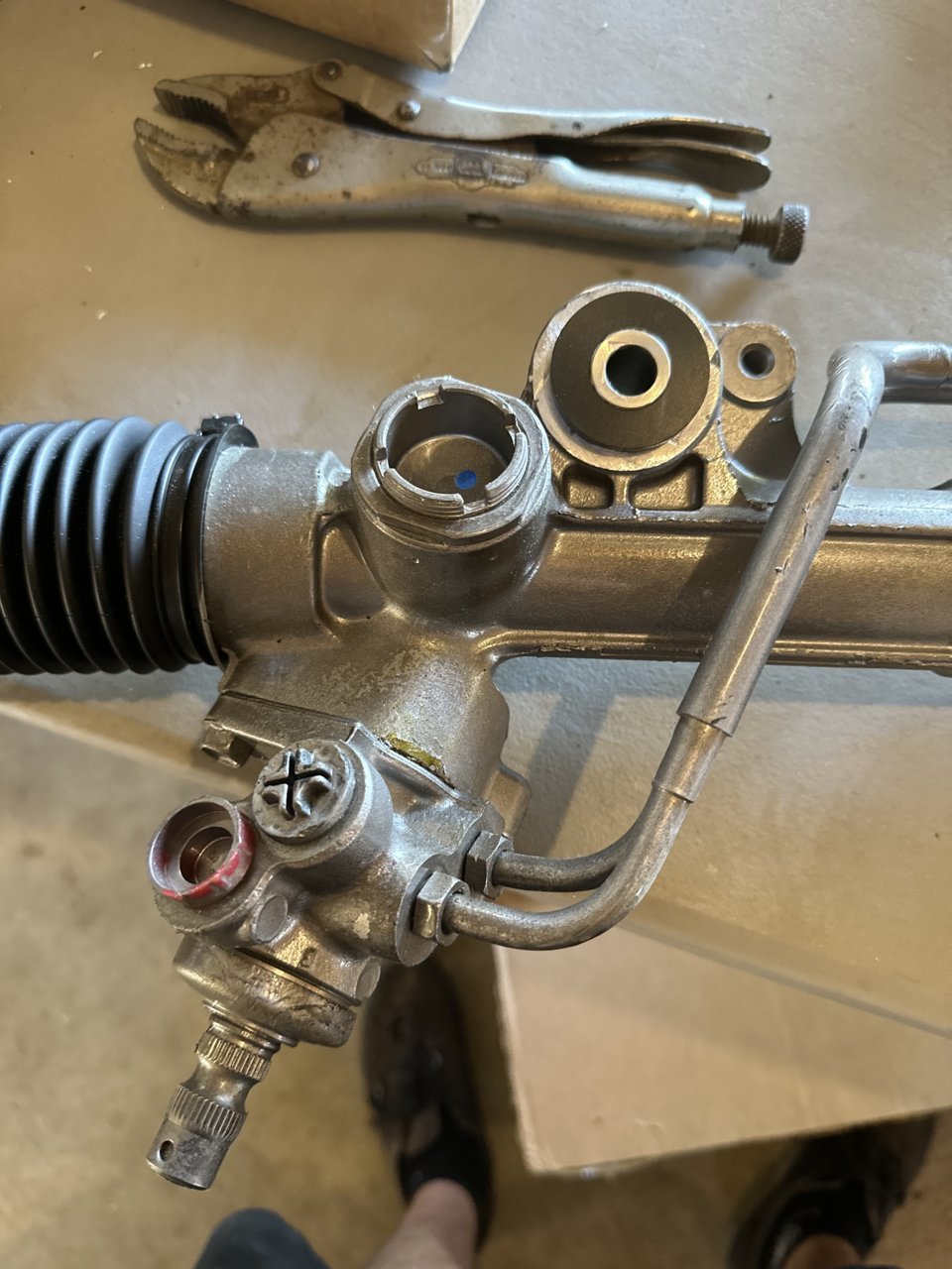

    Those don’t look fun to remove. I used bushings even a pain ?

    Those were technically “new” bushings or reman I am assuming. They were very annoying to get out, older ones might be a little easier to get one, these ones had like 0 play so that definitely made it harder

    Are the JD bushings designed to re-use the stock mounting bolts? Then if so, and unless you also have the slide rack, you might still have the rack shift on you like so many with poly bushings report. Stock rack mount bolts are thinner at the shank than the threads, so the bushing sleeves aren’t tight to the shaft which then only leaves bolt torque on the bushings hats to keep the rack from shifting on the frame bosses.

    "The soft rubber factory bushings are hollow in spots and allow for a large amount of rack deflection. To eliminate the deflection we have machined custom nylon bushings with stainless steel sleeves and washers. We then include hardware with the correct shank in order to properly secure the rack to the chassis."

    So this thread has what I would call all the steering rack experts in it. I have a question for you folks that have had racks in and out lots of times --- Can you clock the steering wheel wherever you want on the splines of the rack or the coupler in the column on the outside of the firewall? I changed the rack out a while back, put poly bushings in (which sucked and I had lots of movement of the rack on the frame), recently fixed it with Whiteline bushings and 1/2" bolts. I have just one last problem to fix. When the rack was changed "I" wasn't the one that connected it up to the steering shaft. And my tie rods are not anywhere near equal, one is a few threads showing, the other is many threads exposed, this is problematic to be able to install the tie rod sleeves that I wan to put on, and also the rack is not centered I think, wanting to have equal steering based on steering stops, not the rack bottoming out. Before I go and mess with it, I thought to consult someone with higher knowledge. Can you clock the steering shaft either at the rack or the coupler? Sometimes at these splines in other vehicles I've experienced, the bolt goes through a void or flat spot in the shaft, or there are a few splines left missing on purpose, or whatever that makes it so it can only be installed one way. So can I equalize my tie rod threads, then center the steering wheel? Thanks in advance.

    yes the only place that is indexed is the top end of the rag joint in the steering shaft. You can connect it anywhere on the rack itself. Or just take your wheel off and reset the tie rods than put the wheel back in centered.

    OK thanks for the quick response! Going to tackle it up by the rack since that is evidently where the problem was introduced.

    easiest way might be to slide the boots off the rack and than you can measure each side to determine where center is than just set the wheel to that. the rack can be a huge pita to get to to pull the joint and everything on the steering shaft side can spin fully around continuously so theres really no need to adjust it low.
