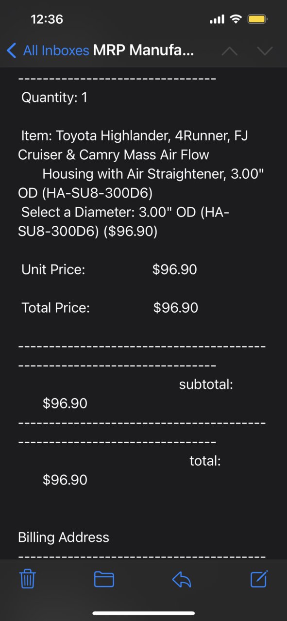

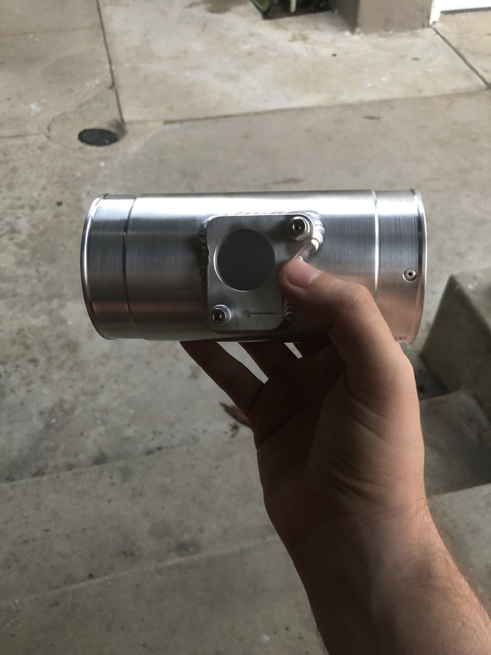

    I purchased this for my taco
    With a UMP
    It did not work
    The MAF on the taco and Highlander are not the same
    I emailed them about the problem and they never responded
    so
    Buy at your own risk

    The second Gen and 3rd Gen have different MAF clocking so this WONT work on a second gen.

    I have a third gen
    And as I stated
    Tried to talk with the manufacturer
    No response
    this order is 2ish years old for what it’s worth

    The screw holes didn’t line up
    And the opening was a bit small
    If you had the time and patience you could modify it to fit
    But
    Making from Scratch would be the easier solution
    Or
    Partition off the plastic tube section from the OEM intake tube and then cut a small grove into each side for the tube clamps
