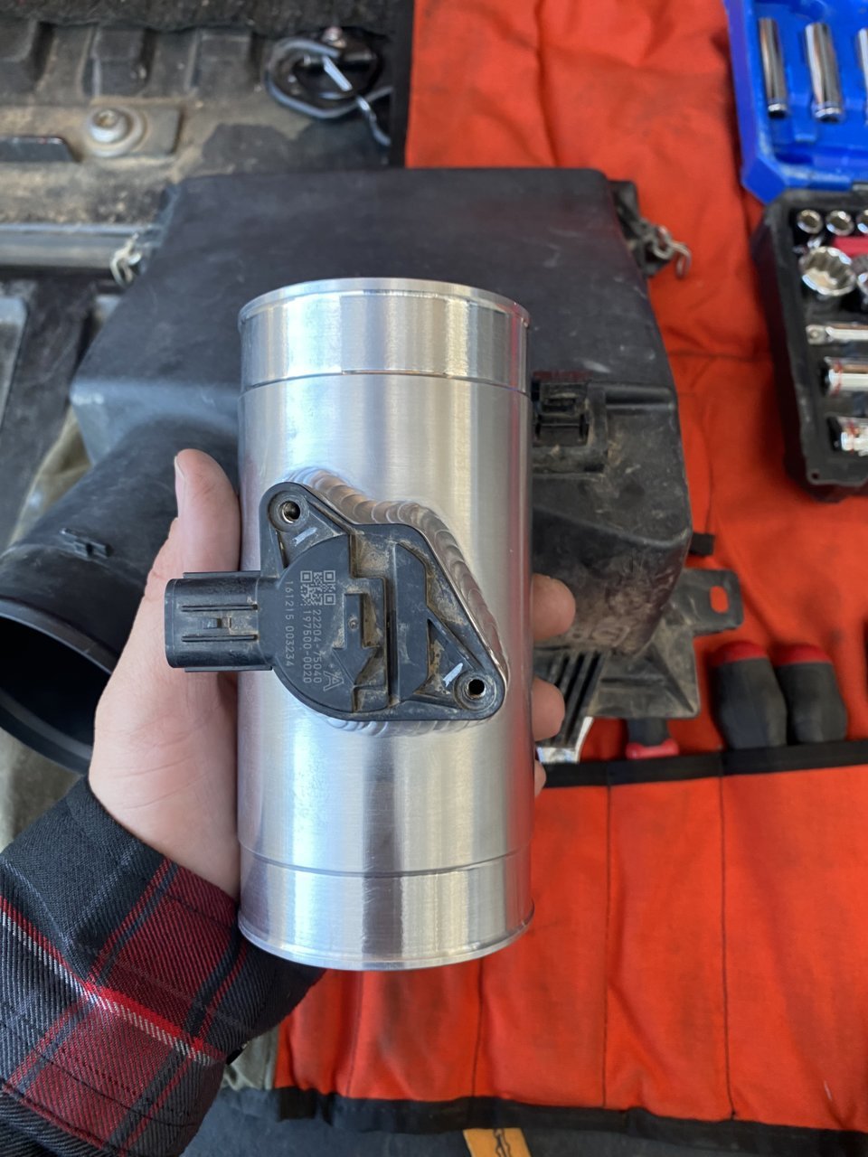

    Received the adapter. Looks like a completely different MAF mount than yours @Caboose117 and very close to @906taco adapter he has.

    Sweet
    Did your maf fit then?

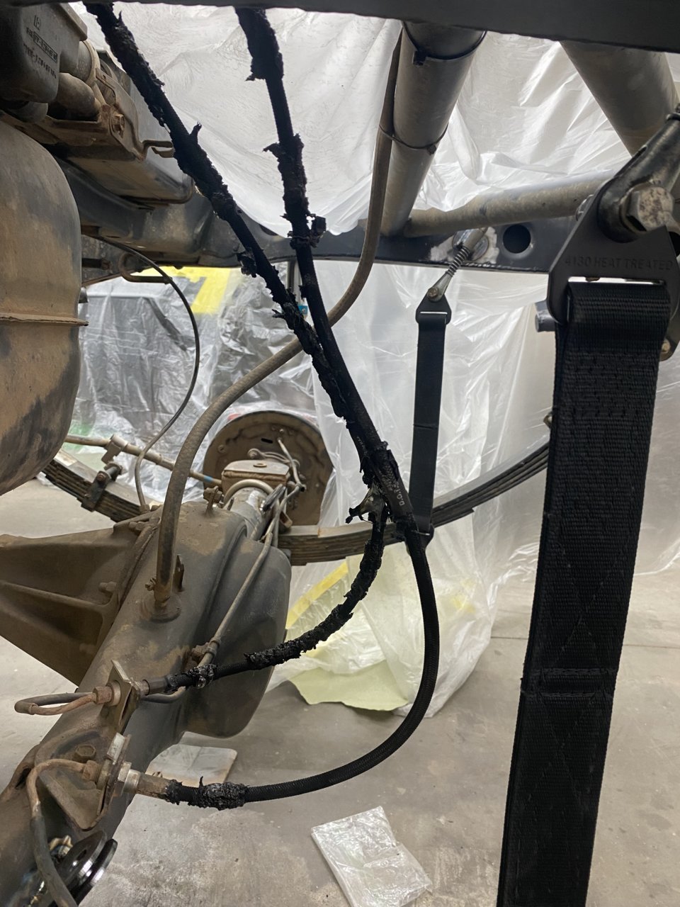

    PSA. Don’t forget to move your ground clamp when you’re welding and go from cage/body to axle housing. I turned my rear hoses into fuses today.

    That’s one way to warm up your brake fluid

    Scared the ever living hell out of me. One minute I’m burning in limit strap tabs, the next the entire shop is filled with thick white smoke. Freaky.

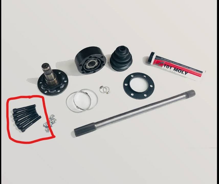

    Looks like I need to pull the axle to replace, What size are they @81Trekker ?
