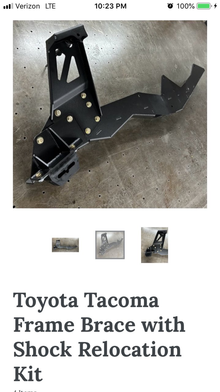

    Just noticed these on the site. Was there going to be a version of this that fits already welded on shock mounts?
    *just noticed this is for soa so probably not done yet

    The spring under version is available with the whole kit.
    We’re cutting an re welding mine once installled

    I'm assuming you mean you already have a shock relocation done like an Archive kit? I have not heard anything about the frame brace being offered in a compatible version. Too many different relocation kits out there.
    I notched the frame brace to fit with my relocation but there's the concern about cross sectional strength.

    Notch the spring under brace and weld it on, the will be zero strength lost. Or cut the existing towers off and start over

    I like Harry’s idea better and just notch the brace. But we’ll see how things line up once we start this little project

    I have the jd kit installed. I can see now how much strength would be lost if it were notched around the welded on tower

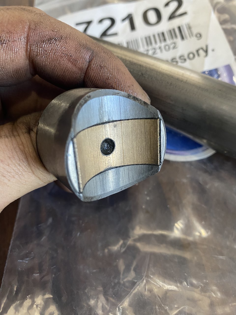

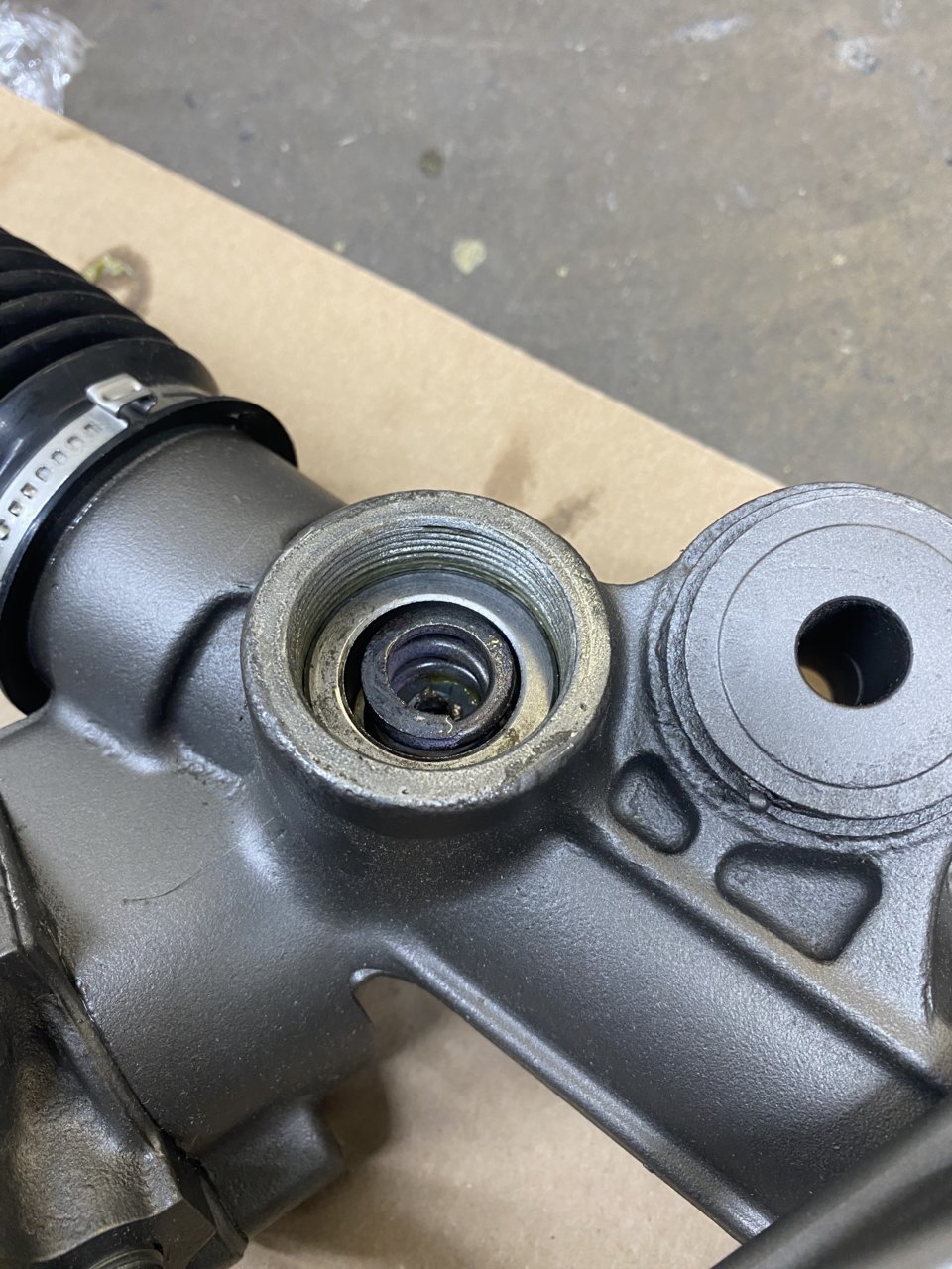

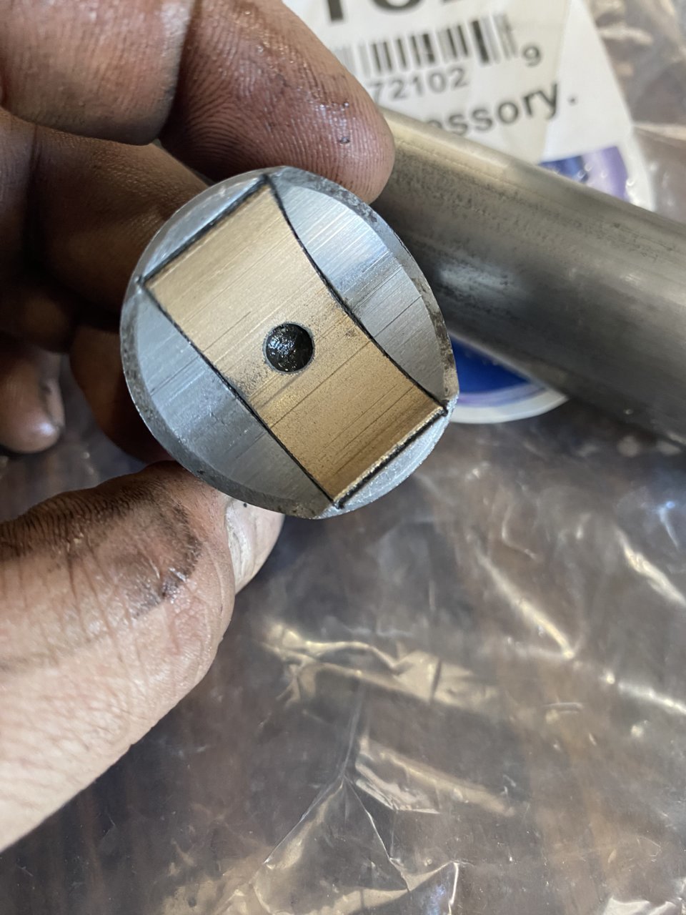

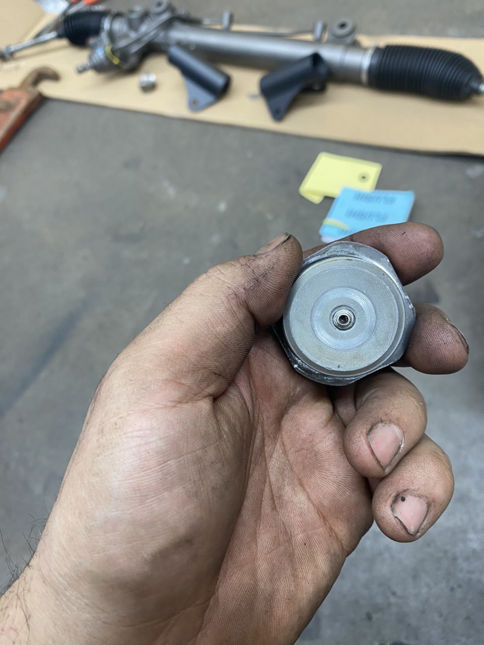

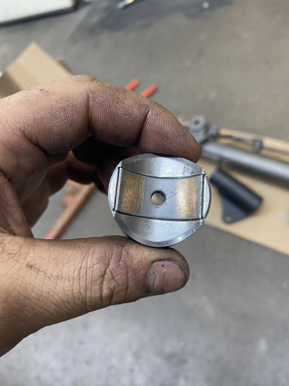

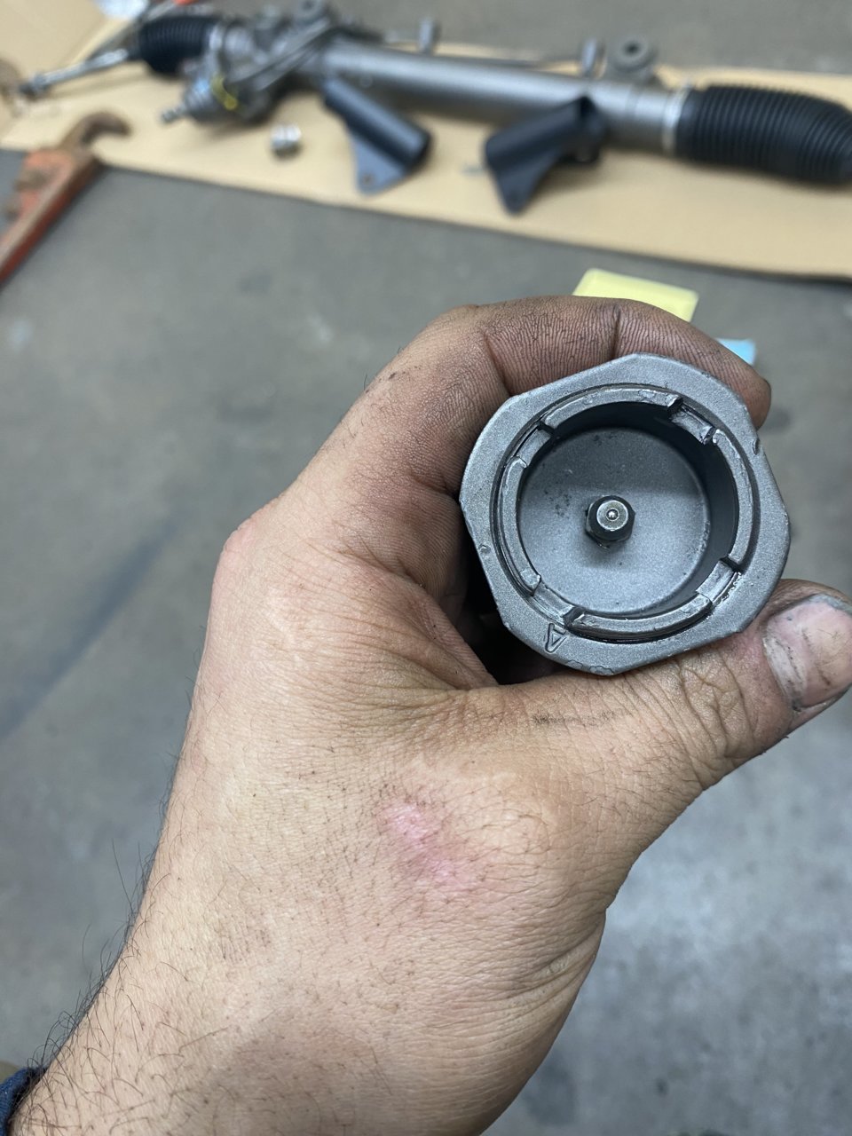

    Alright. This is for the slide rack guys. While the slide rack works amazing to prevent skipping teeth and broken racks, I have gone through 2 in the two years it has been on the truck.
    I broke down my last rack to find out why I developed so much slop in the steering.
    Long and short is, lack of lubrication is wiping out the preload slider. When the bronze insert is wore away the steel starts riding on the rack which starts loosening things up quick.

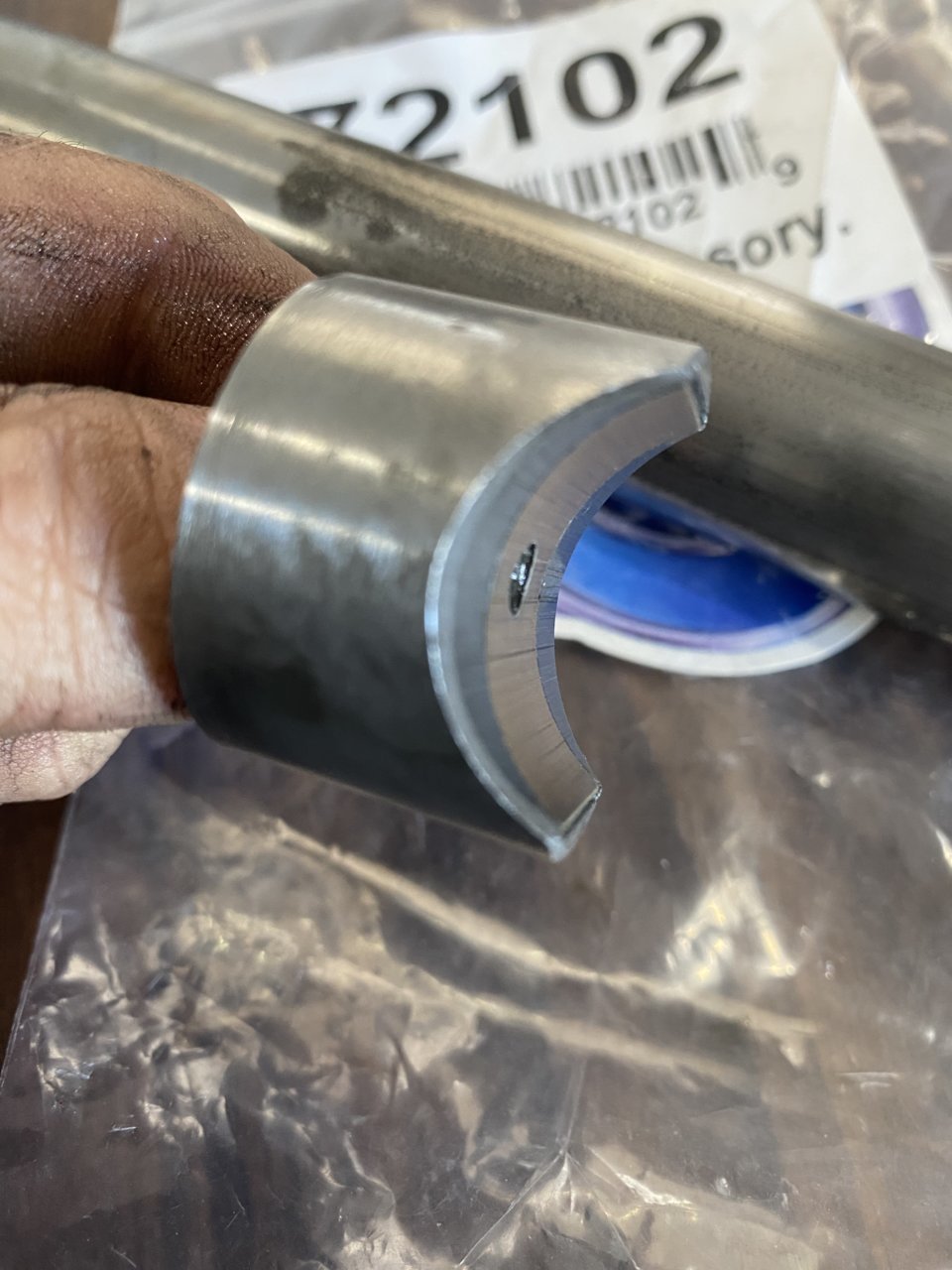

    What I am trying this time around is I drilled and tapped the preload cap for a zerk, then drilled out the center of the bronze bushing.
    I already grease the truck almost every weekend out so hitting one more zerk isn’t a huge deal and should help extend the life of the rack substantially. Or it might not work at all.
    I know @snowsk8air2 is having the same issue as me which is substantial play in the wheel when it is centered.
    DoulosXP, Slashaar, Suicyco and 5 others like this.

    That’s a great idea and I think it will make a huge difference!

    Worth a shot at the very least. Costs about a dollar and 20 minutes of time. We shall see how it goes this year!

    You doing this on a new rack or the old one? When I had mine out before koh I checked play with it on the bench and didn’t notice anything so I didn’t adjust the preload. I should have. It’s still bad and it’s the worst thing I hate about the truck lol. This will be the last time I mess with this steering setup. Then I’m going either full hydro or trying to figure out a swing set. Full hydro would be a lot easier

    I got a reman rack this time around. Had no choice. My bar was wore so bad. Like decent light under a straight edge bad. I seriously feel like greasing it before you go out is going to save it. And let’s be real here, this is a budget steering setup. So if we can make it last that would be killer.
