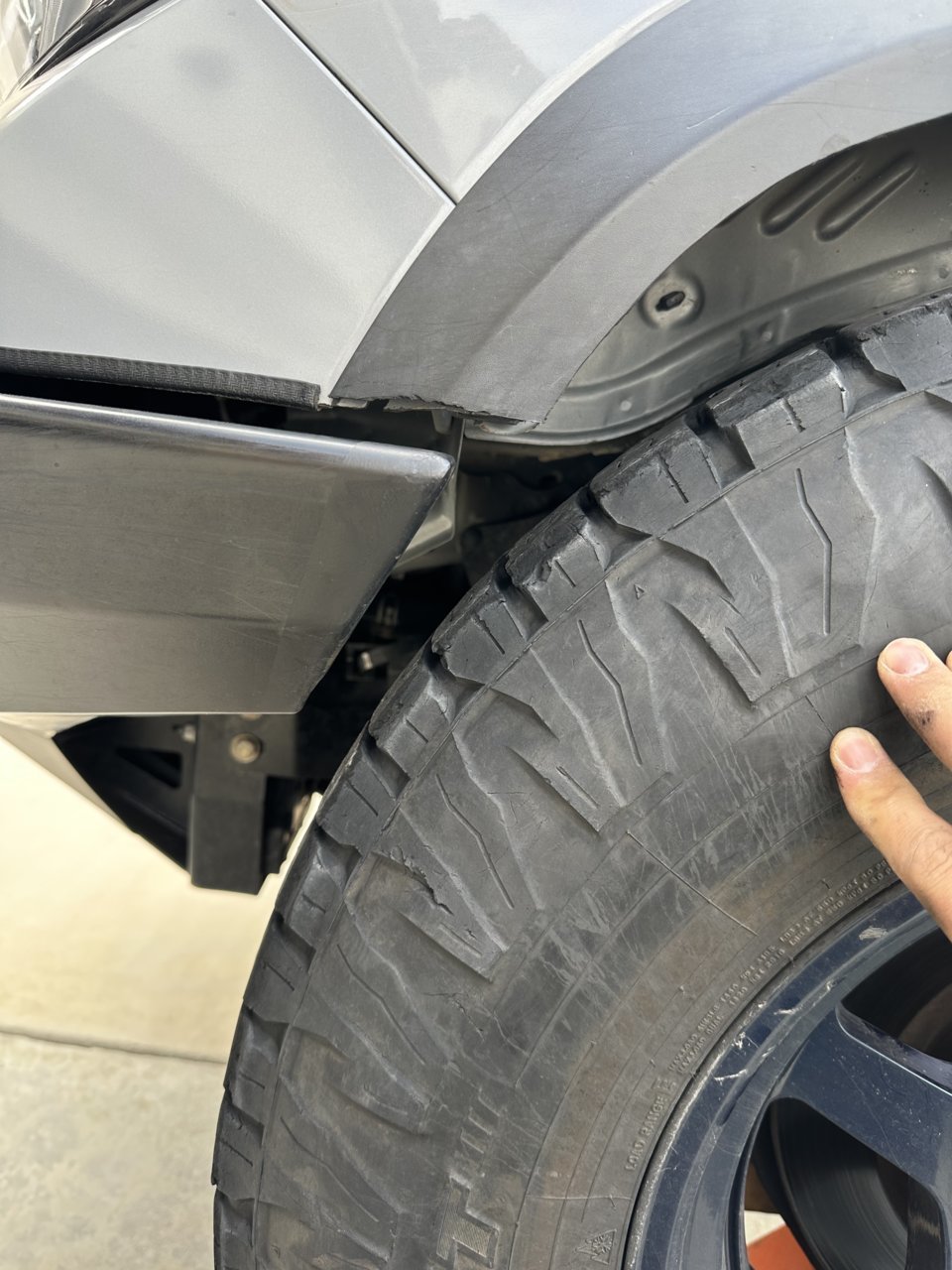

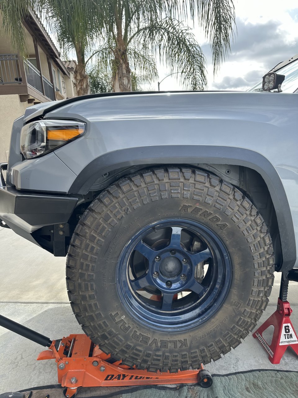

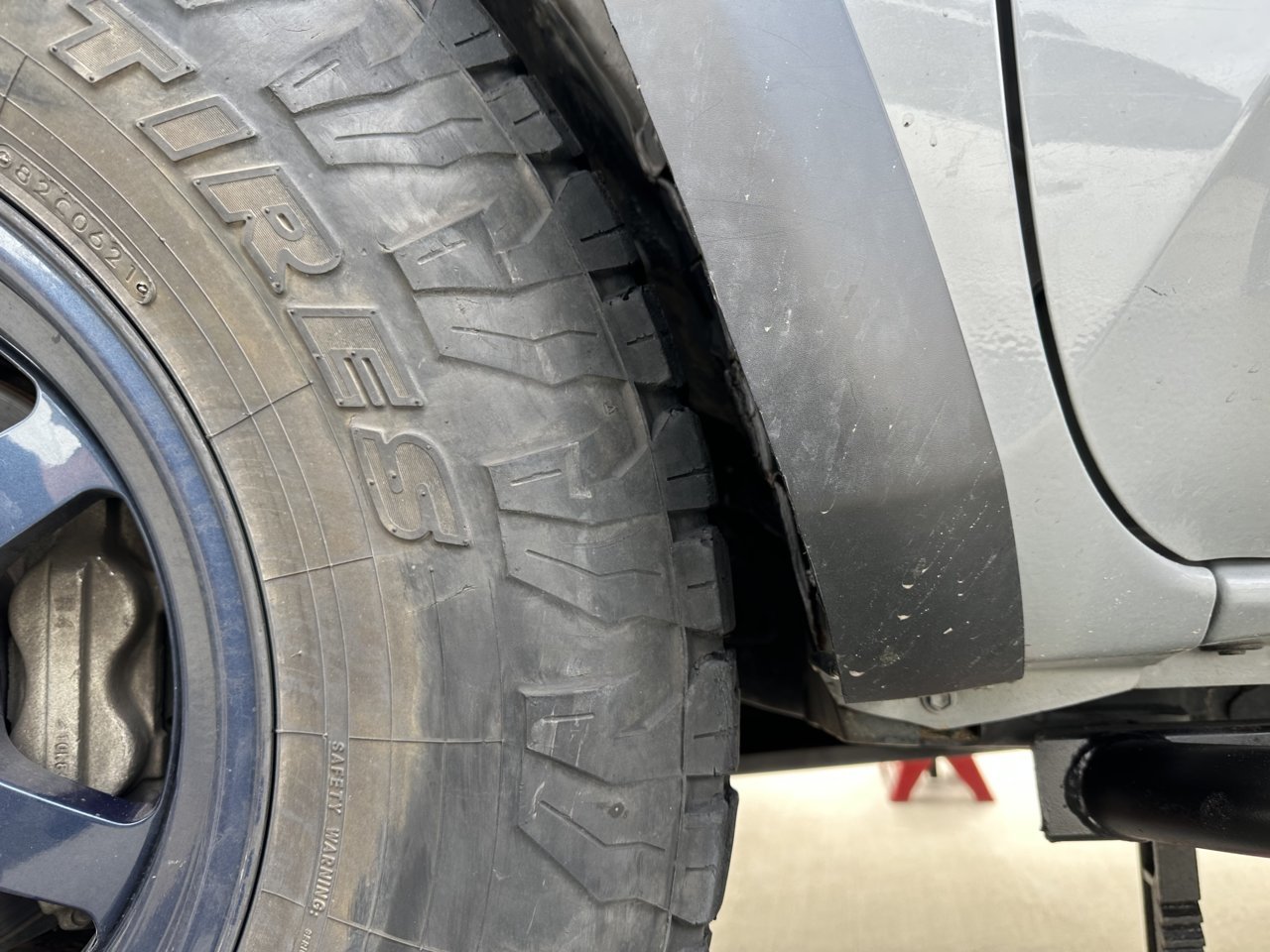

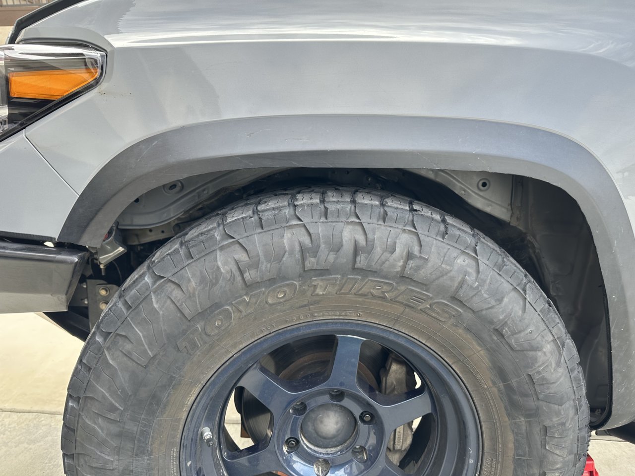

    Learning as I go.. I have JDFAB’s +2.25 LT kit w/superbumps. Out of curiosity Took my shock off and at full bump on a 285/75/17 I rub just the front of the inner fender when turned. Tire seems to clear everywhere else.
    B8520F23-4A41-456B-B717-229AA8765A41.jpg BACAC96D-F823-4473-84EF-CAC5A748D45F.jpg 4BF6F4D0-1821-46C8-8889-EFDCA0DF207E.jpg
    Tried on a friends 35x10.5. Keep in mind it’s a skinny, and that’s where the fun happened.. looking to possibly jump up to 35’s and not have clearance issues so may be going with the pivot kit and inner fenders

    Did you check clearance with the steeling locked both ways? Did you keep your bump stop in place or metal to metal?
    AY_ARONTRD[QUOTED] likes this.
  17. Mar 29, 2023 at 7:54 PM
    AY_ARONTRD
    AY_ARONTRD Well-Known Member
    Sep 25, 2017
    #231065
    4,091
    Aaron
    Murrieta ,CA
    2019 DCLB Cement OR 4x4
    On the 285/75’s turned until inner fender hit. On the 35x10.5’s. Didn’t even bother. Lol. This was with bump stop in place.
  18. Mar 29, 2023 at 8:02 PM
    desertjunkie760
    desertjunkie760 @DesertJunkie760 (IG)
    Apr 11, 2016
    #183963
    9,150
    Shane
    2011 MGM DCSB TRD Sport 4x4
    Check My Sig.
    you’ll have more clearance issues as you turn the wheel. Being a skinny will help but it’s hard to say how much you’ll have clearance.
    The bump stop is also deceiving. You can’t replicate the amount of force generated on a hard hit in a static environment so that wheel will probably bump a little higher than you’ve got pictured when driving.
  19. Mar 29, 2023 at 8:12 PM
    AY_ARONTRD
    Sep 25, 2017
    #231065
    4,091
    Aaron
    Murrieta ,CA
    Yea that’s why I didn’t even bother turning the 35. Could already see what was going to happen. Don’t prefer a 35x10.50 but was available and same exact wheel so didn’t have to worry about specs. Just tried it out for fun.
    And yes aware about the bump. A while back was out at Fish Creek on hard impact I did rub inner fender on 285/75’s.
    This was just out of curiosity. Without doing too much work to test. Clearly seen I’d run into issues.
