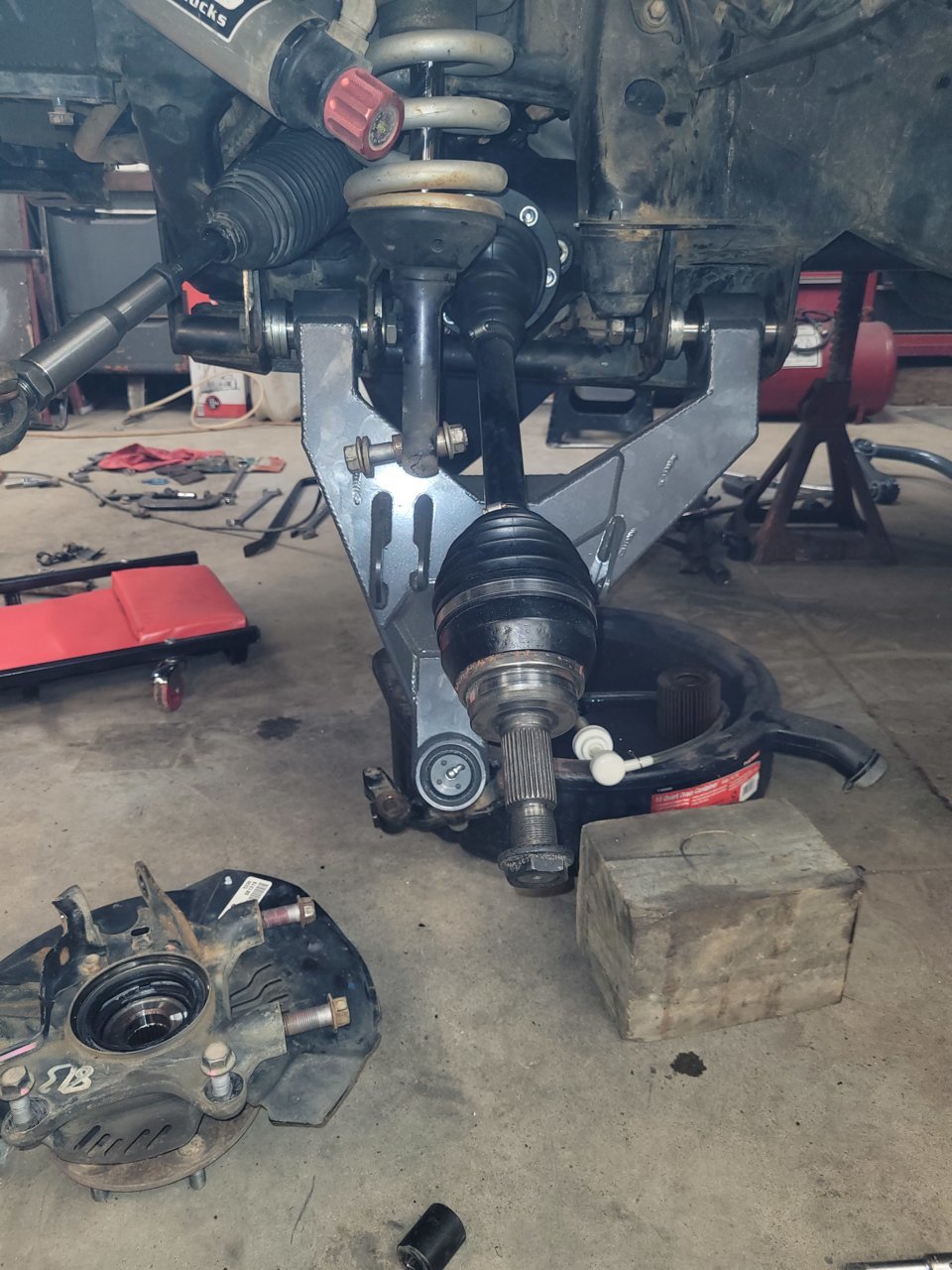

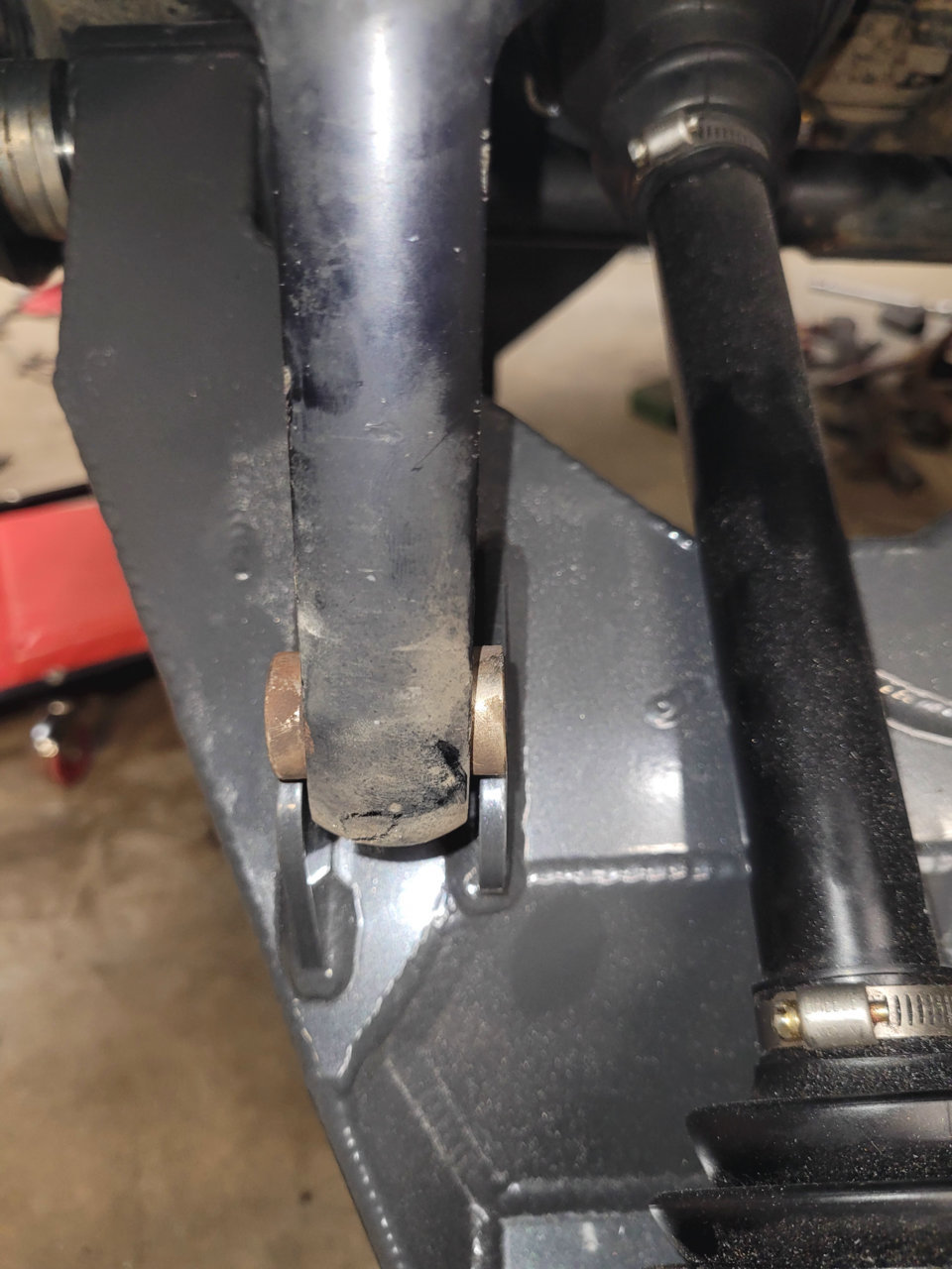

    Has anyone else run into the coilovers not fitting? Also, the bolt hole is too small for the factory bolt.

    Can you give us a zoomed out pic?
    Kinda looks like it’s sitting in the sway bar mount

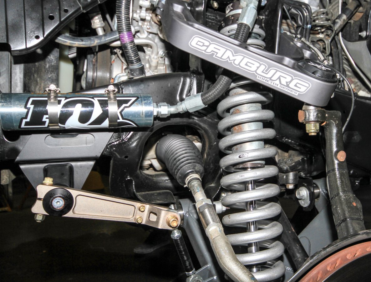

    Quite a few manufacturers offer LT or MT kits with sway bar on the lower…
    Are those shocks set up for that exact kit?
    Did you try fitting it into the tabs without misalignments on it?
    maybe need different rod ends or misalignments
    doubt it’s an issue with the arm

    You need different reducers (misalignment spacers). The mounting width and bolt diameter on OE replacement shocks aren’t the same as LT kits. You’ll need reducers with 1.25” width and .5” bolt size.

    Also, the sway bar mounts to the spindle on Tacomas.

    Sorry
    I was thinking of this photo
