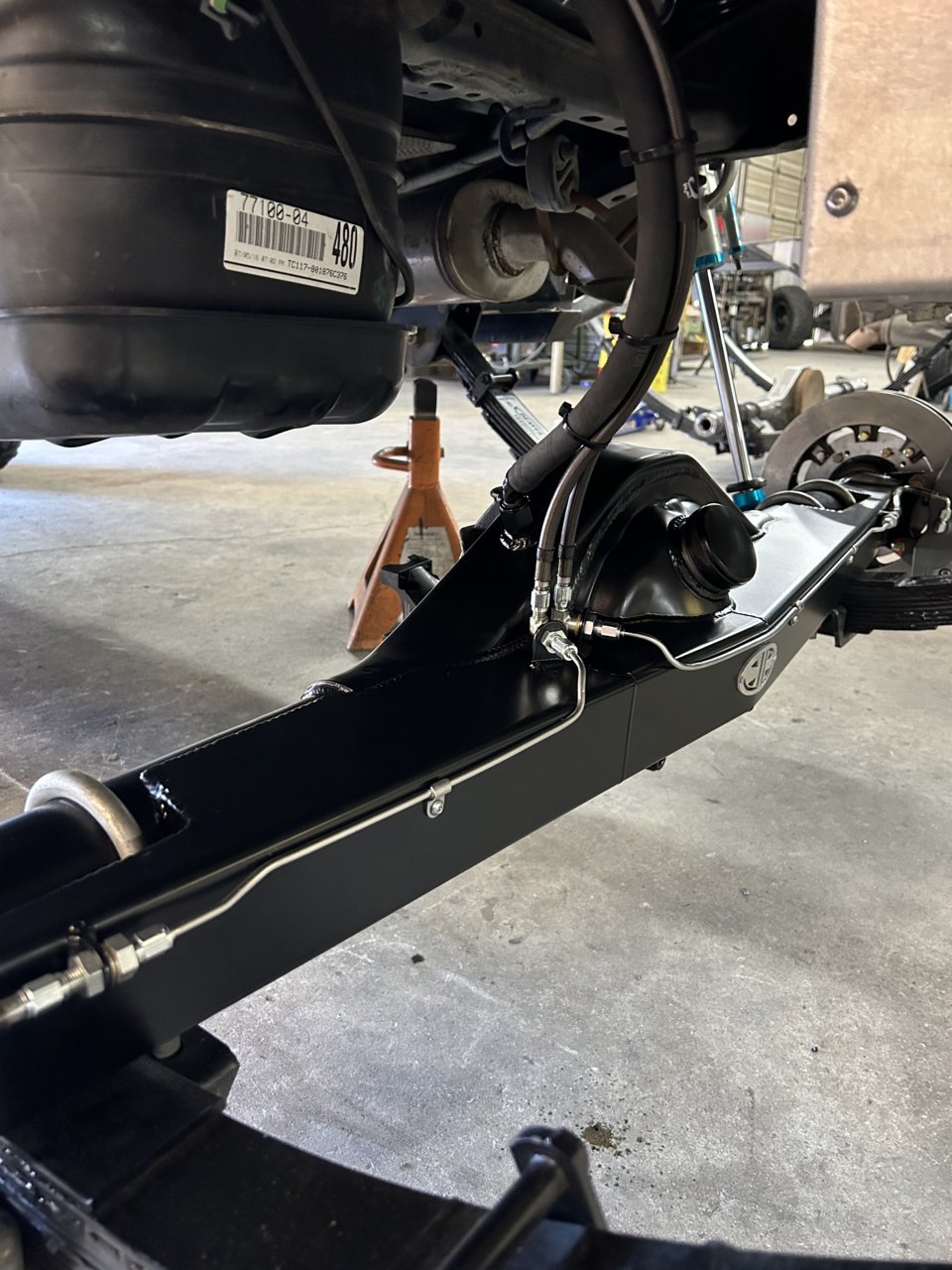

    @zcweisman gets all the fancy stuff… I even did stainless brake lines :)

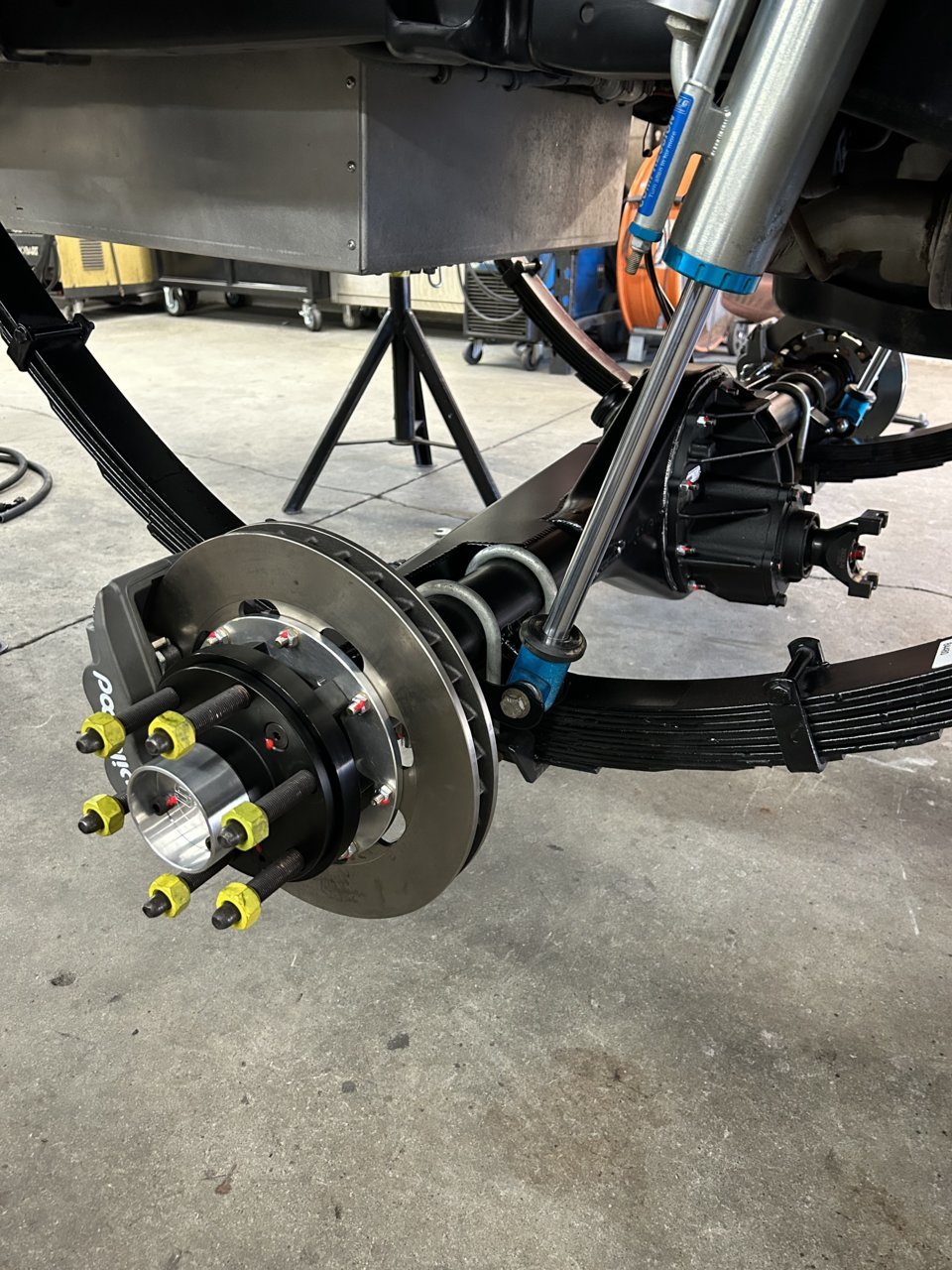

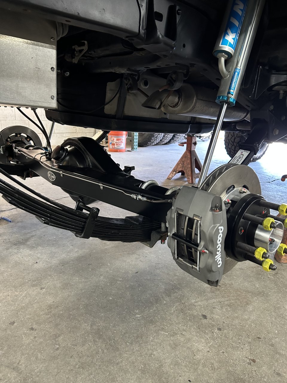

    i believe your rotors are spinning the wrong way for best cooling. but still jealous of that setup

    Interesting, I thought the "scooping" would be preferred but I guess not.

    they are typically designed to centrifugally take air from the center and exhaust them radially. this is why straight vaned rotors still functionally cool. the angled vanes just help it out some more.
    that said, budget minded sports cars have been known to use the same handed angled vaned rotor on both sides of the vehicle (common parts = lower cost) like C6 Z51 vettes, etc

    I like doing them that way with off set wheels
