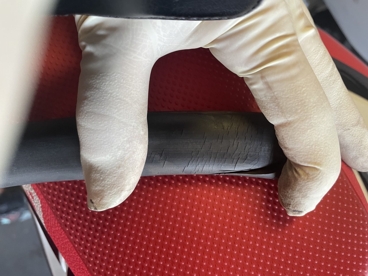

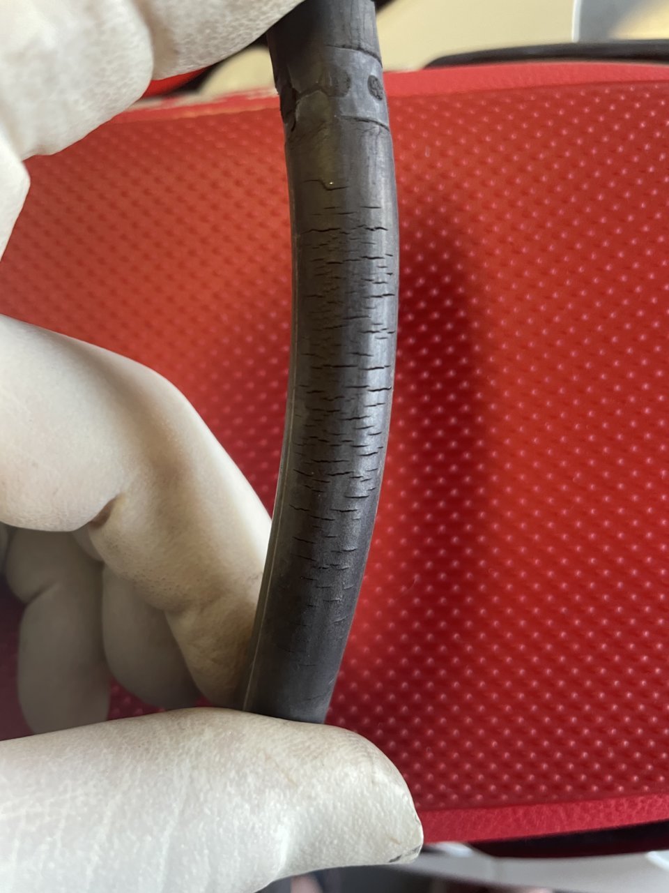

    For anyone that has done a JD spring under kit and used the supplied rubber hose at the fuel fill area might want to check the hose quality. Mine lasted five months.
    Hoses have deteriorated far worse than the pictures.
