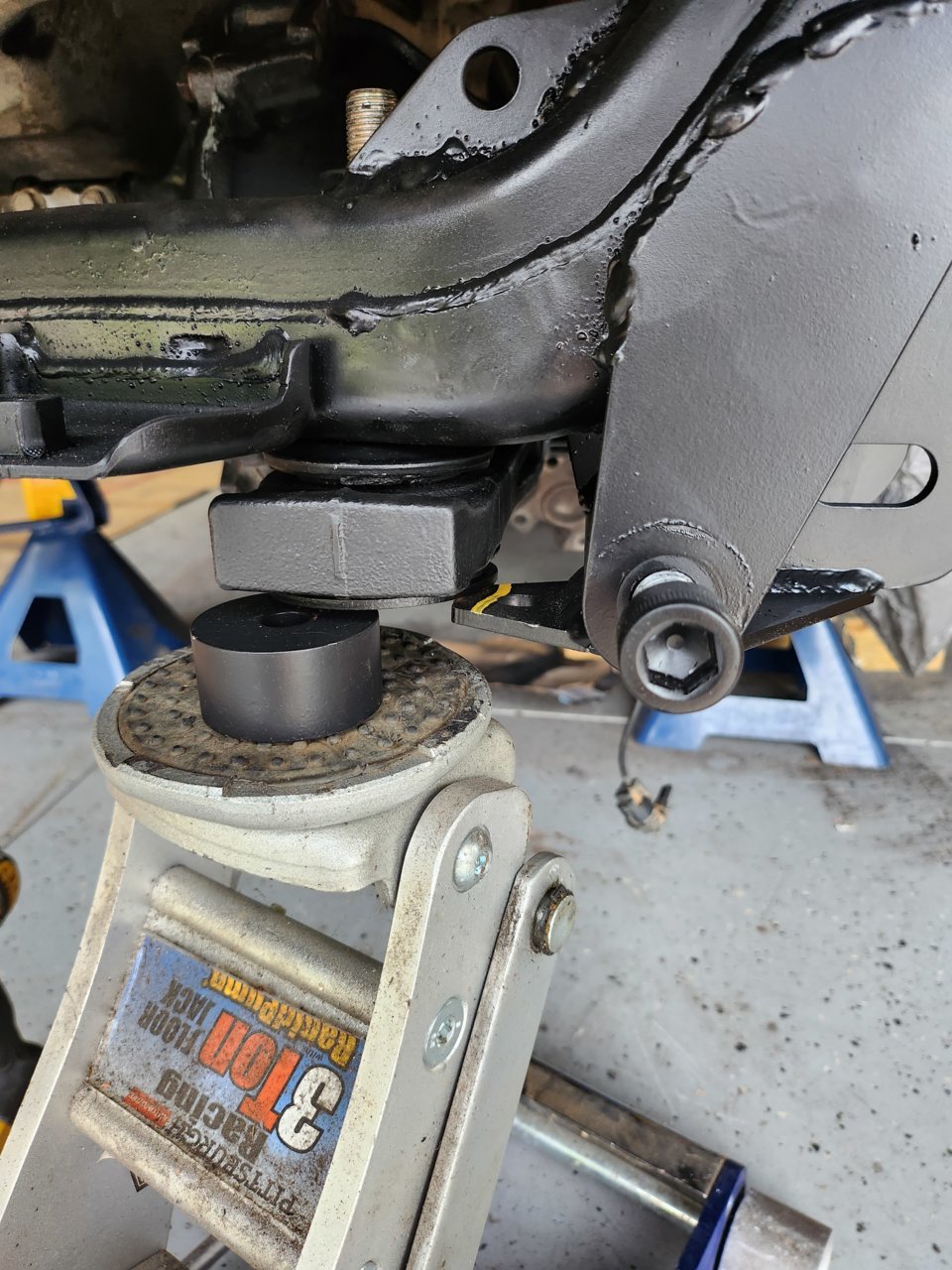

    Long time lurker...I'm reassembling the truck after doing the lower pivot and I found a close contact area with the driver side of my front diff mount. Just curious if anyone else has had this issue.
    I had a drop spacer as well but I see those won't work with the skid plate, so they gone.

    Straight from the JDfab website for the pivot kit
    "This kit must be installed by a qualified professional only, cutting, grinding and extensive welding are required."
    Start cutting and grinding!

    Did plenty of that. Lil more can't hurt. Thanks.

    Mine is the same way. I didn’t cut or grind any of it. You won’t have an issue.

    Looks like you have the entire kit shifted a little bit too far towards the passenger side. No big deal, lots of cam adjustment available to get the truck to align

    Mine ended up being a little bit the same.

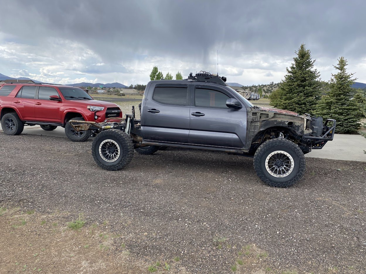

    It starts for the work
