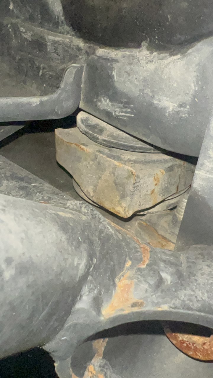

    Mine ended up being right under the mount.

    Yea you are right up in it. Thanks for showing that.

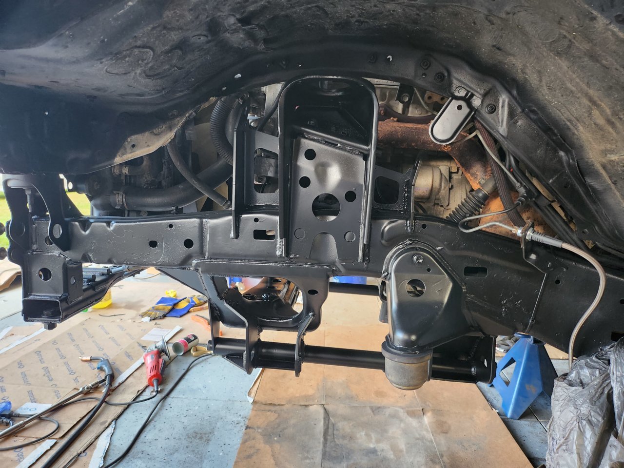

    2021 ACLB TRD OR 6MT
    just wondering if people are cutting the front cross member nub thingy off before installing the skid after installing the lower arm pivot kit. its hanging lower than my skid mounts now...
    Slashaar likes this.
  12. Jun 11, 2023 at 3:49 PM
    Airdog
    Airdog did your Mom
    Dec 26, 2012
    #93790
    4,893
    Tom
    SoCal
    https://www.tacomaworld.com/threads/airdogs-2012-prerunner-access-cab-slow-build.264263/
    Yup...she gone
  13. Jun 11, 2023 at 3:49 PM
    racebug68
    racebug68 Well-Known Member
    Apr 8, 2013
    #101660
    1,238
    Travis
    Chandler, AZ
    05 DCLB 4x4 TRD SPORT SILVER
    I can't leave anything well enough alone
    some sawsall through it for enough clearance, I ground off the welds so it looks like it was never there.

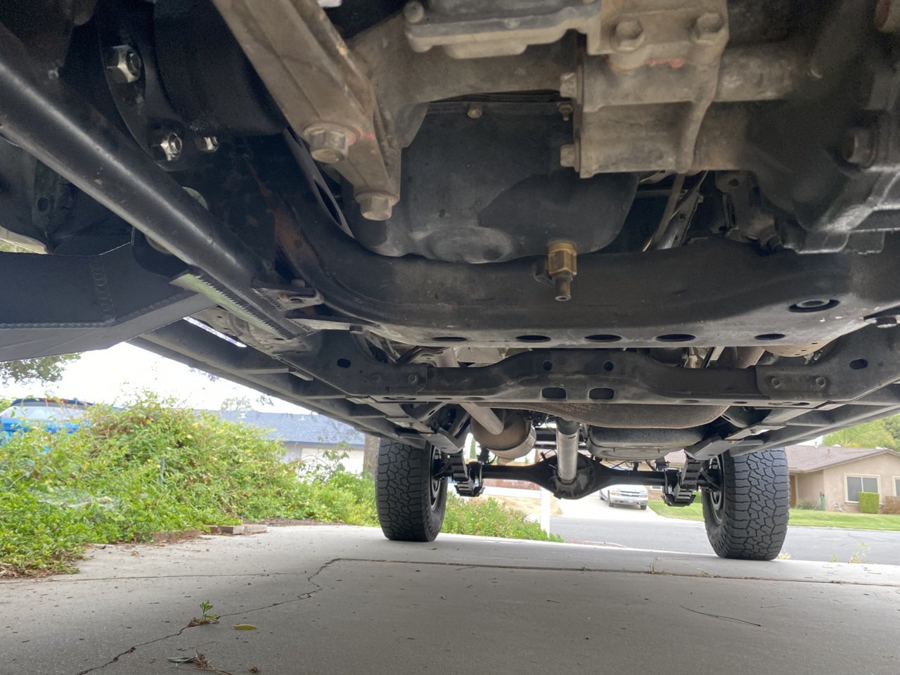

    Speaking of clearance. I found what was making the most horrible sound from the low end. Fumoto valve was making contact with the pivot skid and wore enough paint away to create a rattle that sounded almost like rod knock. I’ll have to get a valve without the nipple.

    But that’s the factory jack point. How will you jack your truck off now?!

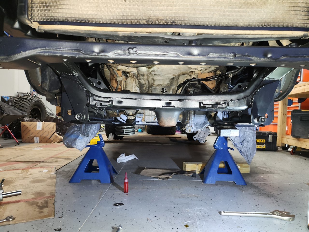

    Fox 2.0
    More work with the truck.
    Front hangers off, and man; them front rivets being a pita to knock out. Otherwise. started mocking up the frame braces and getting all the frame notches done.

    mine was actually interfering with the skid from the start, I cut off the nipple with a 4.5" cutoff wheel. And cut a hole in the skid so I can barely reach in, open the valve, and drain the oil without removing the skid. Very happy I did that, recommended.
