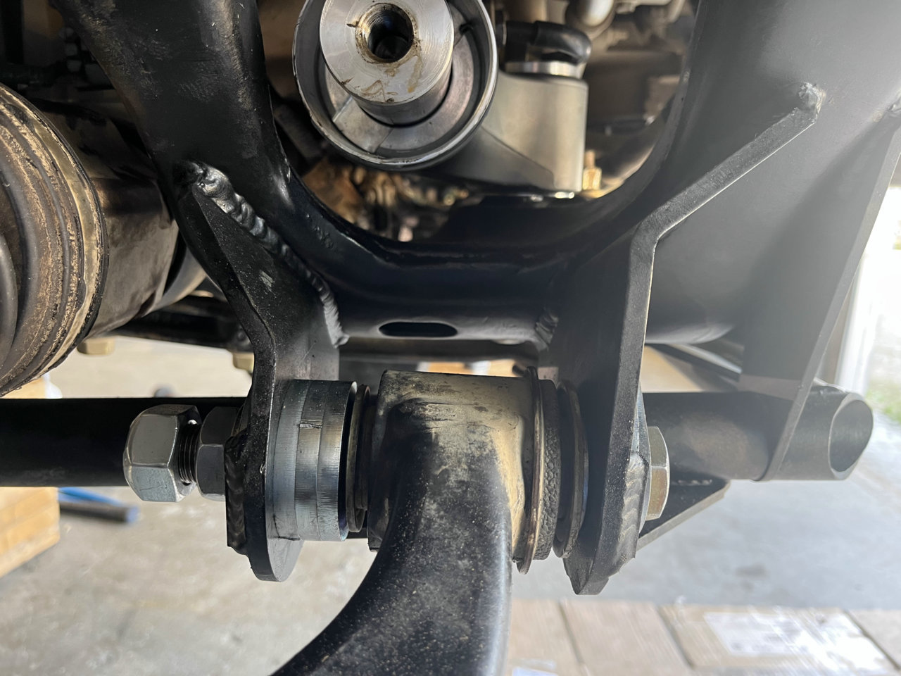

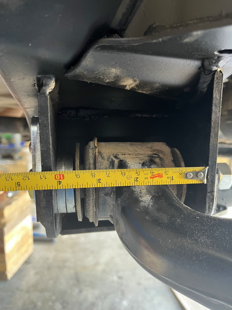

    What lower arms/bushings do you have? Some of the aftermarket bushing widths vary and for that matter the OE are not always the same. Also when you welded the pivots on did you weld the insides of the tabs first? If you put too much heat into the insides you could have warped the new tabs inward.
    Also check to make sure the arms aren’t bent, I’ve dealt with that a few times.
    also is it exactly 1/8” too tight? If so that’s only a 1/16” on either side which isn’t much. I’d suggest you sand a little bit of material off the bushing faces and see if that gets you there.

    i appreciate everyone's replies. they are stock 3rd gen lower control arms and bushings. pivots were tig welded by a certified welder who made a big deal about controlling the temperature but who knows.
    i will take more measurements to try and understand where things are off. also as i mentioned before wouldnt just shimming with washers be the easiest way to go at this point?

    Yes, at this point using washers or machining down the face of the existing spacer would be your best bet.
    When I did mine 2 years ago I took a bit off the face of the 1 spacer on each leg of the LCA so it slid together like butter. But I’m lucky enough to have a lathe in my garage.
