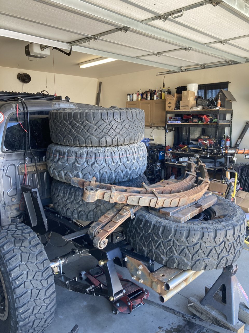

    Trying to simulate the weight of @Sixthelement house on the back of the truck to set pinion angle lol. Overall everything going smooth on the sua conversion.
    @81Trekker do you normally allow the shackles to go past 90° and swing forward some at full droop? I’ve been told by a few leaf spring racers it’s a bad thing and thus strapped my truck before they go 90. Curious on your opinion on it.

    In my experience, as long as the shackle doesn't go past being straight with the leaf spring, it's fine, because the shackle can't invert. It's more about the shackle to leaf spring angle, than the shackle to frame angle.

    It’s totally fine for them to swing past 90, when the spring compresses it wants to flatten out and will push the shackle rearward. If the shackle we to swing 75 degrees forward past 90 you could potentially get the springs to flop but this will never get anywhere near that

    Exactly

    We over estimated the weight too. However even bare ass back there still 1900 without bed or anything.
