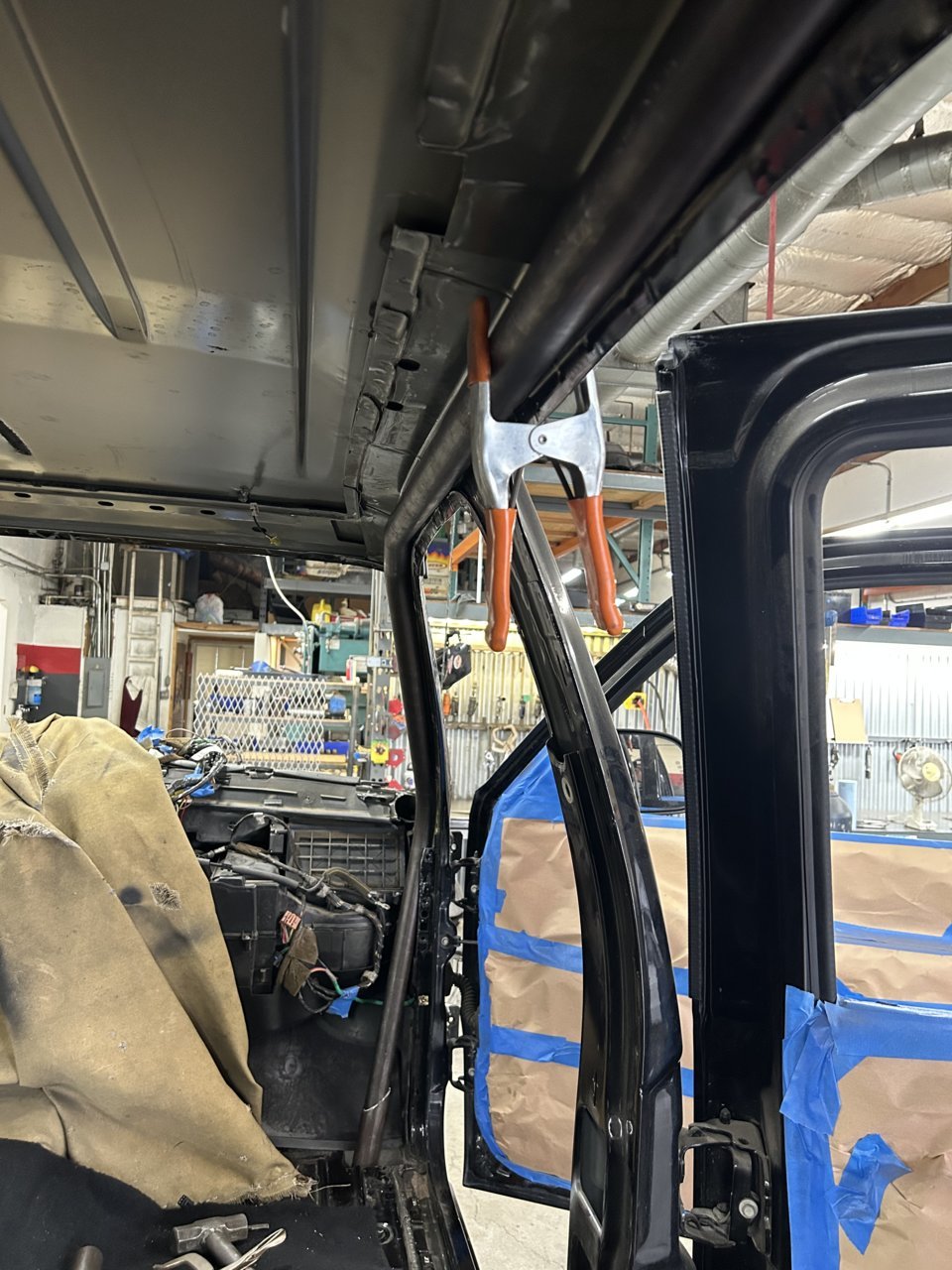

    40hrs in to this cage… if you want your tubes tucked tight like (as they should be!) this it takes time and ultimately is expensive. This is why a properly done cage can easily cost $20k

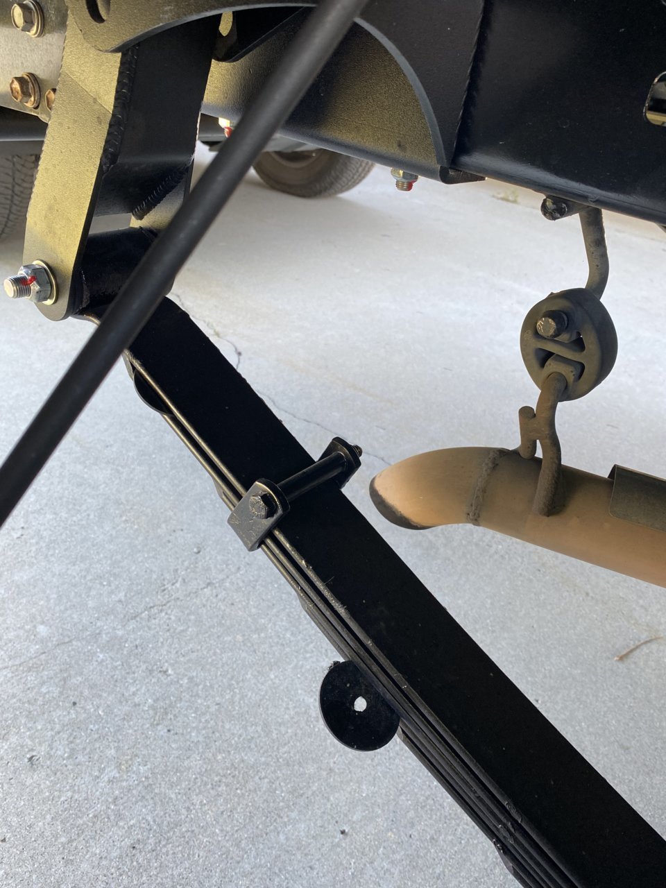

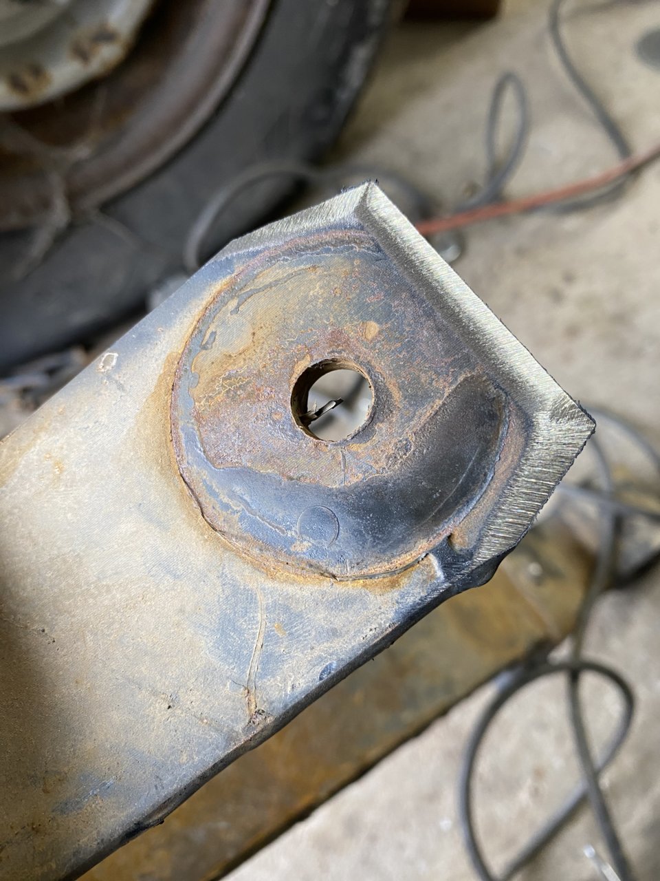

    Get rid of them all together. Time consuming project but very much worth it. Bevel edges, paint and assemble. So much smoother with this done.

    does the bottom of the leaf have that same chamfer or just the tops?

    Just the tops where the pads were. Both ends on every leaf. I did it with mine and it was drastically smoother.

    That'll be a fun project... What did you use to add the bevel?

    Or probably an angle grinder with a flap disc

    Flap disk will work just fine. Make sure you check the holes where the anti friction pads were too. Some of mine had some pretty good burrs, you want them gone if you have any.
