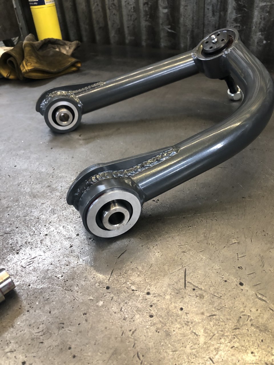

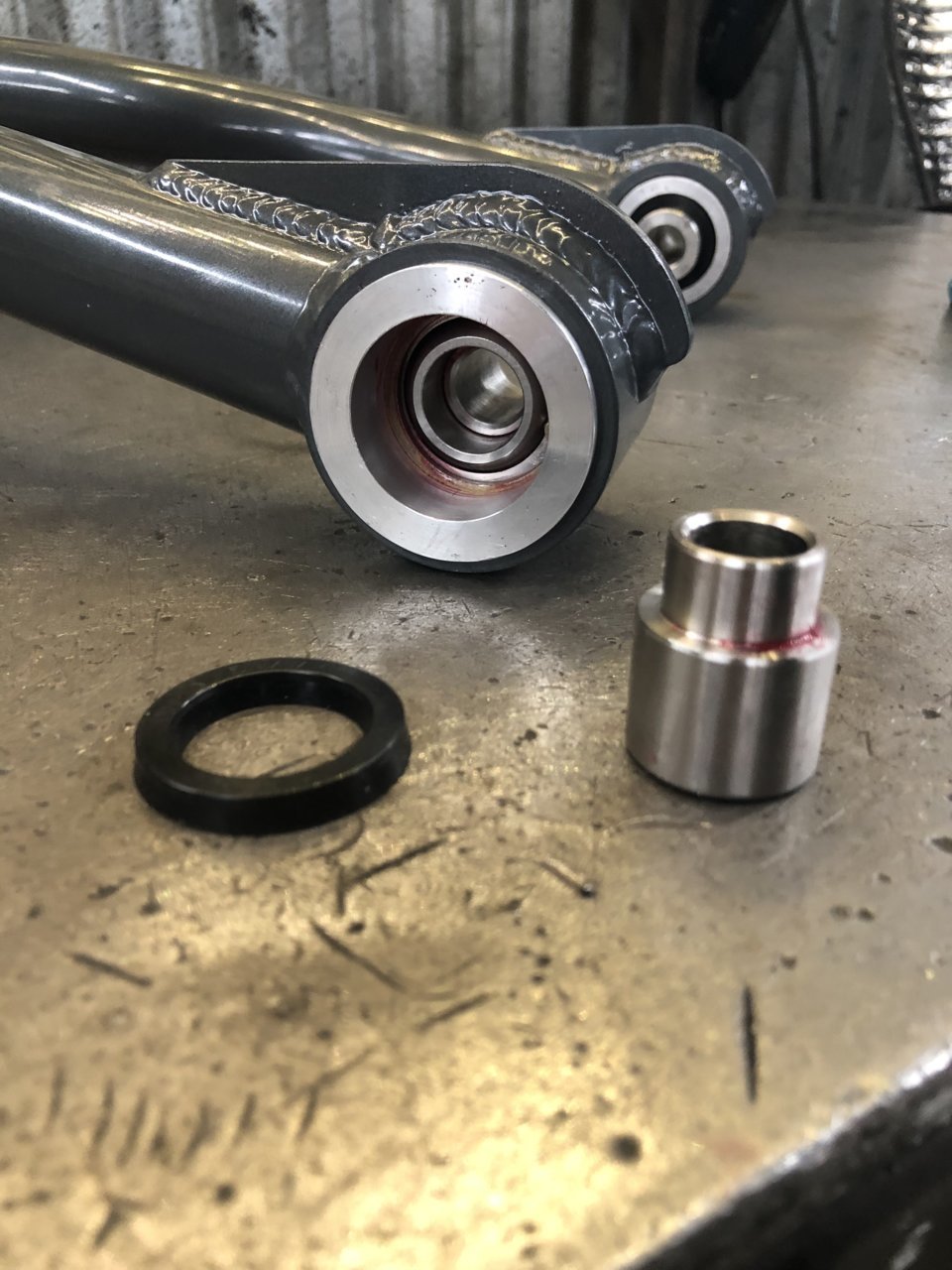

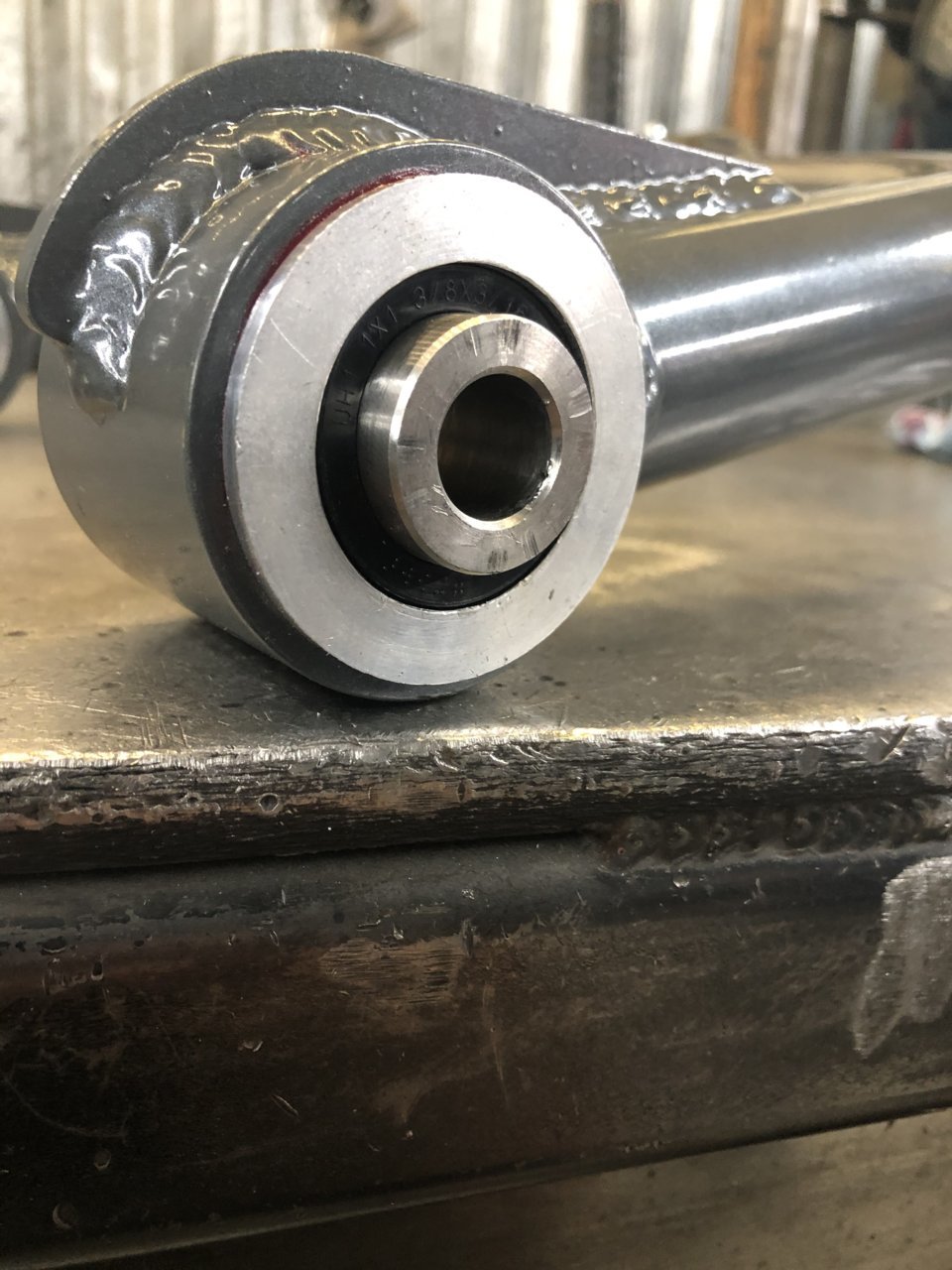

    We have the upper arm uniball set up dialed in. All uniball kits come with machined aluminum inserts that accept 3/4” uniballs and then run seals on both sides to keep stuff out of the uniball
    we had custom misalignment spacers made to accept the stock Tacoma upper arm bolt so these will bolt right up

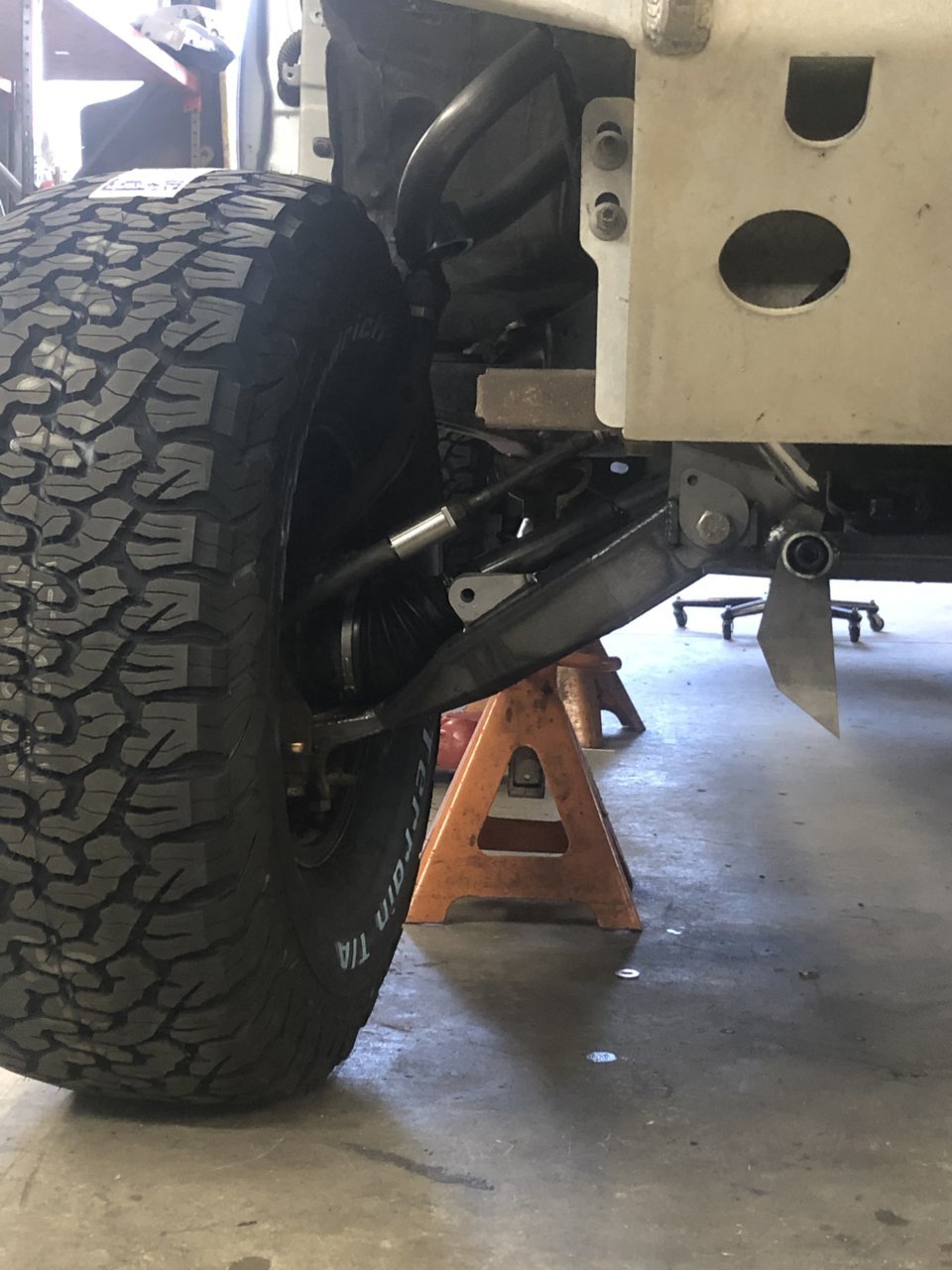

    Why +2.25 increase in width and not the “standard” +2? Were you able to cycle 13 inches?
    If I want to tuck as much as possible within the stock fenders what is the max BS/offset wheels would you recommend for a 35x10.5R17 tire. Currently on on +0 17x8 but considering 4Runner wheels which are 7.5 +15.
    Any shots of the truck on level ground? Curious about the ground clearance gained.

    2.25 with +15mm BS gave us the perfect tucked look for no glass and 35’s. There are lots of pics of increased ground clearance in the thread

    Thanks for the quick reply! I went back and looked at the pictures on page 55. I was hoping to see something at or near ride height?

    I’ll grab some pics for you tomorrow and what I can tell you is we have gained over 3” ground clearance from most kits and 5” from another popular brand
