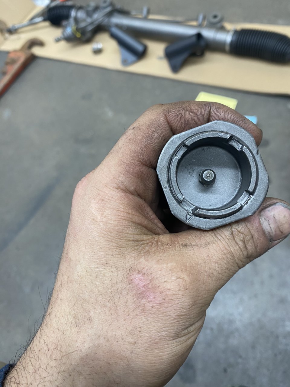

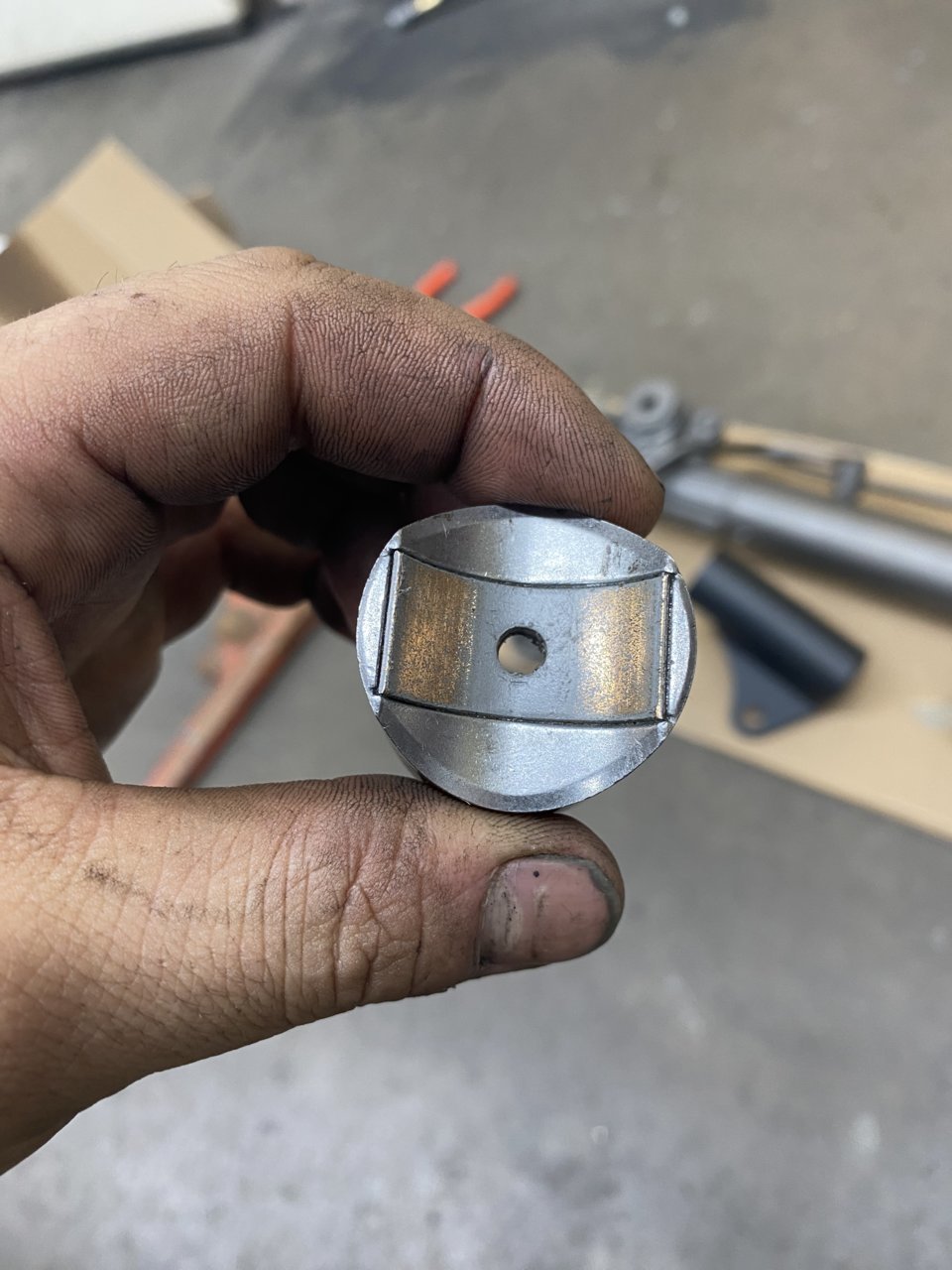

    Speaking of steering.
    I had already clapped out a rack at this point last year.
    I have a few thousand hard dirt miles on this year and my steering is still tight as can be.
    So those of you that have a slide rack, go spend the 50 cents on a zerk and do it.
    DoulosXP, JasonT87 and EatSleepTacos like this.

    The cap for the preload slider on the factory rack. It’s a stupid easy mod and it is 100% for positively sure making a massive difference in longevity.

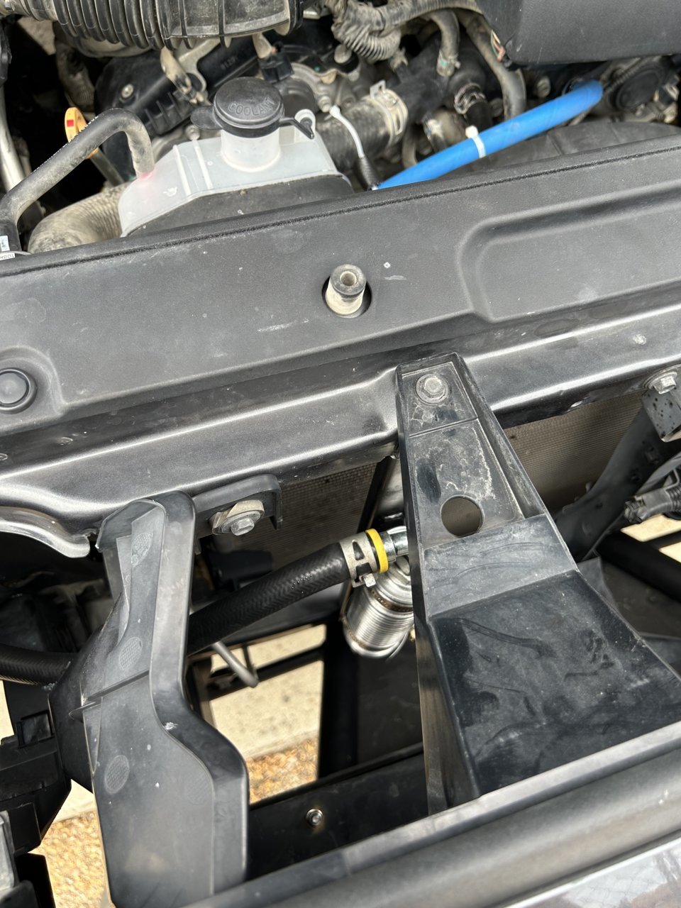

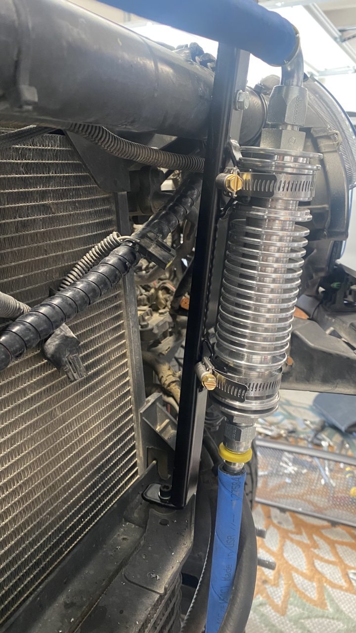

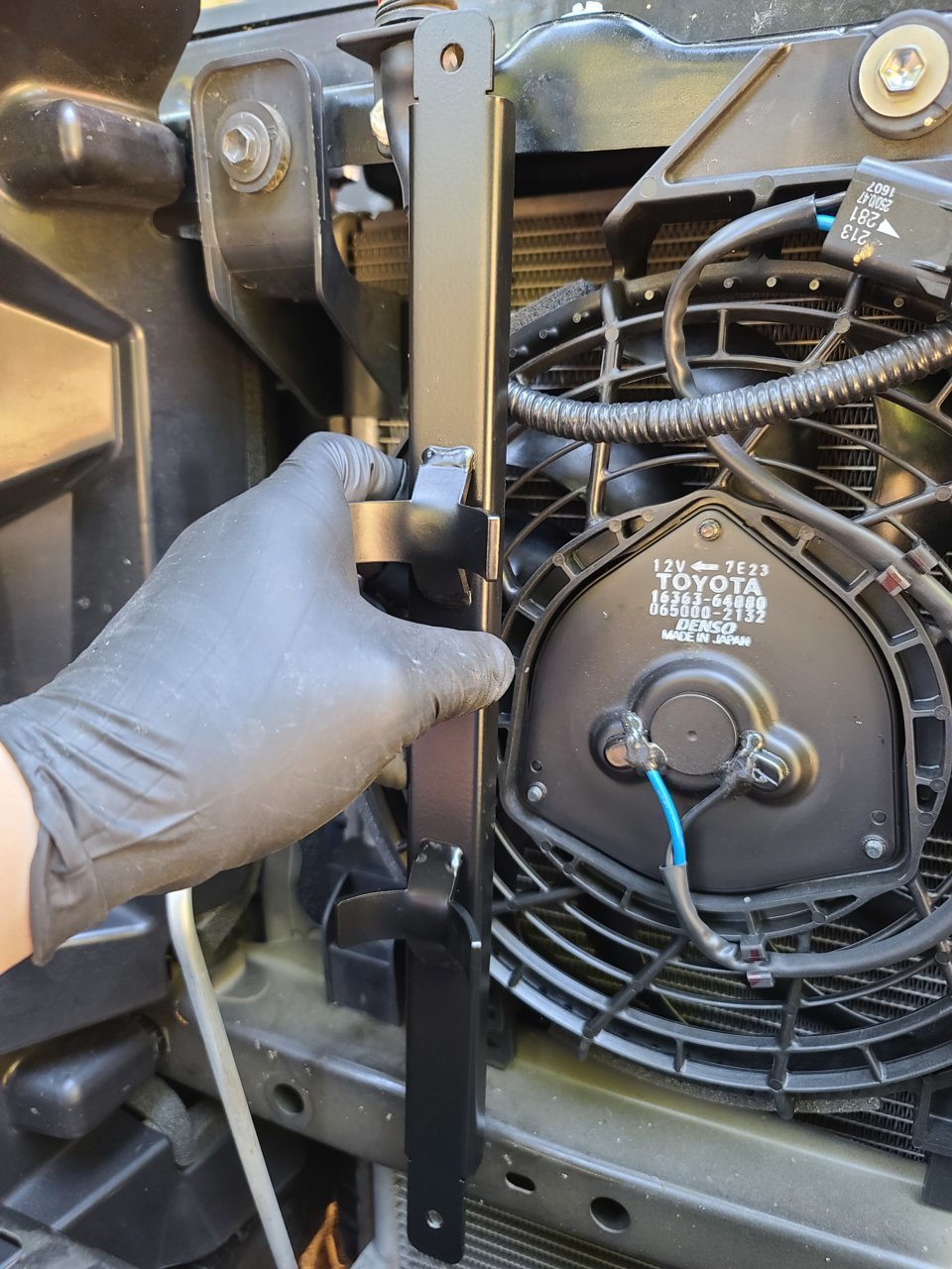

    Waiting on a reply from Harry, but have any of you had a problem fitting the bracket for the cooler on the Howe pump on a 3rd gen?
    Just got my Howe pump kit and the long black bracket seems too long.
    edited to add picture.
    edited to add:
    Due to my aux AC fan, I know I'll likely need to use some spacers on the top and bottom bolts.

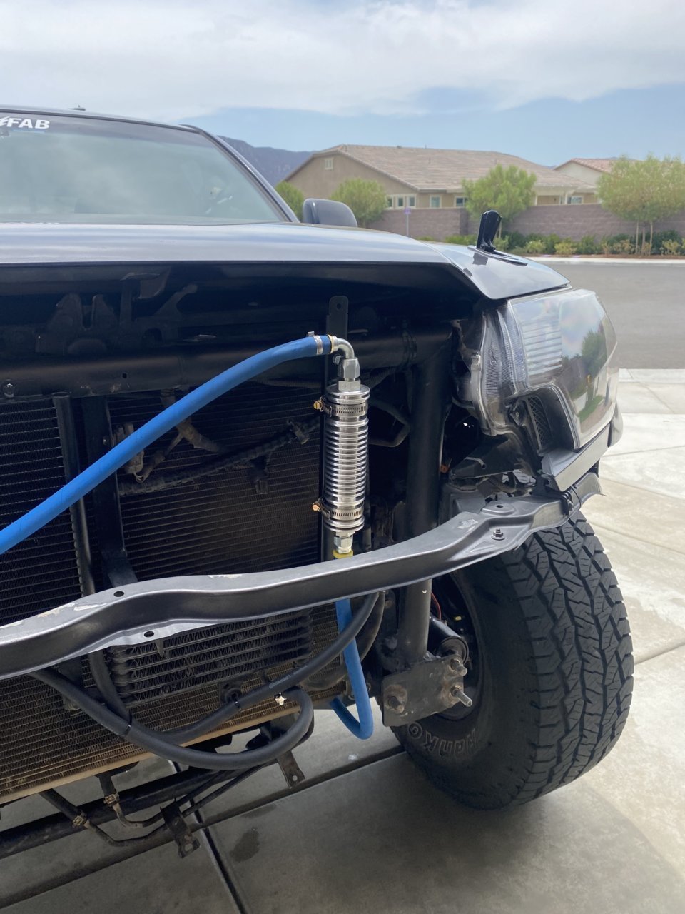

    https://www.tacomaworld.com/threads/airdogs-2012-prerunner-access-cab-slow-build.264263/
    Cmon…show a little ingenuity and find a place for it. Cut it. Drill it, do whatever it takes to mount it. You can put it anywhere upfront. That’s what I did. You don’t need Harry for this!

    The kit is not designed to work with an AUX fan, you are going to have to get creative.
    On another note, did you add that fan? I’ve never seen it before

    Hey, now! No stranger to ingenuity, but it's an expensive kit and a hell of a nice bracket! Wanted to check before cutting into it!
    Even without the fan the bracket lookes long--is this because once mounted it's not supposed to be 90 degrees? Noticed the top part of the radiator support is set back from the bottom support.
    It's a factory AC aux fan for the AC TSB. Added it myself because no dealership local would help.

    Fox 2.0
    Aux fan for AC on 3rd Gen. Came out as a TSB. For trucks in hot environments

    They all mount just about vertical, obviously with the fan in the way you will have to get creative and space the cooler out
