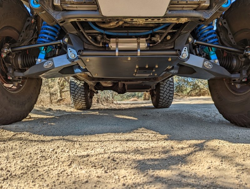

    Here's how I had mine mounted. Took minimal bracket modification.

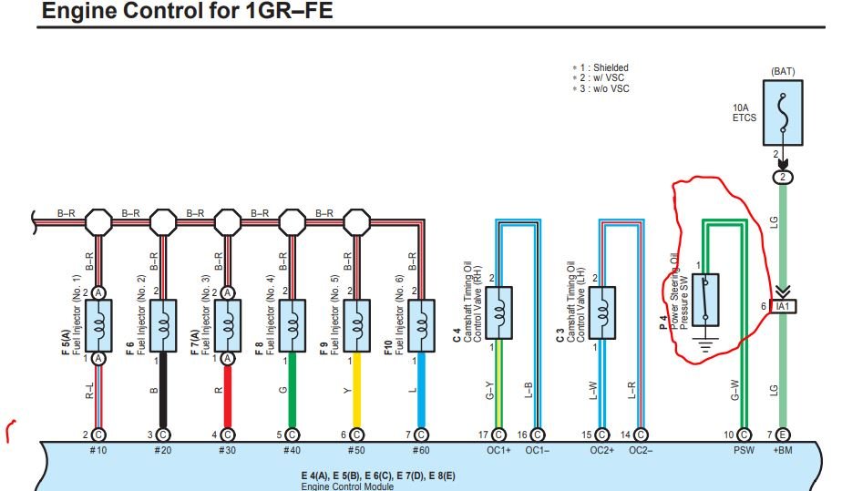

    Random question, does anyone have an OE power steering pressure switch they can measure the resistance of?
    I'm running the Howe pump but as I understand it from many who have gone this direction, I'm having idling issues. The truck idles so low that the power steering gets heavy unless you give gas. I understand one way to resolve this is to tune the ECU to bring the idle speed up a bit but I'm kind of wanting to experiment with something. When the Howe pump is installed, you remove the pressure switch that helps regulate the engine idle, especially when at full lock. The pressure switch will regulate the voltage to the ECU according to the amount of pressure that the system is under. I went through the trouble of grounding the pressure switch wire to the engine block in hopes to help with engine idle with no resolve. I'm assuming it's because there's no resistance within the circuit so the ECU isn't adjusting idle speed.
    I'm curious to know what the sensor's resistance range is. I'm thinking that if I add a resistor within this circuit I can trick the ECU to up the engine idle. Thoughts? Anyone want to contribute to this experiment?

    It's a ground side switch/circuit, attach the lead permanently to the frame. That tricks the PCM into thinking the pressure switch is "on". RPM's will always be at the raised or higher state at idle. Which would be ideal anyways when on the trail and going slow/crawling over small children and pets.
    The sensor is just a spring and plunger/contactor inside the body, nothing to measure with a DMM

    It’s just a ground switch. Ground closes when pressure drops and opens when it rises. PCM detects the open and closure. Maybe you have a wiring issue or maybe even a pcm drive. Who knows.

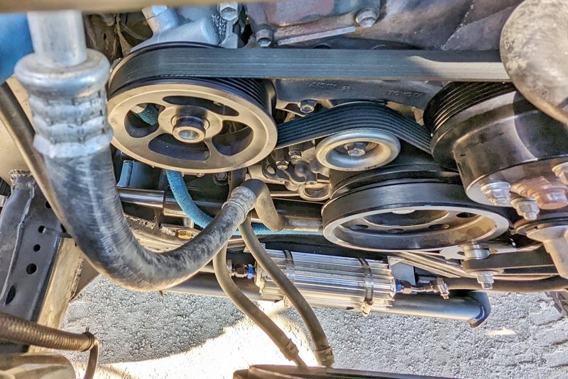

    Per Howe, keep your lines short and direct to rack.
