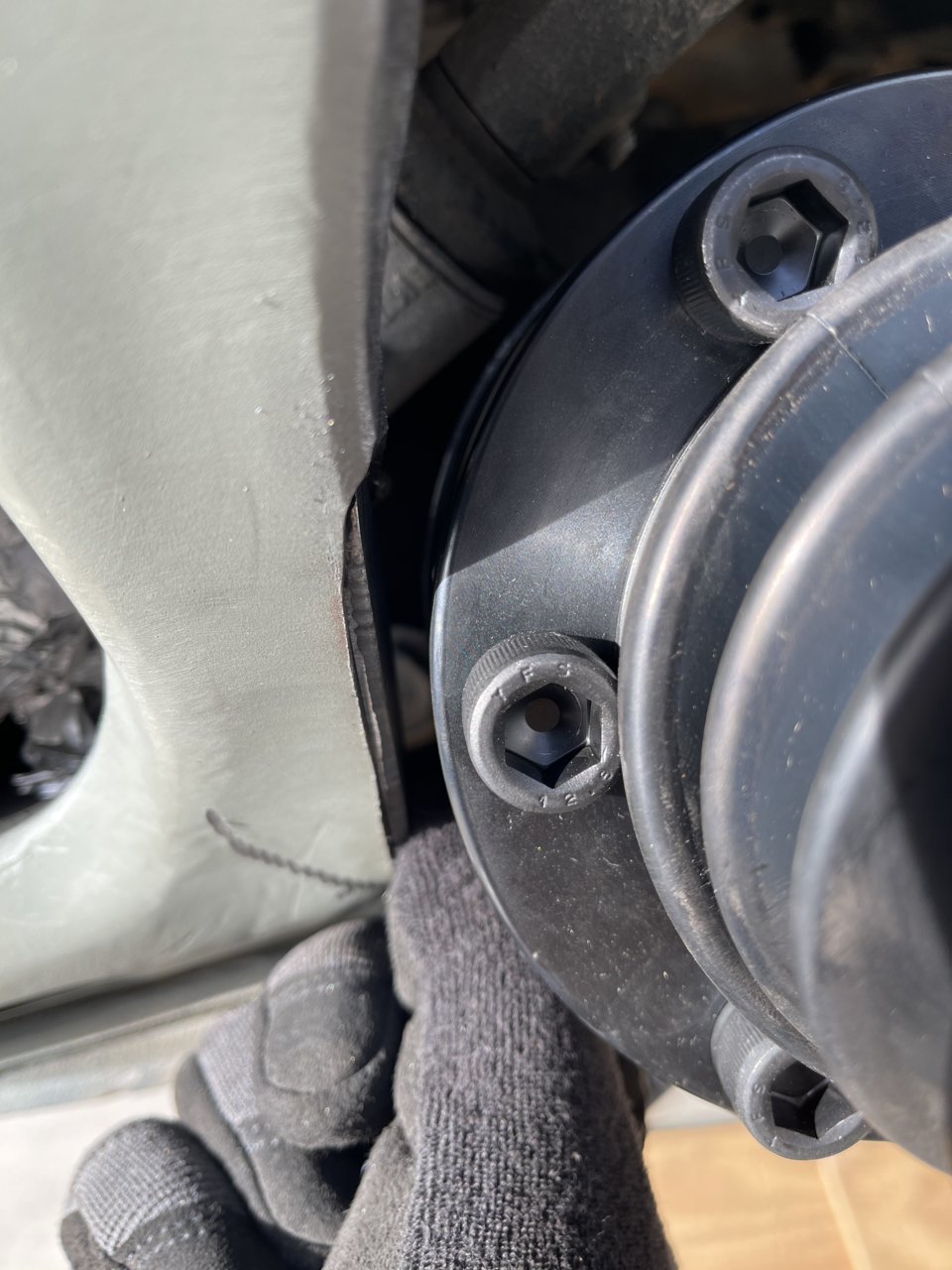

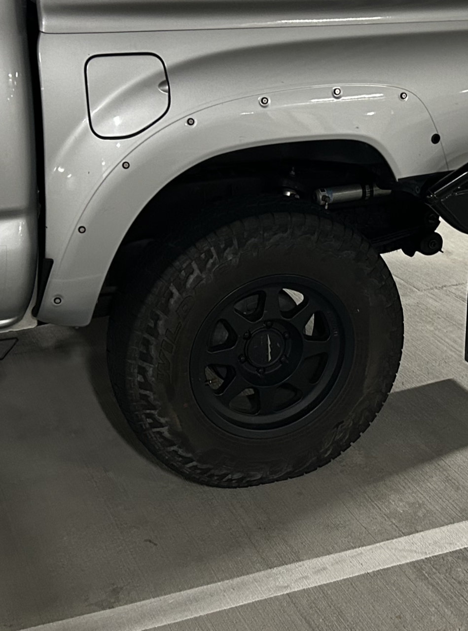

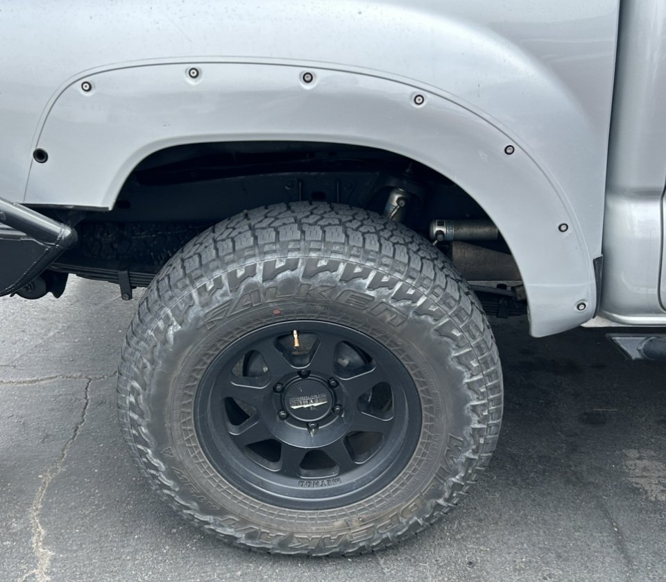

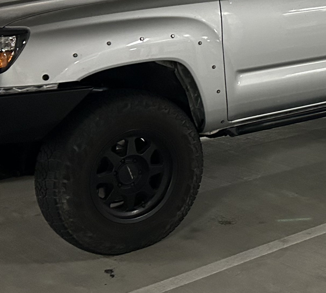

    rear:
    -Icon RXT max height
    -Archive HH and yellow bumpstops (haven’t installed yet)
    -Bilstein 5160
    I don’t know if trimming fenders to match would be even, given they’re cut at different height from factory resulting in different FTG measurements.
    Not only is stock suspension forward rake, I believe the stock fenders/bedsides are shaped/cut in a way that has forward rake in them too, even if you lift or level the suspension.
    I have seen people trim 2.5” front, 1” rear, that despite taking more off in the front, makes the truck look level/the same and even between front and rear fenders.
    I’ll research it more to see what people are doing. I think if I say screw it hit a trail and then under compression the rear hits the bedside inner fender it will probably FUBAR it. it could just need an inch taken off.
    Plus it looks goofy without any cut, and the rounded edge prevents being able to run a nice looking edge trim.
    I’d guess it needs at least 1” taken off
    Could be worth the PITA of doing the cut to start at 1” and re evaluate
    Have to tape it, measure/mark, get a jigsaw, cut, paint, make a racket outsideIMG_6616.jpgIMG_6615.jpgIMG_6614.jpg

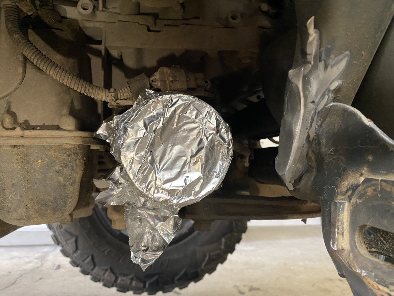

    I didn’t realize you had a gen2, much different body lines than my gen3. I would then measure how much uptravel you have either between the frame and bump stop or the amount of shock shaft you have left (whichever is smaller) and reassess from there. With my setup I have about 8.5” uptravel to my bump stop. That’s how I figured I would need to cut the most of the fender. My rear inner fender no longer exists because it’d end up getting ripped out from the tire.

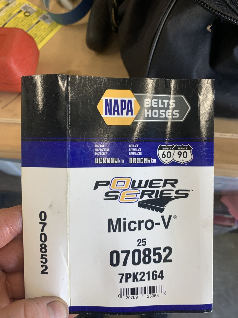

    This is the belt supplied in my Howe kit for a 4.0 2nd gen.

    2164 is the length in mm, so many belts in that length range will probably work... 2160, 2165, 2170.
    The Honda number for the belt is 56992RNAA03 which is a 7PK2170. Bando has one for under $15.

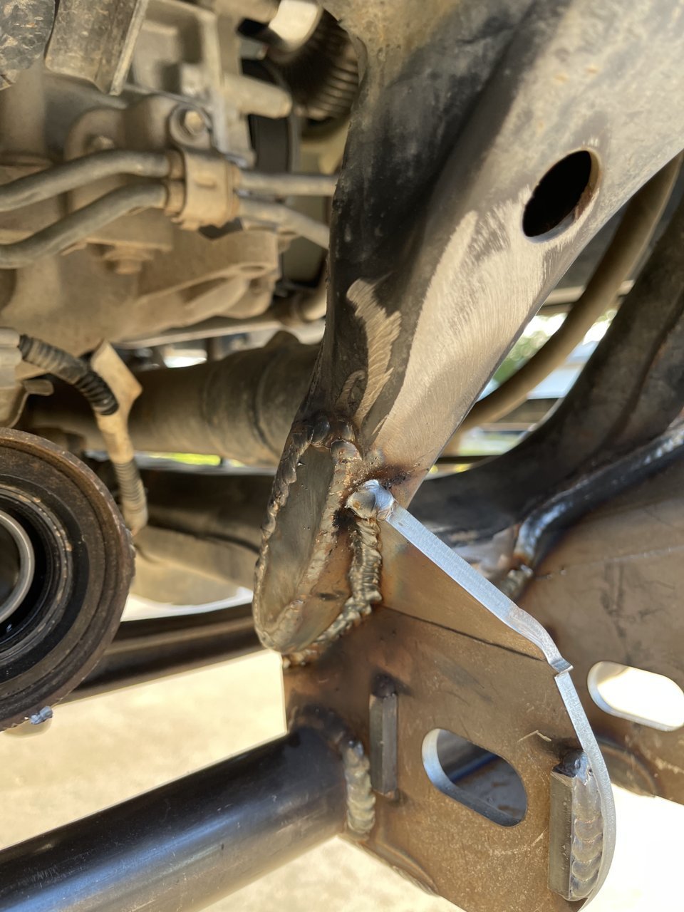

    Make sure to check the pump mounting. When JD did mine there was a crack developing. If I remember correctly, it is the tab that comes off the timing chain cover. They welded it up for me and I know there was some talk about an additional support bracket being developed.

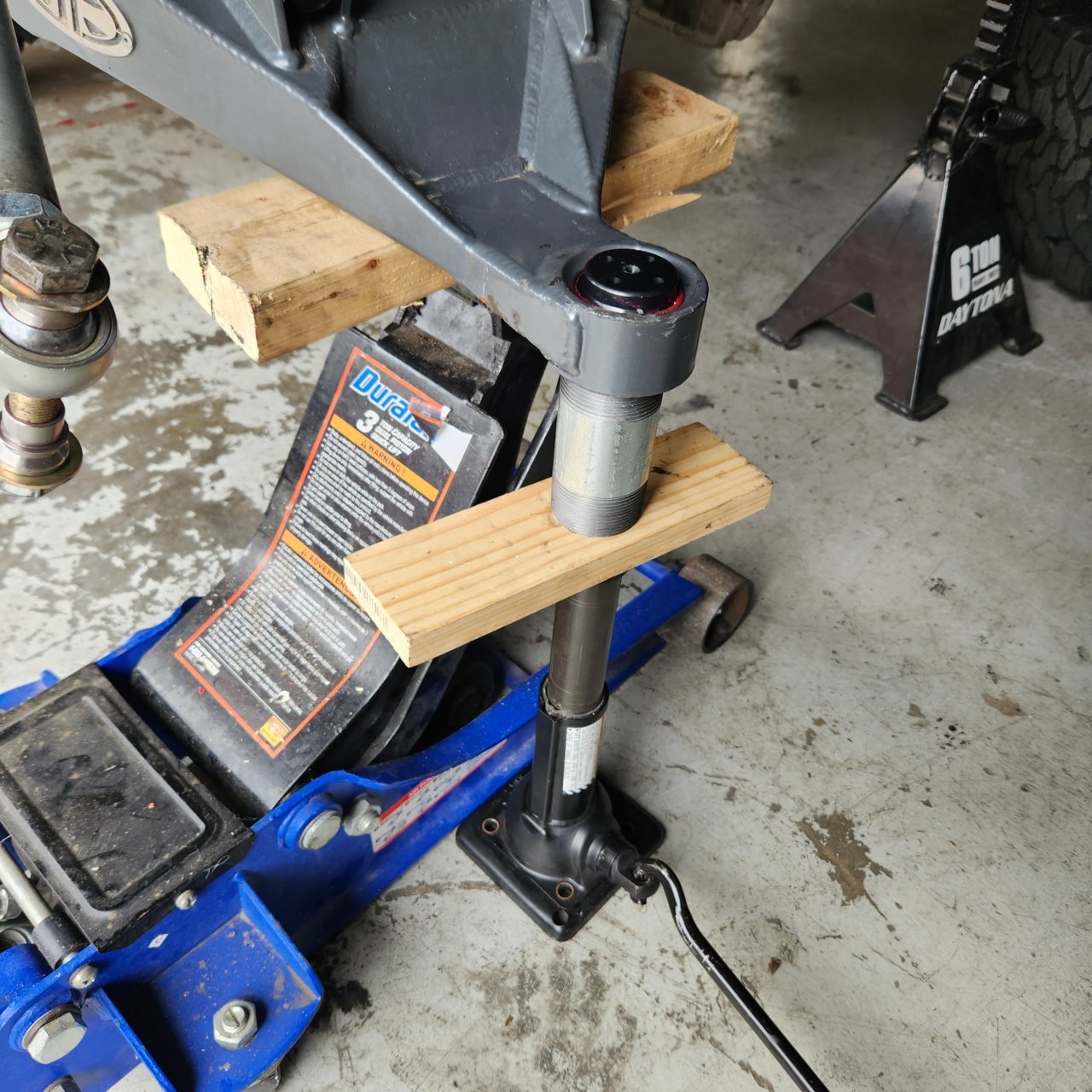

    Redneck balljoint replacement with the arms left on the truck. Worked perfectly. Big jack lifted the arm so the cup was parallel to bottle jack

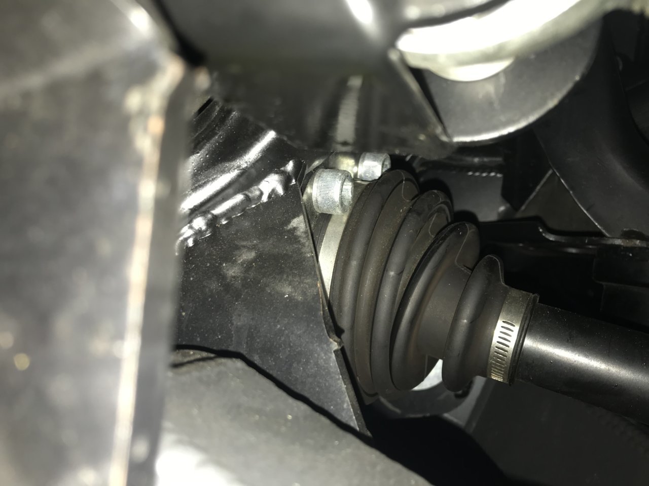

    Could the inner boots on 934’s be slid down if the hose clamp was loosened?
    Im guessing thers a groove or something like oe shafts. I vaguely remember cutting off the stock clamps and re hose clamping on my old setup and didnt have any issues. Whether right or wrong
