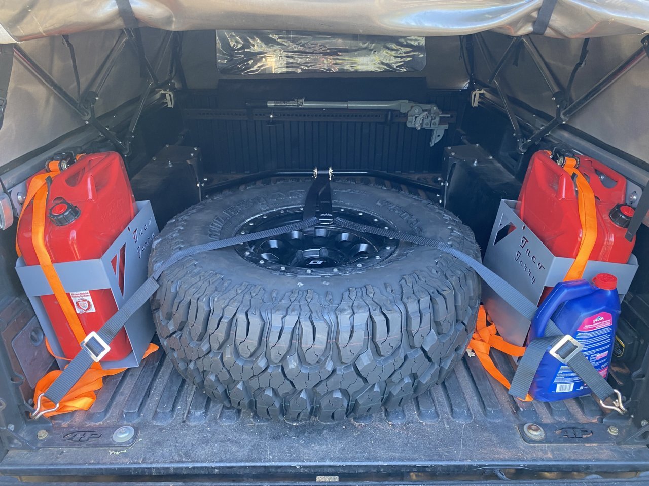

    They still do. Had them make an add a leaf for my regular duty h70 pack earlier this year. Way better now as I run a snug top shell, 37” spare setup, pro eagle jack, and a bunch of fluids/ tools in the bed pretty much full time.
