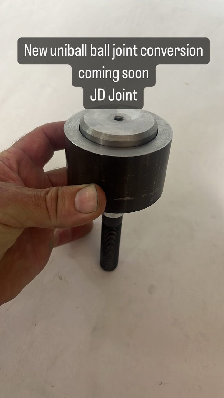

    I know it's been awhile, but I'm not quite sure when exactly it happened, I don't recall hearing much of a noise, I just noticed I was being limited turning to the left, at the time I figured it was just from the steering rack binding on the coils, but then I took a look. Hours after I posted that picture JDfab called me and sent me out a new joint. Can't really say enough about their customer service. I got the new joint in and have been fine since. I did see something quite interesting on Instagram this morning though... looks like these would be a nice upgrade.

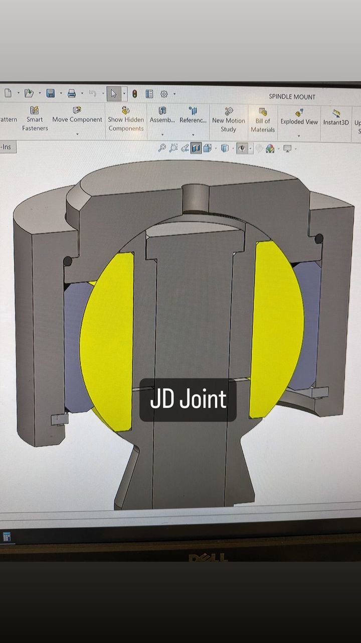

    We basically built a MUCH stronger version of the EMF. It uses an HD WSS 1” Uniball inside of a completely custom, machined housing with a sealed top cap.

    Just curious but could those joints be adapted to most any 1inch uniball cup or do they need special cups?

    No, the cups are custom machined to accept the Uniball/custom cap. The cap is sandwiched between the Uniball and cup so it’s impossible for it to fail, even if you blew the uniball apart it can’t physically go anywhere.

    Cool story. 3 weekends ago I developed a nasty clunk about 40 miles out. Nothing jumped out at me. Until I got it in the shop and started looking.
    My left lower EMF cap was turning while steering the truck. It was about 3 turns out from snug.
    I know for a FACT I tightened the lock screws at the last adjustment. Yet somehow that cap came loose and damn near blew out.
    I’m sooooo over these EMF’s at this point. Weekly adjustments and one close to a total failure. I grease religiously with high end grease, I wipe the dirt and grime off of the ball every time I grease them, yet they just don’t hold up.
    Happy to see an improvement coming out.
    Hopefully, we can buy kits without the top cap for us current style kit guys.

    We are currently having standard Uniball conversions machined that will drop right in all existing kits and will be sending them out to every customer that isn’t happy with their EMF’s. The new JD joint will only work on new kits moving forward
