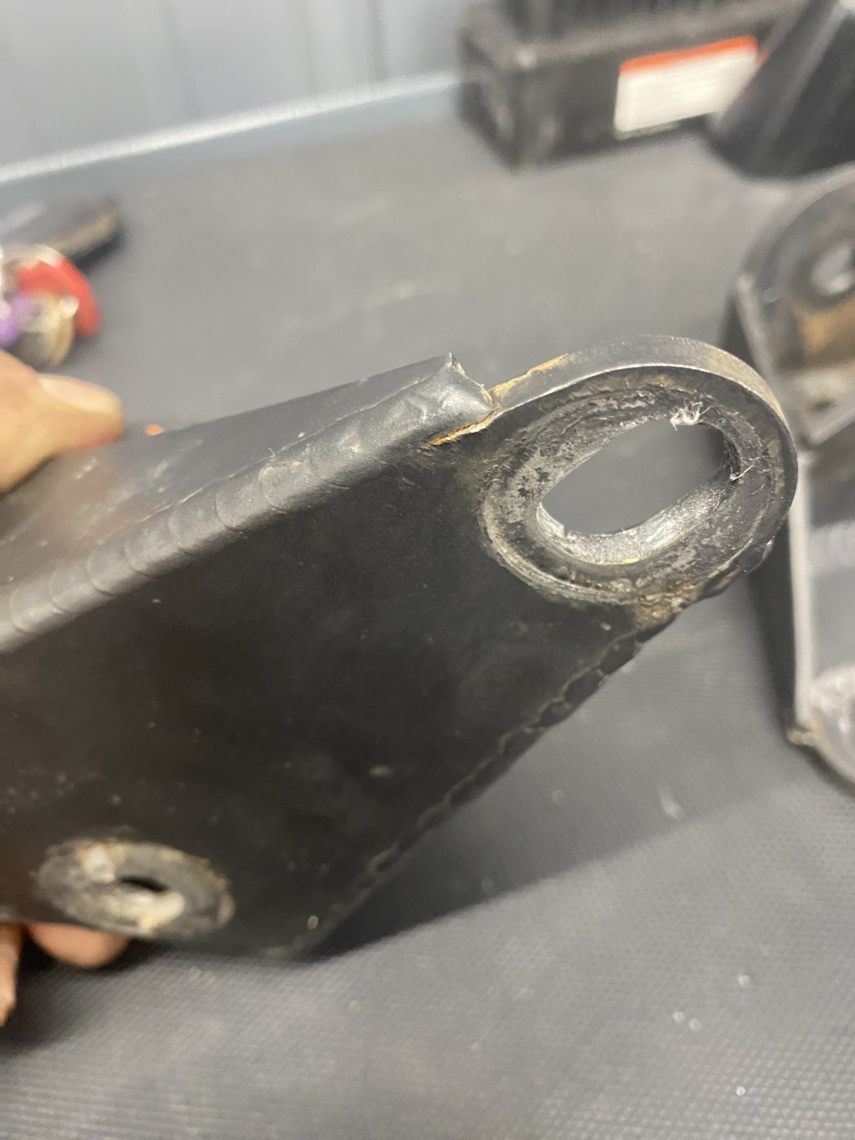

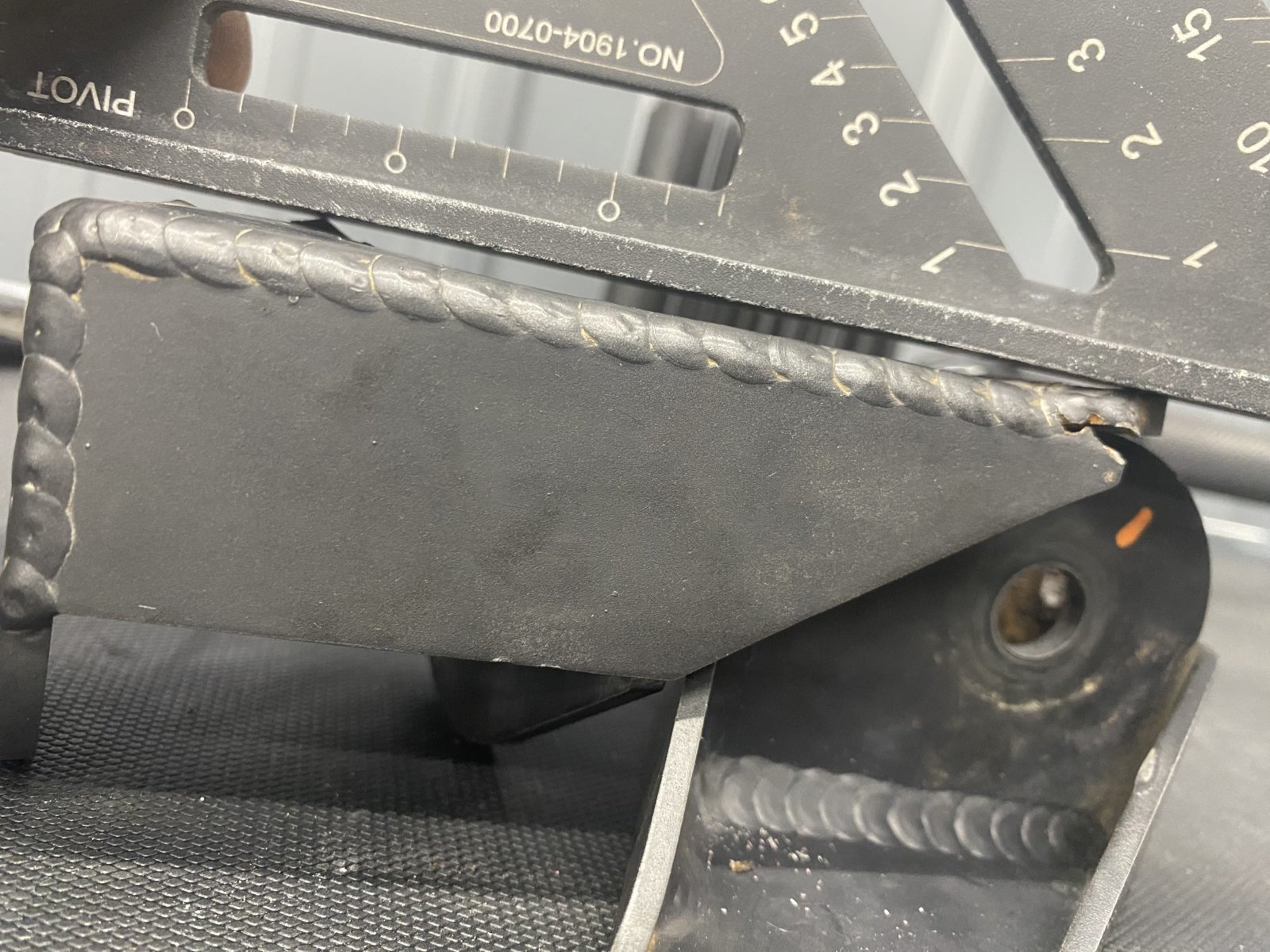

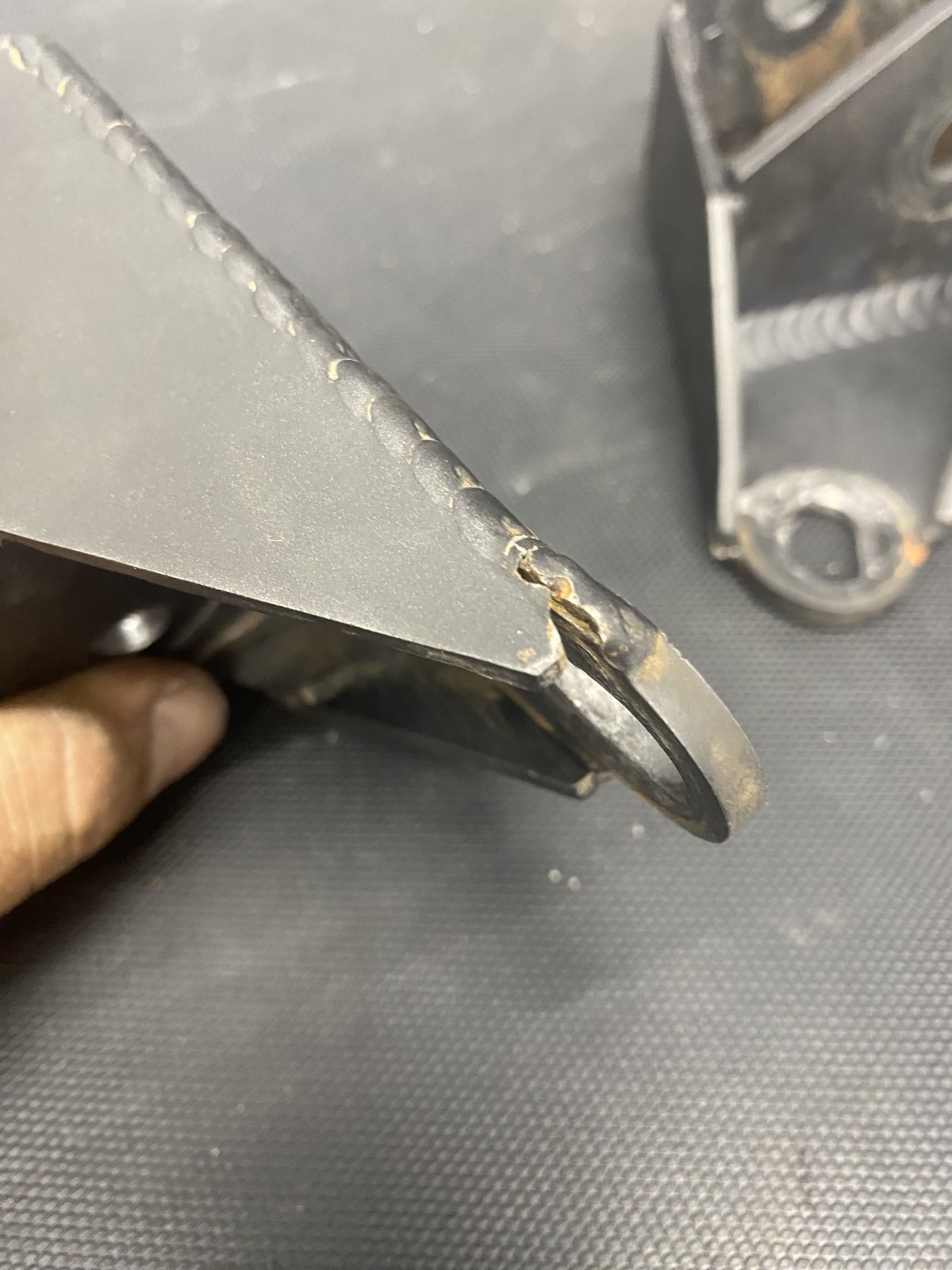

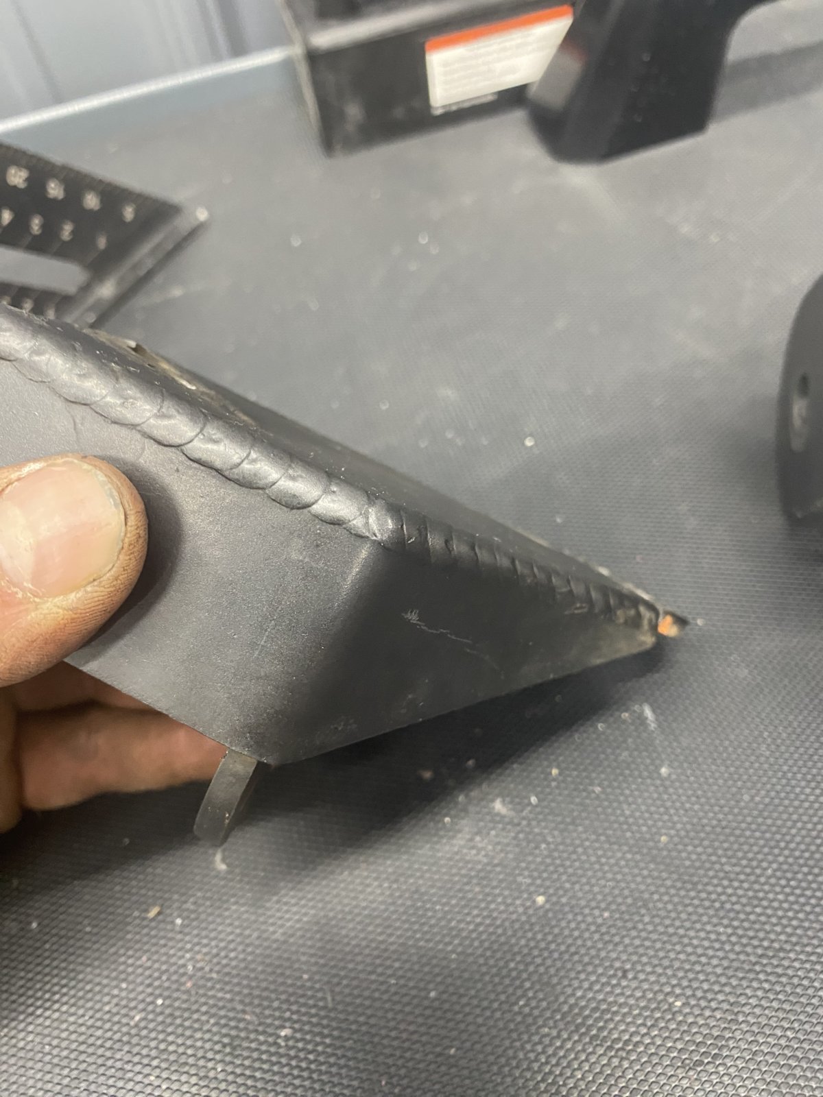

    Guys with a slide rack. Pay extra close attention to your clevis’s for cracking. I had a scary incident on our last time out. Needless to say both clevis’s cracked and bent pretty severely.
    This locked up my steering to the point I only had 1/4 turn each direction. Blew a corner at near 70mph, blew up a wood post with my front bumper and luckily had a BBK to get my ass stopped before the tree line.
    I’m guilty for not looking these over often.
    All bolts were still torqued and paint marks still in check.
    I am however sure 37’s played a big part in this.

    All those little buttholes in the center of the weld is a tell tale sign of tack and go welding. Not good.

    Definitely not, I personally weld the stuff and have NEVER tac welded anything in my life

    This just keeps proving my point that if you actually want to off road your truck with big tires racks are a complete waste of time. The only real solution is a steering box with a ram
