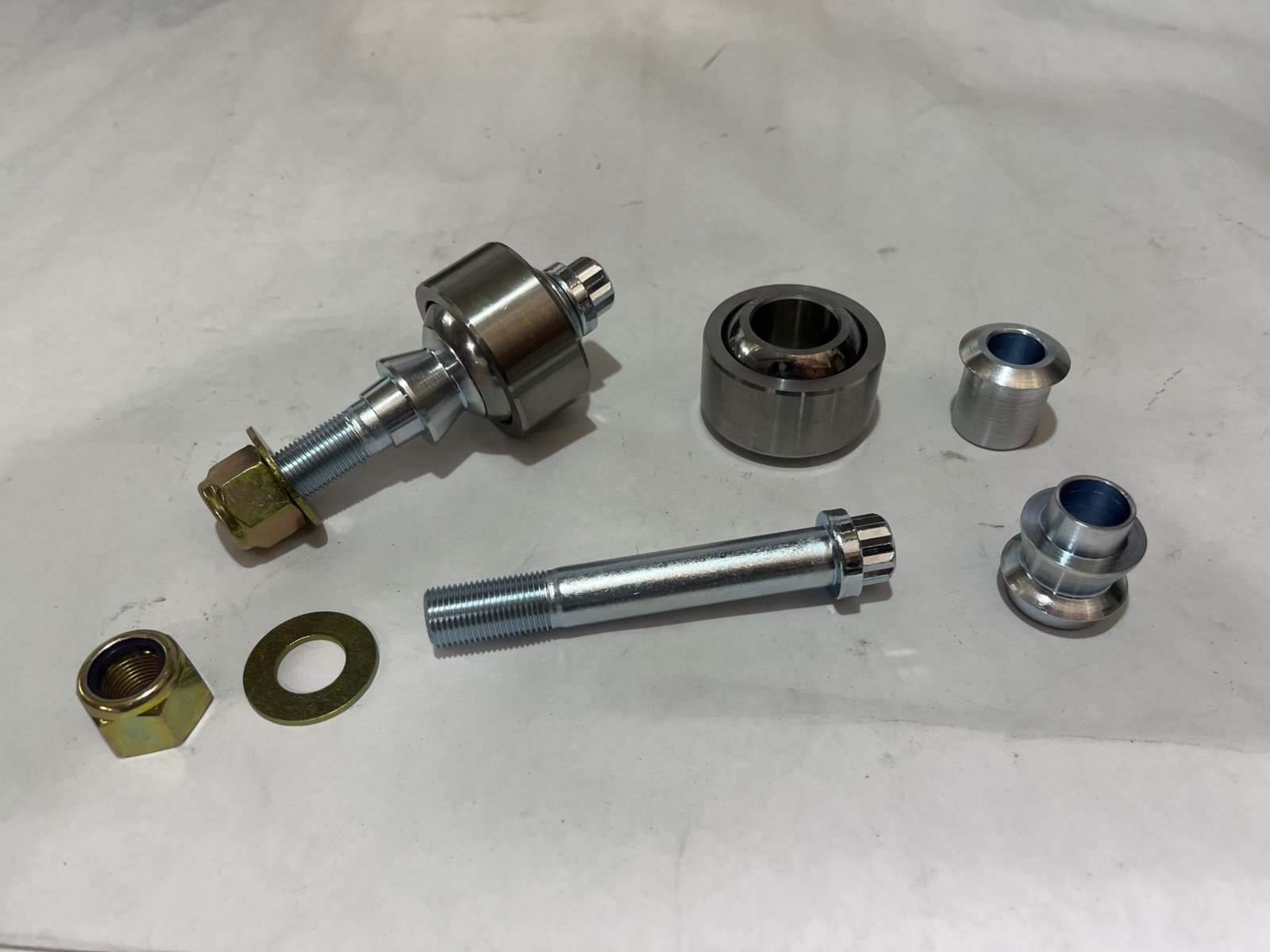

    Just a heads up guys the Uniball conversion kits are done for those wanting to upgrade. Please email jesse@jdfabrication with your original order number and we will get yours mailed out. Also please do not DM, text or call me about these… you must email so we can keep track of everything. Thanks!

    Definitely not cheap but standing behind our products and keeping customers happy is most important. We also learned a lot and it forced us to innovate… we now have the JD Joints on all new kits which is IMO the most bad ass joint ever… stronger than a Uniball and sealed like a ball joint

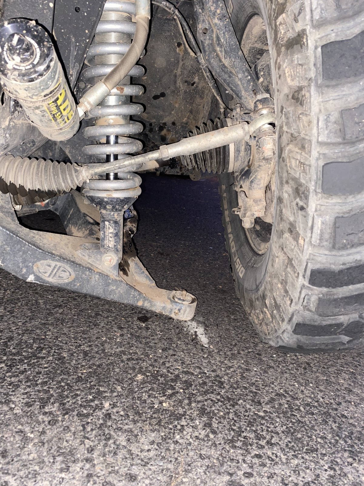

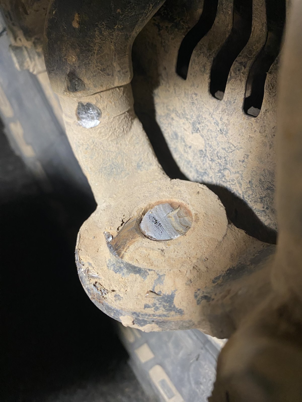

  11. Dec 13, 2023 at 5:34 PM
    EatSleepTacos
    Mar 24, 2015
    #151688
    59,844
    Randy
    West Valley, AZ
    2017 4Runner
    What in the world. How?! I thought the second/third ball joint design was to prevent this.
    Slashaar likes this.
  12. Dec 13, 2023 at 5:55 PM
    Sixthelement
    Sixthelement Ran over a Yeti once, Texas, never again
    Apr 1, 2017
    #215083
    2,805
    Flagstaff
    24 F150
    Fox 2.0
    The shaft sheared.
    Slashaar and Ricardo13x like this.

  14. Dec 13, 2023 at 5:57 PM
    Sixthelement
    Apr 1, 2017
    #215083
    2,805
    Flagstaff
    24 F150
    Fox 2.0
  15. Dec 13, 2023 at 6:18 PM
    EatSleepTacos
    Mar 24, 2015
    #151688
    59,844
    Randy
    West Valley, AZ
    2017 4Runner
    I’m honestly impressed. Hopefully you and the truck are ok.

    Evenflow
    Evenflow Well-Known Member
    Jul 15, 2013
    #108344
    5,766
    Jason
    San Diego, CA
    06' DCSB 4x4
    Yes
    Jeez how did it happen ? Looks like your rack is bleeding and the inner cv separated too ?

    Sixthelement
    Apr 1, 2017
    #215083
    2,805
    Flagstaff
    24 F150
    Fox 2.0
    Pulled up went to back into parking spot to pick up oldest go to his friends event at the high school.
    I texted @snowsk8air2 and while he was grabbing my jack stands from his house. I got it up on my offroad jack and we were able to get it into the spot. Tire is off. Its on stands and safe now.
    yea, rack definitely weeping. I do have a BasikBiker rack to go in. yea the inner part of the cv pulled but that'll be easy to pop back in. Them hose clamps held like a champ on the boot.
    I got the email Monday that Jesse was sending out the parts. Hopefully they get here quick. If no surprises. Should be ok to swap there then can get to the shop to swap rest and go over everything again.
    We just went over all this in late August too. Other than one overland trip along the GC rim that was very chill and two short camp trips. Its been all just DD to work and back. 10miles a day stuff.

    SoCal
    MGM 2011 DCLB 4X4 Long Travel'd
    Whole lotta stuff
    Whoa. Was that with the EMF joint? That’s straight up dangerous. Having serious doubts about the materials used in the joint now in addition to premature wear.
    Edit: hope nothing happens to me on my way to work in 30 mins…
  20. Dec 13, 2023 at 6:45 PM
    Sixthelement
    Apr 1, 2017
    #215083
    2,805
    Flagstaff
    24 F150
    Fox 2.0
    At least the new style Uniballs are more traditional and easier to inspect and check. Verus these. You can see at some point it cracked. but where it cracked unless your pulling it to NDI the joint probably never going to see it.
