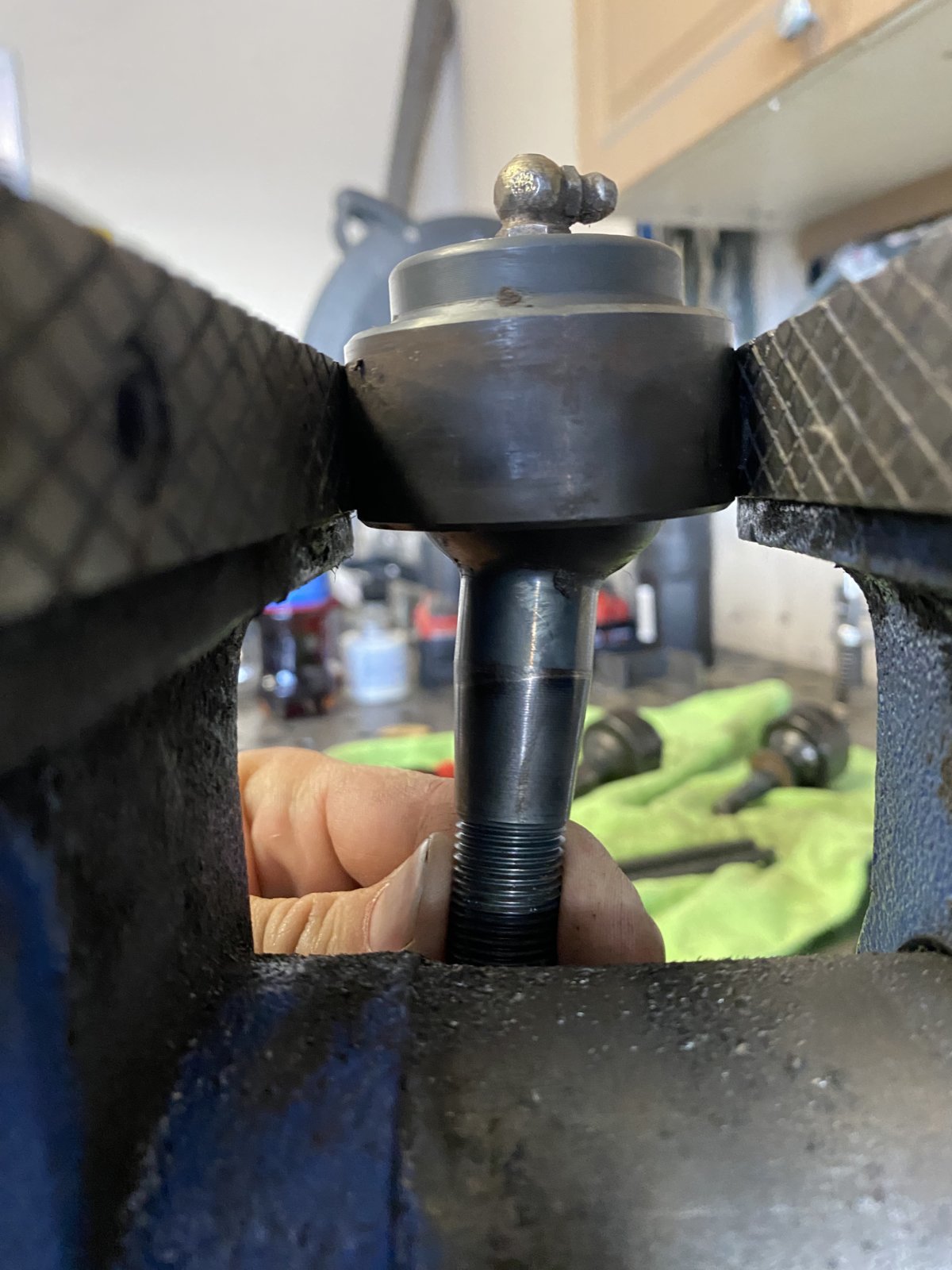

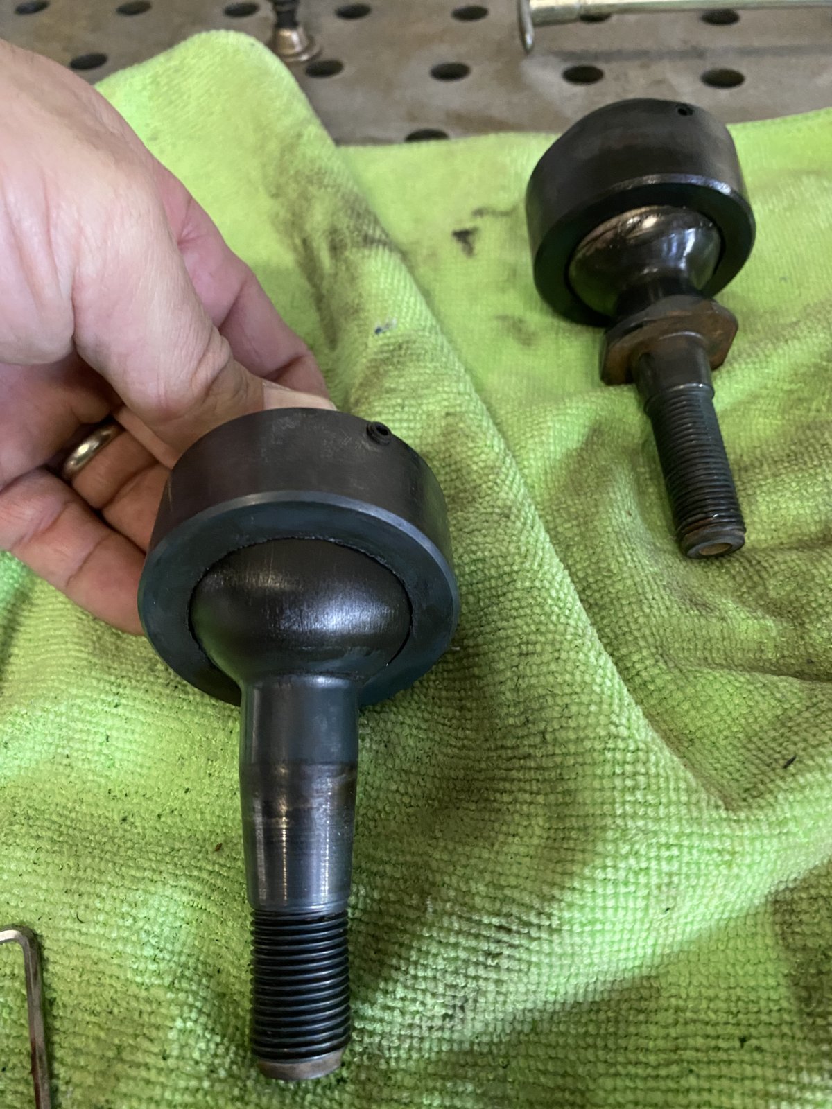

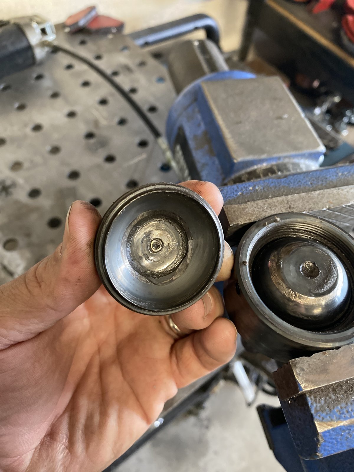

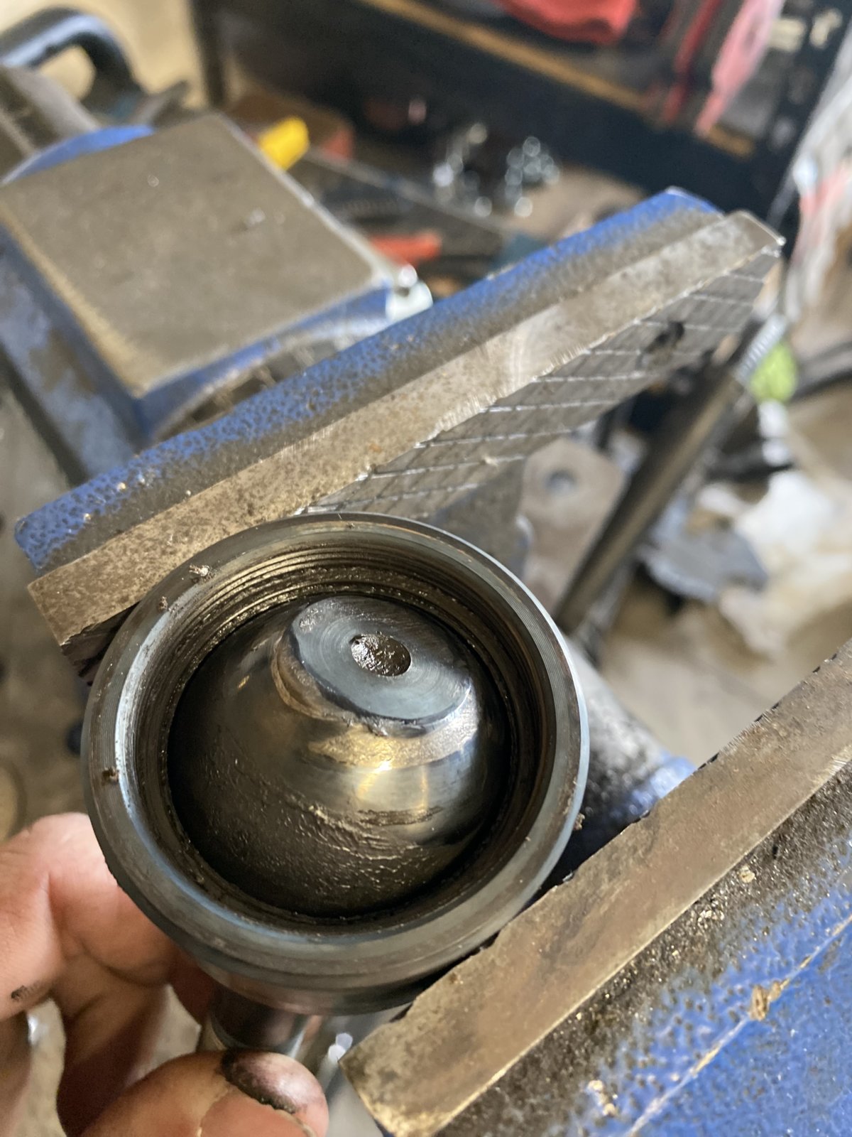

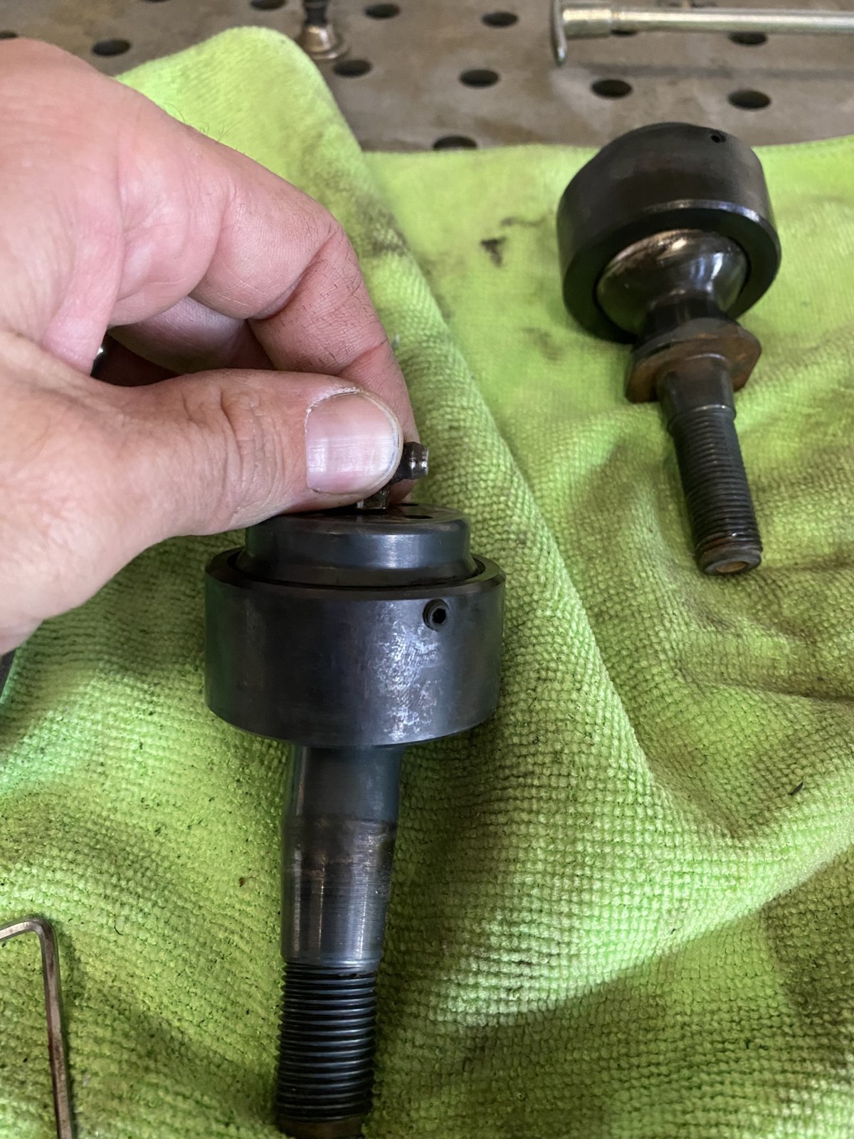

    These are from when we pulled them in Aug 1-3rd
    upload_2023-12-14_10-35-14.jpgupload_2023-12-14_10-35-14.jpgupload_2023-12-14_10-35-15.jpg

    Kinda looks like the cup had been hitting the shaft in that first pic, creating a shearing force, but maybe that is just a grease mark.

    You can’t get enough uptravel or droop to metal to metal the lower joint.

    Gotcha, maybe just from when they were off the truck then.

    Grease on them. When we took em out then greased them again on install.
    As my issue was with the top cap and it wearing into the ball part of it.
